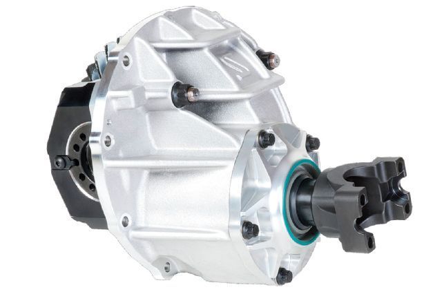

I'm looking to order a Ford 9" 3rd member for my project, and I'm looking any advice/suggestions before I make my choice...
I looked at Currie, Moser, and Strange's websites this week, and they all appear to be roughly in the same ballpark price-wise. THe rough configuration that I'm planning to go with is:
  • Nodular Case
  • 3.89 gearset
  • TrueTrac Carrier
  • 1350 Yoke
  • 31-spline axles
I've thought about an aluminum case, but opinions seem mixed on whether that's a good idea for extended road use. This is a place where I'm looking for advice.
Another place I'm curious about is the pinion support. Some offer an aluminum one, which I likely wouldn't choose.
For cases, there are multiple options from each manufacturer. I'm not planning on much (any) drag racing, and I'll 'only' be making around 600HP.
What else do I need to consider?
And any particularly good or bad experiences with these manufacturers?
Finally, am I best off to just order directly from these manufacturers on these, or should I be talking to a vendor?
Appreciate any insight...

carbuff 02-05-2013 07:37 AM
I did... I went with Strange. I got their case and the TruTrac with the 3.89's, and I purchased directly from Strange.

carbuff 04-26-2015 08:07 AM
I have about 6000 miles on it now. I like the TrueTrac, and I'm still debating my gear ratio selection. As for the noise, yes, there is some. I took the chunk out and had a local shop go through it to check the gear alignment, and they did reset it. The noise is less now than it was, but I do still get a little now and then at highway speeds.
I don't know whose gear set they use. I probably did at one point, but no idea now.
Overall I'm happy. If there were no gear noise, I'd been happier, but I have enough other noise that I don't tend to notice it much...
