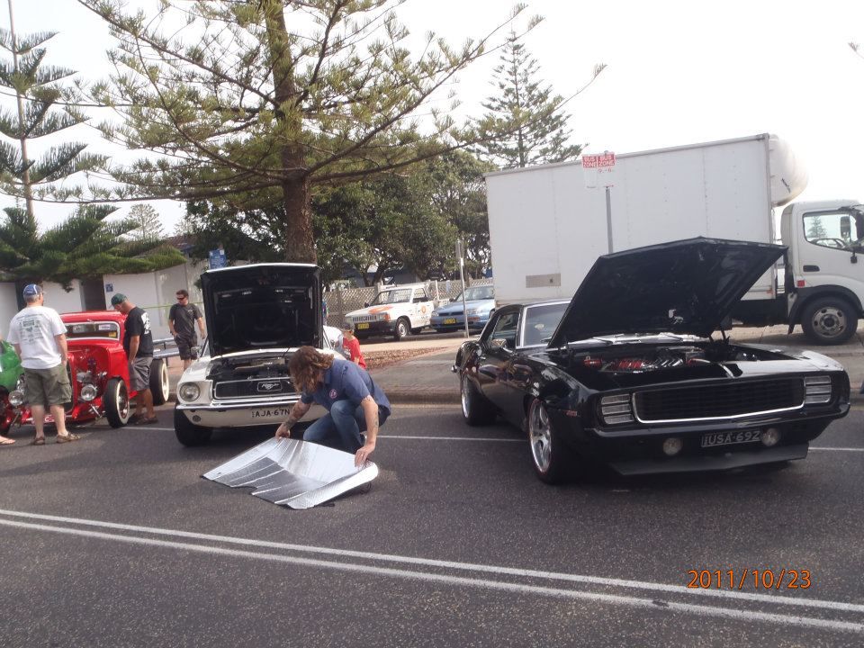

maybe you can post up a pic of how the car is currently sitting to give us an idea of where you would like to end up?
usa-69z 01-10-2013 03:30 PM
heres where im at now,, this is before the vaporworx tank etc
http://i221.photobucket.com/albums/d...feb2010014.jpg
http://i221.photobucket.com/albums/d...25884967_n.jpg
marolf101x 01-10-2013 05:56 PM
Looks a lot like the red 69 to me.
You can lower the ride height of our AirBar by adjusting the coil spring down, but you will loose a little compression stroke (which is the most important as it is what keeps the car off the bumpstops).
By the looks of it you'll have no issue getting back to the ride height you have now.
