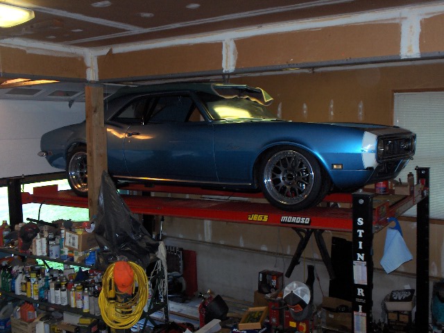

My garage measures 9 ft 8in and I have three lifts in it. I have a 98/02 Camaro on/under one lift. 64 chevelle/68 Camaro on/under another and a 68/69 Camaro on/under another. They fit perfect for storage but not quite enough room to raise it high enough to comfortably work under. Also, my garage is deep enough so the doors won't hit the cars on top but even if it wasn't the doors would still clear if I had the cars parked facing the doors. The doors would just go over the hoods. 9ft would work if the cars overall height were low enough but would be real tight

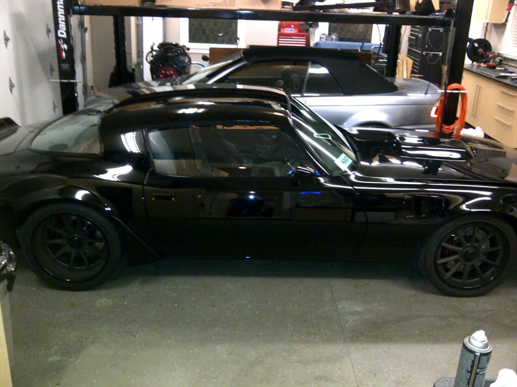

John, I have a four post lift in my garage, and have a low ceiling. Give me a holler whenever you want to come by and check it out. In my case I have a low garage like yours and able to stack two firebird\camaros :D Being able to store the car inside, plus a great way to be able to safely work on the car when lifted is awesome!
For the garage door, you will need to modify your tracks, what was pretty straight forward and I did myself, just a bit time consuming. What I did was cut the ends of the horizontal track (the track the door goes when it is fully open), and add that to the vertical. You will need to remove your current motor and track (takes 15 minutes) and go with a side mount motor - I used a Liftmaster, and itrocks, coms with sensors, plus ads an internal lock to the garage, motion sensor light, etc.
I was quoted a small fortune on doing the garage door and track swap, so did it on my own, not the prettiest but works perfectly. There are a couple companis that actually will sell the new track setup for you (wish I had done that to start with), what will make life easier.
Sorry only have this crappy phone pic handy.
http://img.photobucket.com/albums/v2...d/guistand.jpg
There is a lot of space, and in my case in order to store two cars, my top car (i.e. bird por camaro) has to be parked facing forward. The door will open very close to the ceiling, and has plenty of space to clar the hood and windshield. My lift is as close as possible to the door. If you put your lift all the way to the back of your garage will be even easier. BTW most ligt come with removable dollies and moving thema around the garage whenever you need is a one person job, very sweet! as far as bolting to the ground, as we live in Quake country all of the sources I inquired mentioned it is better to have the lift unbolted to allow for some wiggle room. Once a car is on top that thing does not move :) I wanted everything as safe as possible in teh acse i.e. my little ones wonder in teh garage etc.
I did a LOT of research, and the best 4 and safest 4 post lift for the money in my opinion is the DirectLift setup. I have a great local connection if you want, and he has a warehouse in Hayward, has excellent customer ervice and he displays at the Good Guys (I met him at the Pleasanton Good Guys). He even a person available for delivery and setup if you want to. I put mine together myself, and help from my buddy as the track with the RAM weighs a lot (yes you can do it with a dolly or Cherry picker); it is a full 8 hour day project but worth it if you want to learn the ins and outs of the setup. A lt of peopl reocmend Backyard Buddy lift, but I compared both and teh Direct Lift has a best fail prooof mechanism (secondary locks, tension locks - i.e. your cable brakes, lock actuates, etc).
You know where I live, so feel free to give me a holler if you want to come by. Warning, my garage is currently an EPIC mess!
Gui

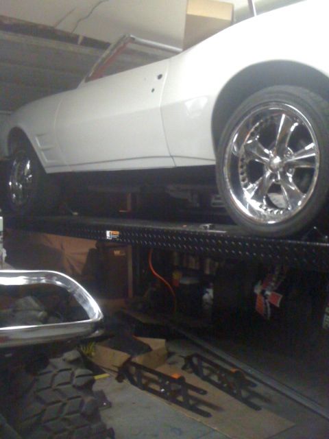

When we purchased our house it was just dumb luck that the garage had a 12' ceiling. Shortly after moving in, I purchased a 4 post lift and simply stored the Camaro on it for many years before starting my PT build. My lift is not anchored and in fact Stinger sells a wheel kit that will actually allow you to move the lift around. I can tell you that there is no way I could have built Dust Off alone without this lift! It was the best investment I have ever made in shop tools. A lift with a 9' ceiling will not be suitable for working under the car unless you can come up will some method of working in a 4' or 5' overhead. My neighbor liked my lift and decided he wanted one in his garage but he only had 9' clearance. He went in and modifed his roof trusses to allow him to raise the car up into the attic space of his garage. As for earthquakes, we had a 7 magnitude quake here is VA a couple of years ago and the car and lift moved about an inch but suffered no damage of any kind. That same quake did crack my basement walls however. For the garage door, I modified the track to raise the door up close to the ceiling and changed the spring and cable system to a torsion spring opener.
http://hayes-ent.com/steve/images/Ca...MARO%20048.jpg

My garage is a MAJOR mess with the vert all apart but gives you an idea on fitment. With yur car being lowered you will actually have more room.
http://img.photobucket.com/albums/v2...psb67a77ec.jpg
http://img.photobucket.com/albums/v2...psd058c3dd.jpg
http://img.photobucket.com/albums/v2...pse1aea4e2.jpg
