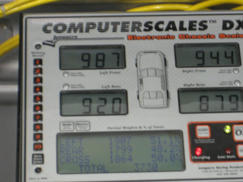

Here's my old car on the scales with dead nuts cross weight and me in the car. Notice the left side vs. right side weight. Very similar to your car. You just need some work on the cross weight. From my fuzzy memory, your RF spring needs a few turns UP. :relax:
http://i200.photobucket.com/albums/a...1969/029-1.jpg
