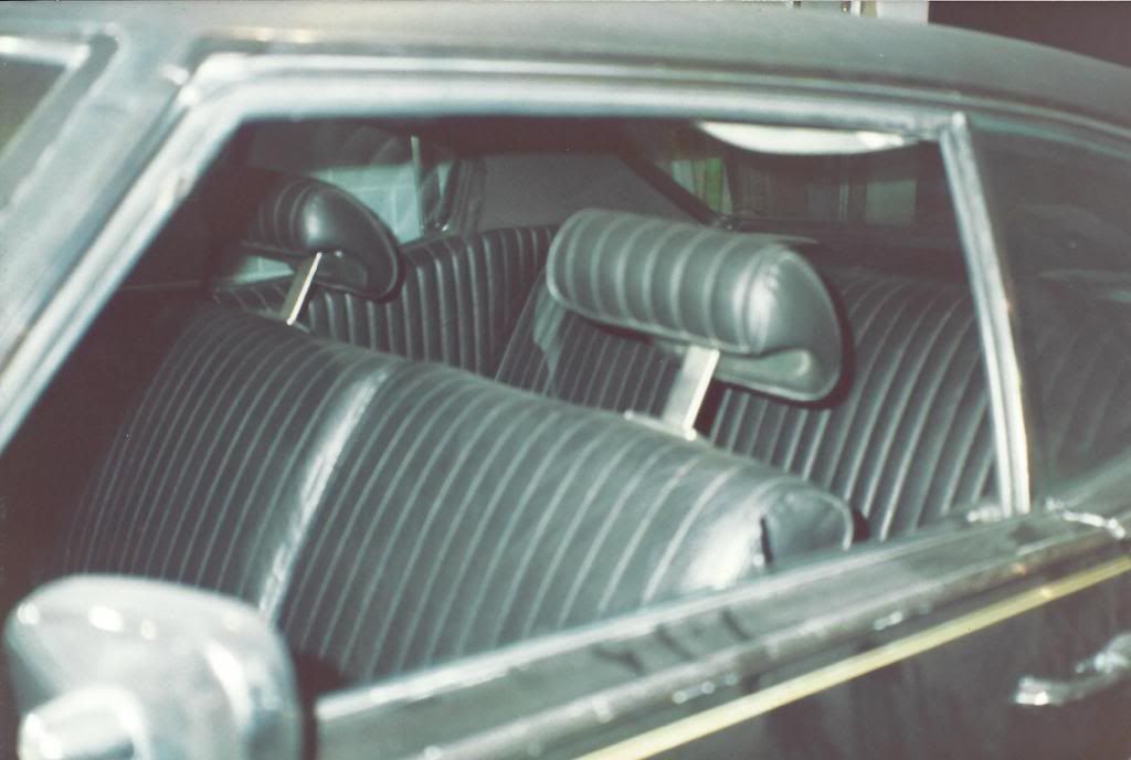

Here's the roll and pleat job my Dad did when I first bought the car. Seats are still in the attic of the garage. they would probably clean up good to this day.
http://i115.photobucket.com/albums/n...ps2bde30f6.jpg

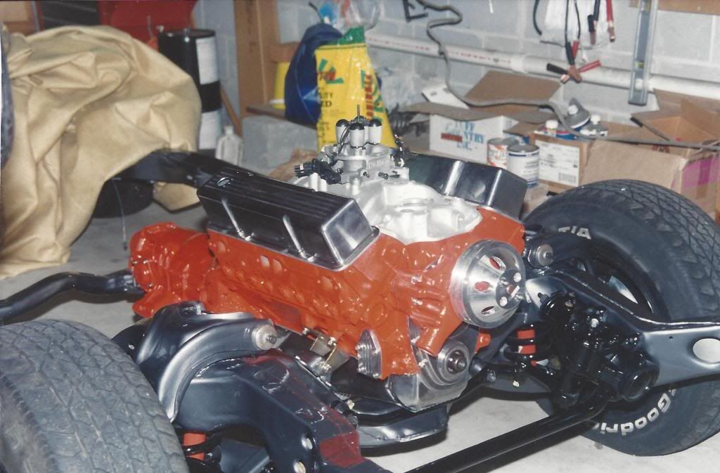

I used the original engine block to build a 383 and a turbo 400 trans. the original trans was a three speed on the column.
http://i115.photobucket.com/albums/n...ps76fd355d.jpg

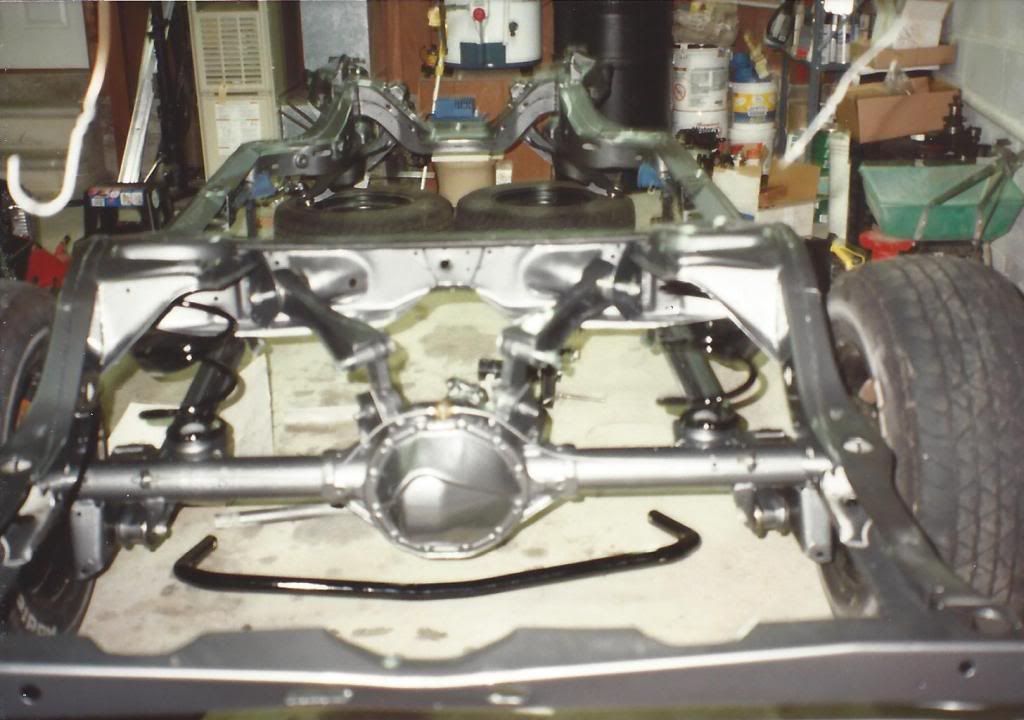

Now after many years as I stated, we have started a complete tear down and going the same direction as before, just with updated parts. No, the wife has not figured out how much this has cost. Please don't tell her.
Here is the rolling chassis before the teardown.
http://i115.photobucket.com/albums/n..._4623-Copy.jpg

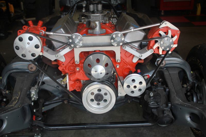

The engine sitting in the frame
http://i115.photobucket.com/albums/n..._4620-Copy.jpg

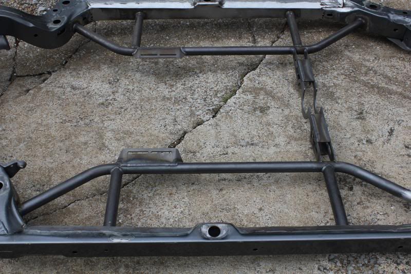

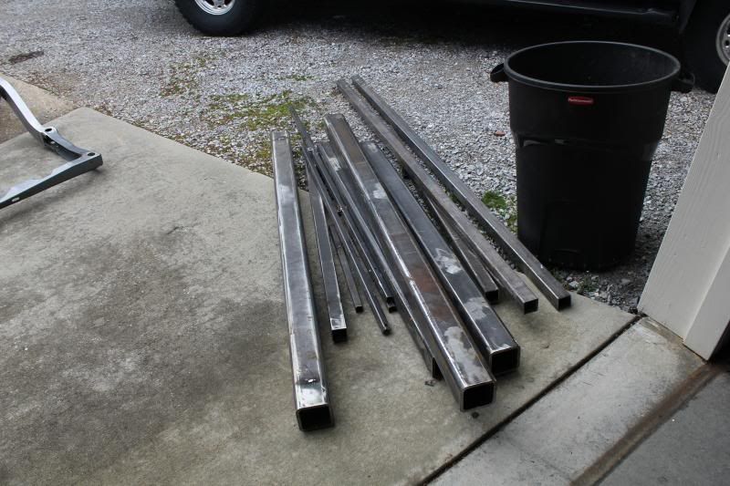

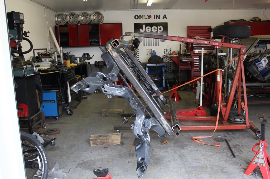

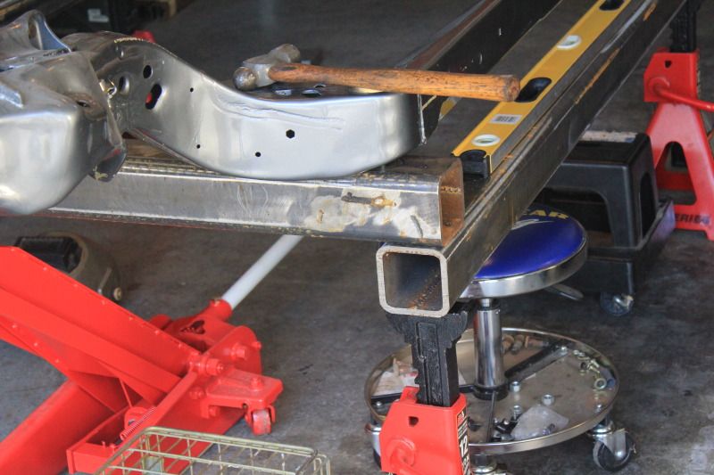

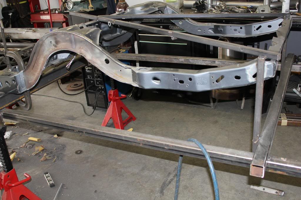

Alright, here is where I stand today. Ordered the HPI frame kit and I have it installed.
http://i115.photobucket.com/albums/n...E/IMG_5060.jpg
http://i115.photobucket.com/albums/n...E/IMG_5059.jpg
I made a homemade frame table out of some 1/4 wall 4" sguare tubing.
http://i115.photobucket.com/albums/n...E/IMG_4643.jpg
http://i115.photobucket.com/albums/n...E/IMG_4644.jpg
Turning it over to weld the bottom was fun.
http://i115.photobucket.com/albums/n...E/IMG_5065.jpg
All this is welded in. I now have the ABC Performance rear frame narrowing kit that I am currently in the process of installing. I'll get pictures of this later.

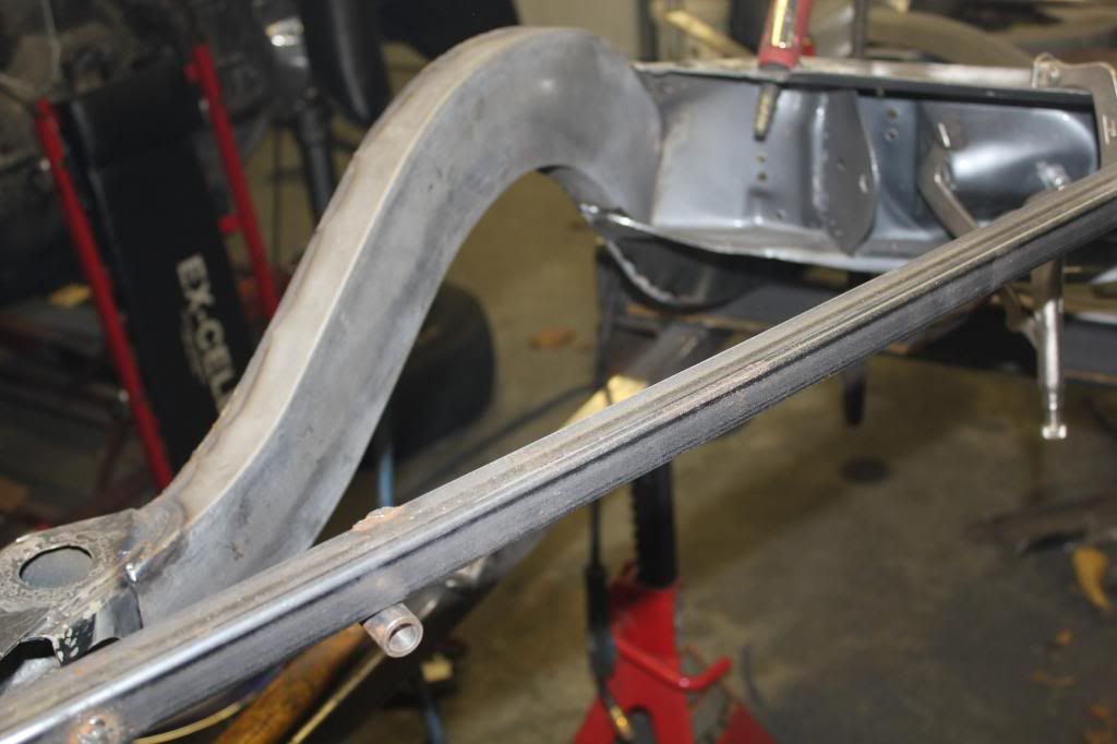

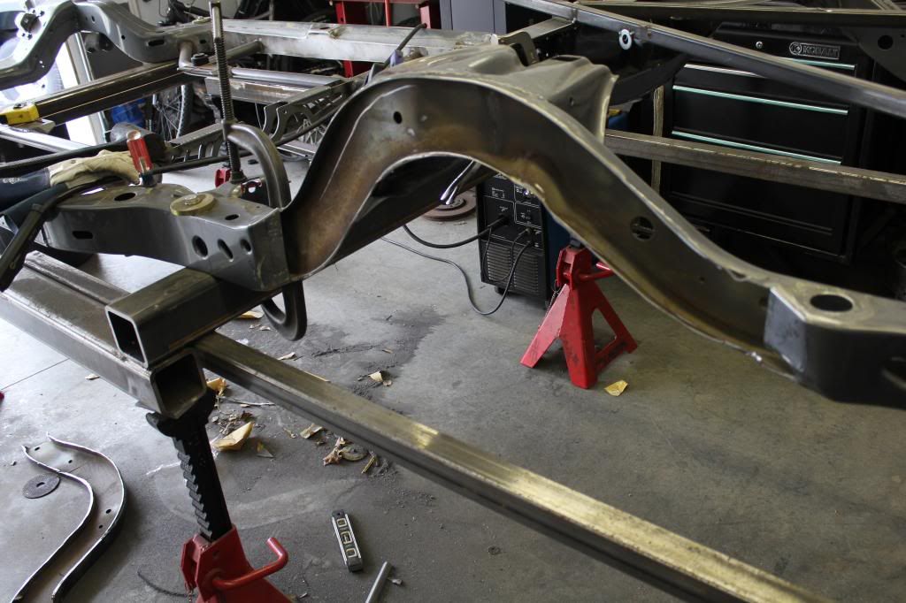

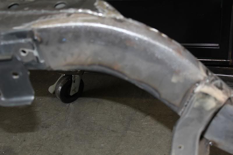

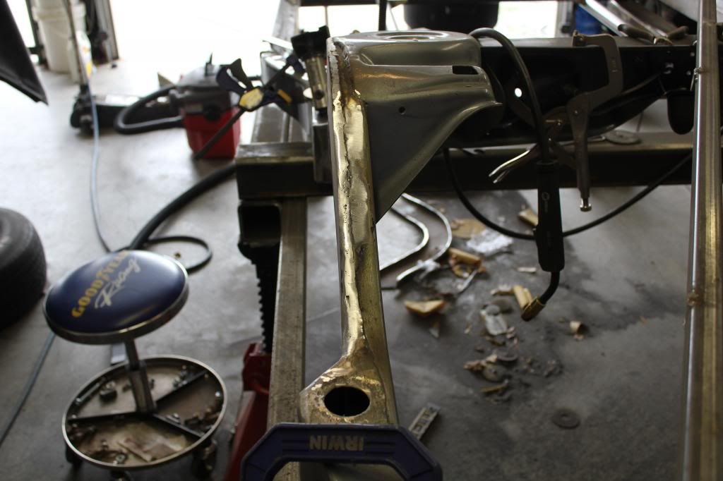

Just thought I would give a little update. Worked all weekend on the rear frame section. This kit is from ABC Performance. He really has thought this through. I am really impressed with what strength was added with this kit.
Here is the first and main cut of the frame. The outer plate is removed.
http://i115.photobucket.com/albums/n...psa9e012c7.jpg
Here is how I braced the frame to hold everything in place.
http://i115.photobucket.com/albums/n...pscff61a3e.jpg
This is a 3/16" solid plate that is welded into the frame section.
http://i115.photobucket.com/albums/n...ps7416a4f8.jpg
Here is the top view showing how thick the frame is now.
http://i115.photobucket.com/albums/n...ps22839165.jpg

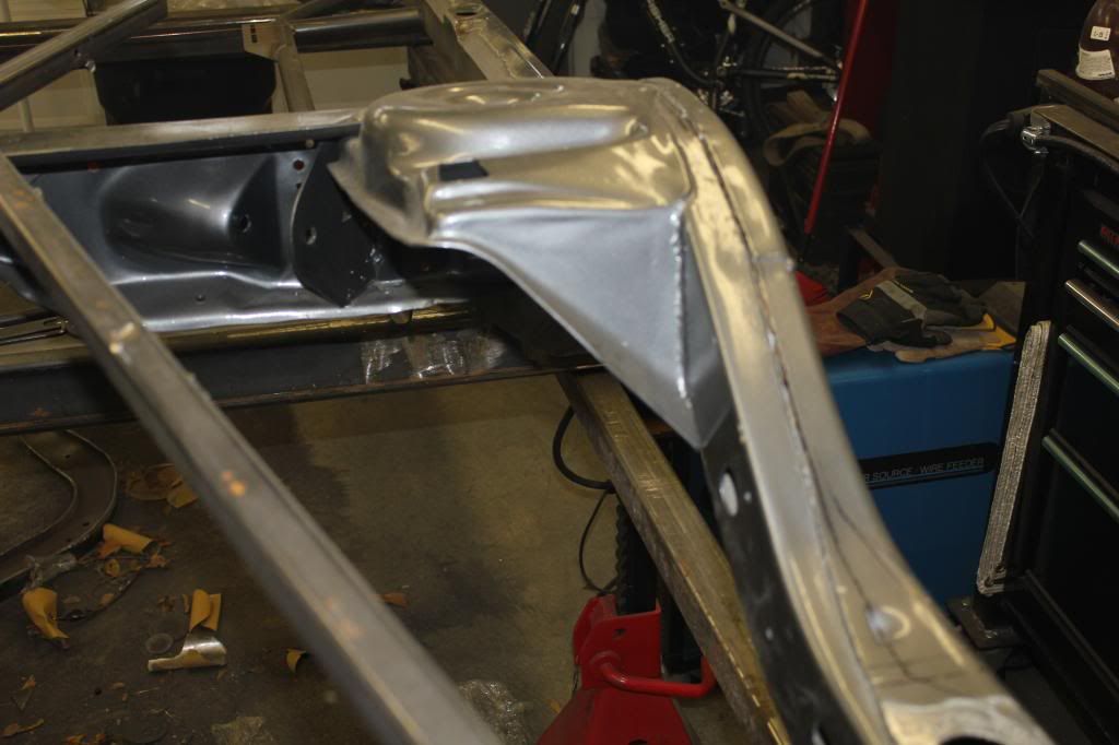

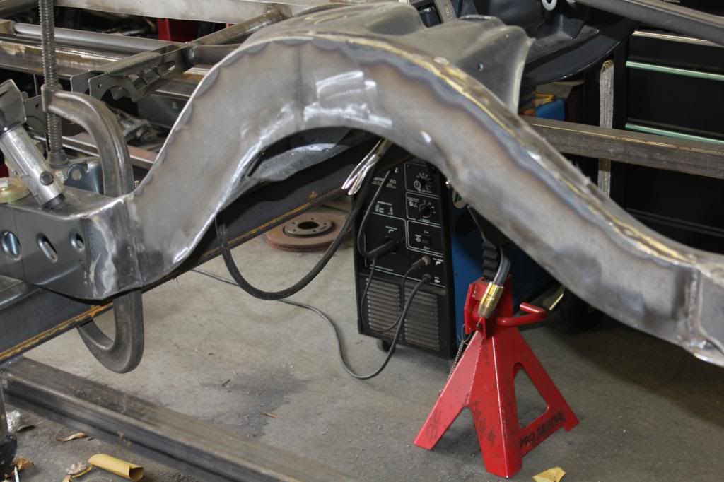

Now this is the added inner "C" that goes to the inside. You can see now that it looks like a replacement rear section that one might add if doing a complete rear sectioning.
http://i115.photobucket.com/albums/n...ps090aef95.jpg
This is the left side after all new material added.
http://i115.photobucket.com/albums/n...ps0b26d106.jpg
Here is the right side still showing all the old metal of the frame. Big Difference.
http://i115.photobucket.com/albums/n...psb68368f8.jpg
Lots of grinding and welding. but I think it is going to be worth it.

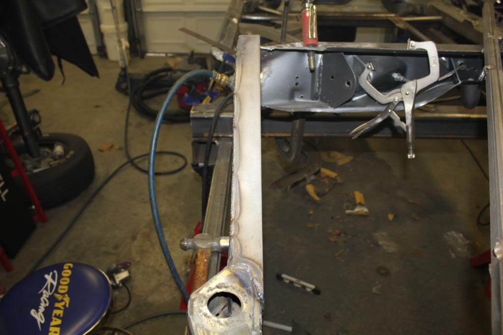

Tyler, yes you can see that brace kit. Very well thought out kit. thanks for coming up with it.

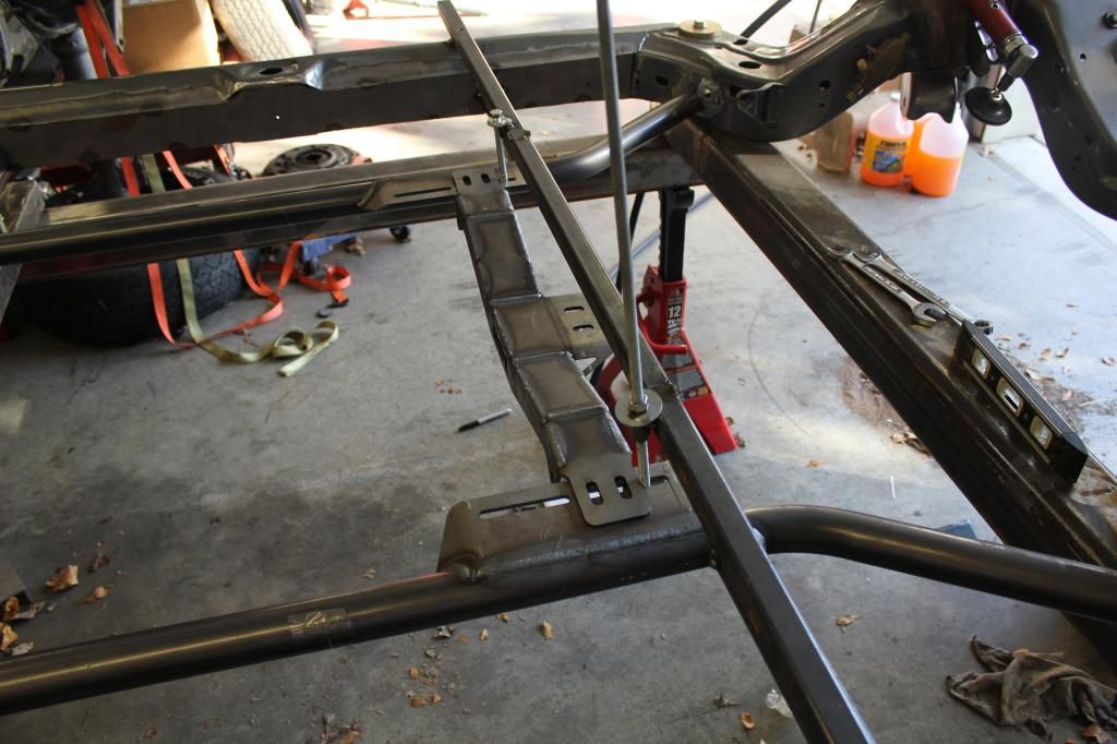

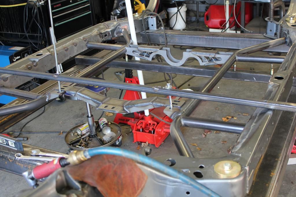

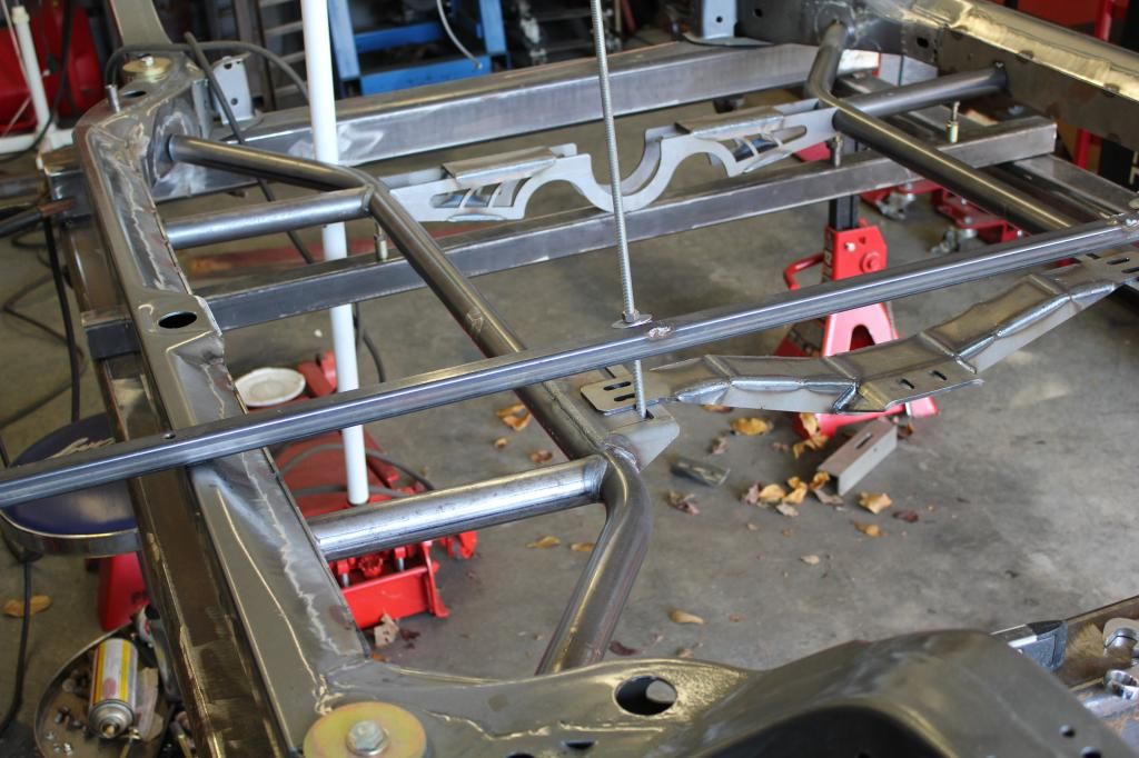

Here are some more pics. If you look at the back you will see where I got a little over zealous with the disc sander.
Trying to get the tubes at the correct level was a bit of work, but I made it.
http://i115.photobucket.com/albums/n...E/IMG_5062.jpg
Here's a good shot of everything in place.
Now as far as the ABC kit, yes he does have a new 70-72 A-body kit. I will say I am impressed with it. Very well thought out process. I'm going to get with him on some measurement questions I had, but everything has worked out.

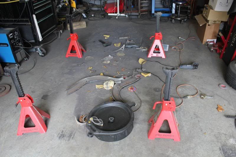

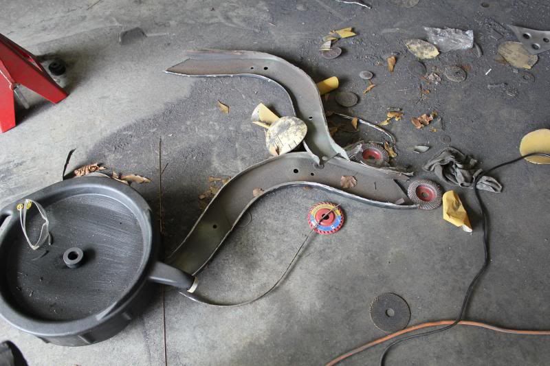

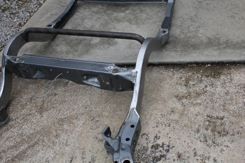

HEEP 03-24-2013 06:10 PM

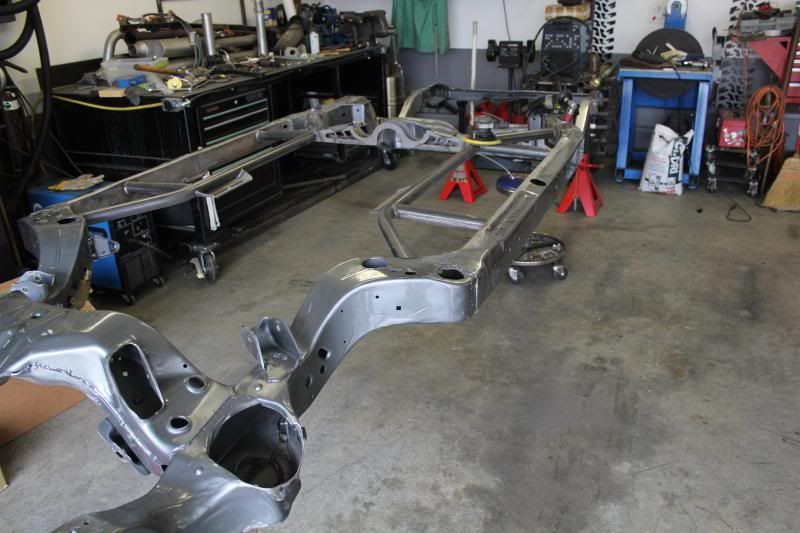

Just a little update. Finished up both sides of the frame. The right was a little tougher than the left. I talked with Tony at ABC and he said he has seen the problem I had. It tested my amateur fabrication skills to the max. However, the good thing about metal is you can add more and make it smooth again.
Here is the finished frame. There are a couple of welds that need to be finished on the bottom.
http://i115.photobucket.com/albums/n...ps416632a5.jpg
Another shot.
http://i115.photobucket.com/albums/n...psf8edd4b7.jpg

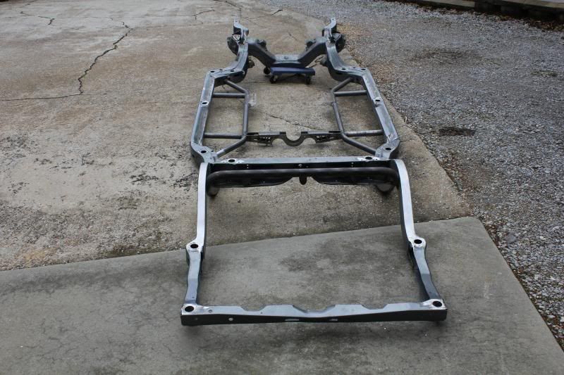

Here is the HPI portion of the frame.
http://i115.photobucket.com/albums/n...ps9a002d38.jpg
WOW. what a mess.
http://i115.photobucket.com/albums/n...ps15bc945a.jpg
There is a lot of dust on the floor. Went through many discs and flapper wheels.
http://i115.photobucket.com/albums/n...ps035e75d9.jpg
Tore down the frame jig.
http://i115.photobucket.com/albums/n...ps3cf40092.jpg
Cleaned up the floor and the garage. Took a while. Got the frame back in and turned over, ready for the few welds on the bottom that need to be finished.
http://i115.photobucket.com/albums/n...psc020c3d7.jpg
Her is one of the plates that ABC provides in their kit. It finishes out the frame rail and strengthens it at the control arm mount.
http://i115.photobucket.com/albums/n...psca4dec4b.jpg
That's about it for now. I hope to finish up the welding this week. I had planned to have the body blasted before I put the frame under it. I think I am going to wait. I'll mount the body, do the tubs in the rear. and get everything done and then go back to blasting the body.
HEEP

How many hours do you think you have in doing the frame modifications shown?
HEEP 03-25-2013 08:57 AM
Originally Posted by Che70velle (Post 472055)
Nice work! Post some pics of the rear inner fender to frame clearance, before you begin the mini tub work. I'd like to see what your working with in that area.
Frame looks great!
I definitely will. I am anxious to get to that point. It will be a big undertaking for me to do the tubs.
Originally Posted by 214Chevelle (Post 472084)
Looking good bro. :welder: With the framework on the rear, how wide of a tire can you now go?
ABC is saying 335s back there. I will have to wait to see. I need to get my hands on some tires for testing.
Originally Posted by strtcar (Post 472091)
looking great.
Thanks, I am happy with how it is turning out.
Dug, in my mind too many. However, I was trying to learn to TIG while installing the HPI kit.
I think I had about 24hrs in the front portion, and about 30hrs in the rear.
