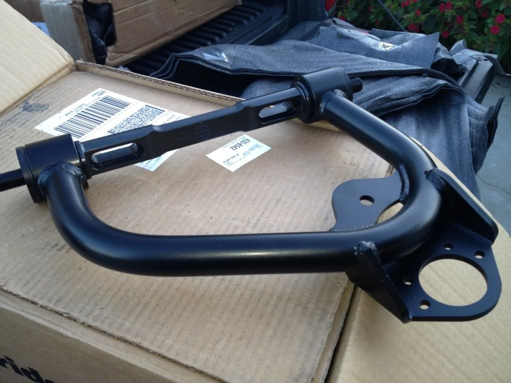

I received the revised 1st gen F-body arms yesterday. They look great. They only come with the zero offset slugs, so I'll have to order up some of the offset slugs to get the caster where I need it. Other than that they seem to be a very high quality piece. I just got off the phone with Ridetech and they are sending me the offset caster slugs. That is excellent customer service and product support. Light years ahead of my previous suspension supplier.
http://i1122.photobucket.com/albums/...psf8ae07c1.jpg

Hmmm. The temptation builds. Me want... :)

Pull the trigger. I am very happy with the quality of their parts. I've used a mix bag of parts before on other cars that worked, but a fully engineered system is the way to go. Do it once and do it right. You will save time and money in the long run.
