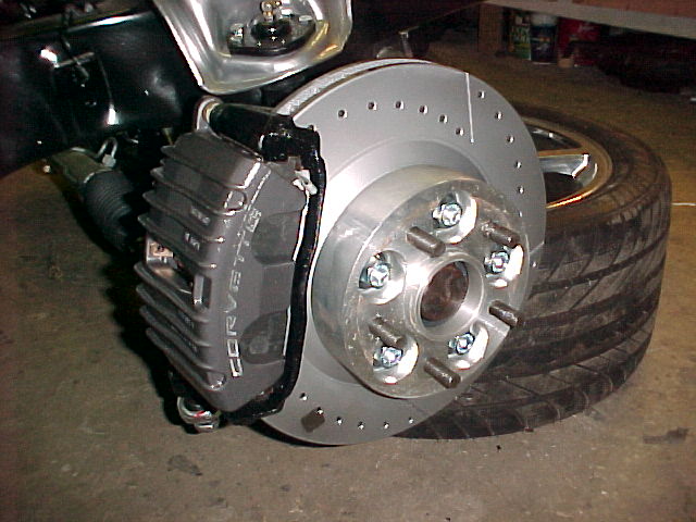

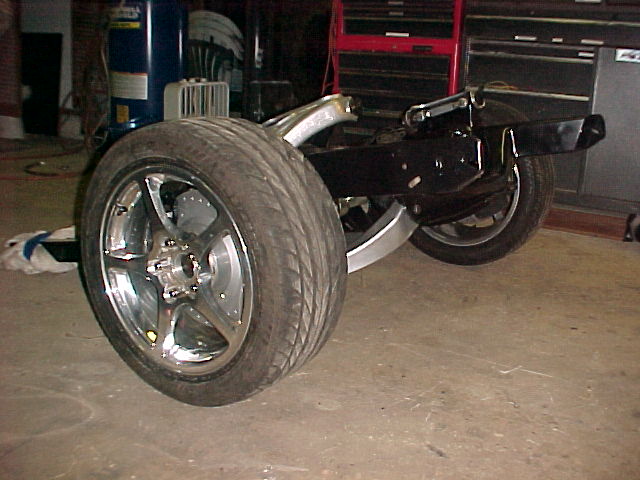

69MyWay 02-19-2005 02:06 AM
How about the new guy tries to help out here?
I work very close with VB&P. They use my vette on most of their magazine print ads. I worked with them and Tony Huntimer to get the right BS for my 1st gen Camaro with C5 wheels.
The ZR1 wheel is 11" in the rear and is going to give you a fit on a stock rear wheel house. You can fit the C5 wheels, but it is super tight. You want to run a 2" in the front and a 2.5" in the rear. In my case I had the 9" built with the 2.5" on each side added so no rear spacer needed.
Here is what the spacer on the front looks like. I think it actually looks very natural behind the rim once it is all bolted up:
http://www.mcspeed.homestead.com/fil..._installed.JPG
http://www.mcspeed.homestead.com/fil...ls_and_sub.JPG

Spacer blends in very well I think. :thumbsup:
68protouring454 02-19-2005 02:56 PM
i agree
they do blend in well, and they do not look funny at all
jake

Makes sense. However, I can tell you we had a set on the front of a 1985 Vette to allow the 88-96 offset for a set of ZR rims for about 8 years. The car got pounded hard on a regular basis. The wheels and spacers came off just fine the last time I messed with it.
The instructions are very specific about the amount of torque applied to the lug nuts. My guess would be Tito-Jones might have applied a little extra torque that may have caused the stud to pull in too deep, then spin out.
