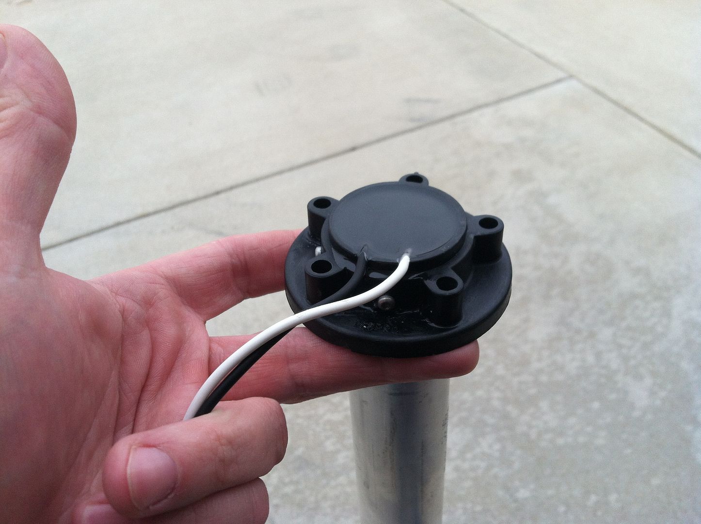

If u use a ricks tank in the first gen camaro, don't use the crappy sending unit they suggest , upgrade to ISS custom sending unit!!you will thank me when u don't have to re pull the tank down cause the cheap sending unit works like crap..http://i1237.photobucket.com/albums/...ps92983e12.jpg
http://i1237.photobucket.com/albums/...ps4c96b2d3.jpg

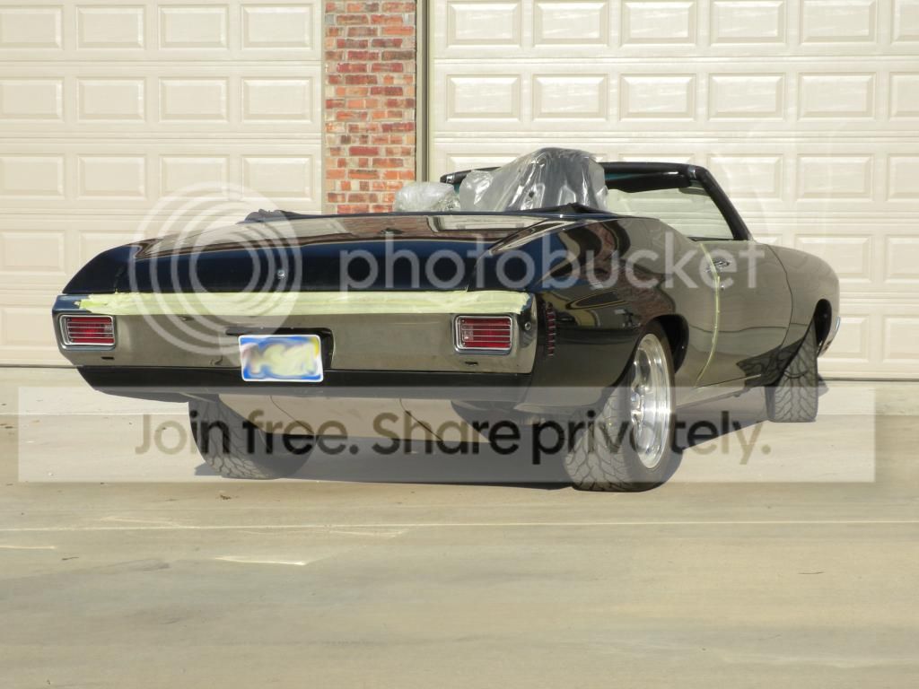

+1 for Ricks... I've probably used at least a dozen of Rick's tanks.
Our Chevelle feature vehicle we just finished has a Rick's Stainless tank in it...
https://lateral-g.net/members/revved/

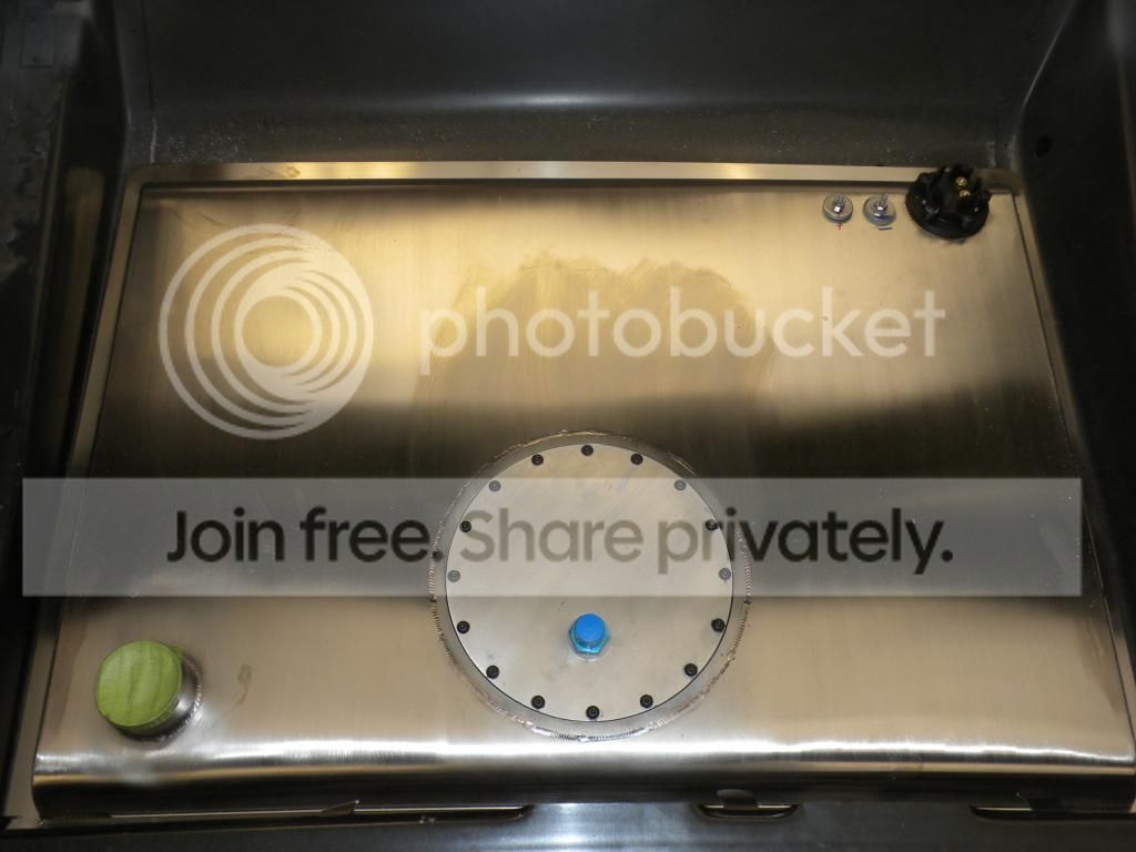

http://i696.photobucket.com/albums/v...ps7908d7ae.jpg
Sounds like you already have your tank in but for future reference having them trim the front corners of the tank are a big plus for adding 3" exhaust on over axle stuff.
The majority of the G.T. 500 E's I deal with have them as well. They do weigh a ton but for visual effect on a high end build I don't know how you would beat them.

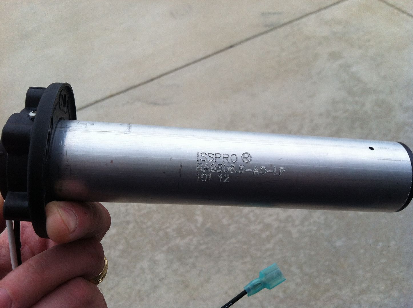

Erratic senders have been an issue in the past. I jrecieved this tank from them yesterday with a new- new style sender I've never seen before so we'll see how this one works out!
http://i696.photobucket.com/albums/v...psfc6e5472.jpg
