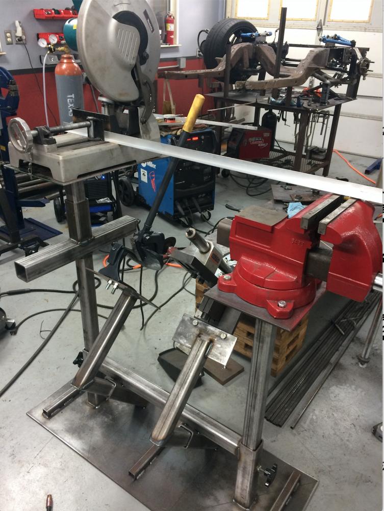

I was thinking of this old thread the other day when I finally mounted my vise, it took me a while to find it (the thread).
I'm a member of Garage Journal, I think since 2006, and learned this hack from there. I mounted my shrinker/stretchers a couple of years ago and got tired of going from my shop to my garage to get to the vise.
it's just a cheap receiver mounted under the bench and section of square tubing I had on hand. I did have to pay $10 for that 1/4 plate under the vice.
I store the "loadable" items under the bench with square tubing, angle iron, and other pieces I fabricate.

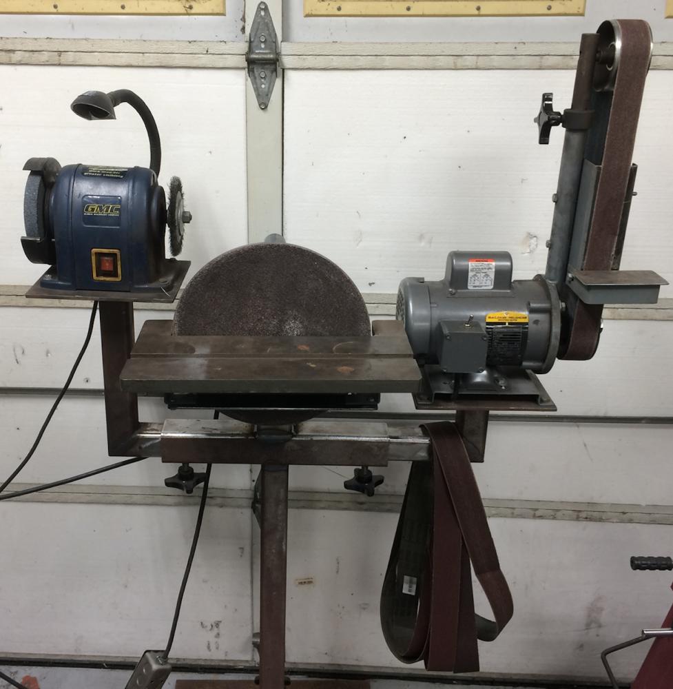

I did something very similar in my shop. I used 2x.120 and 2.5x.12 square tube with a goal to be modular because I can never make up my mind on how I want things. Ignore the mess in the pic, I assure you it has been organized since then.
Attachment 65400
Attachment 65401
I terms of organizing I built some shelving out of 1/2 sq tube and expanded metal so it wouldn't hold dust. I also bought cheap clear totes from HD and a label maker off Amazon. Best thing I've done in a while. So nice to be able to find things for once and not have clutter in your workspace.
I added LED strips off Amazon below the edge of the shelves with double sided tape. it really gives great light to work in. I also swapped all my 4ft florescent tubes for the non ballast 5K LEDs from Amazon. It's soooooo nice to have good light now. Worth every penny

jarhead 04-13-2018 06:20 PM
Thanks Bob, hopefully you can put it to use... I forgot to mention I stick an old "long bolt" through the receiver to hold the tools in...

dontlifttoshift 04-13-2018 06:48 PM
If you need to do a bunch of receivers, most steel suppliers sell 2 1/2 square tubing with a .238" wall. It's basically .250" wall with the seam removed and then 2" slides right in.
