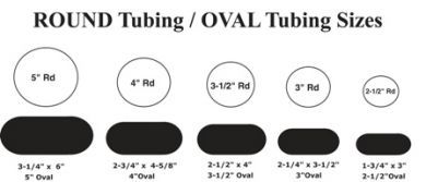

Ketzer 09-15-2013 07:07 PM
What about the oval exhaust? Never see it used? Seems like you could gain just enough clearance if you planned the bends correctly?
Jeff-
FETorino 09-15-2013 08:02 PM
Jeff-
Spintech has a chart of their oval stuff and how it sizes compared to the roundy round stuff.
:cheers:
http://i291.photobucket.com/albums/l...ps2aed517b.jpg
http://www.spintechmufflers.com/imag...es%20chart.pdf
