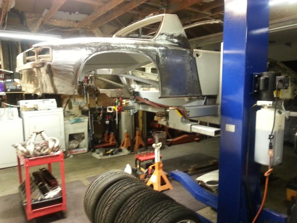

Doing my body prep, I am happy to have this tool. :)
http://i60.photobucket.com/albums/h3...118_112308.jpg

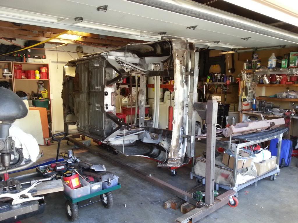

I'm moving slow trying not to repeat the mistakes I made on my first V8 914. I rushed the build and didn't get the chassis right. :confused59:
http://i60.photobucket.com/albums/h3...bility/105.jpg

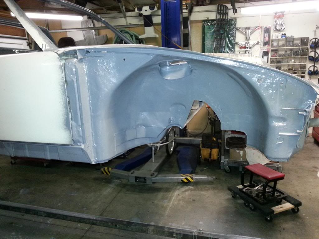

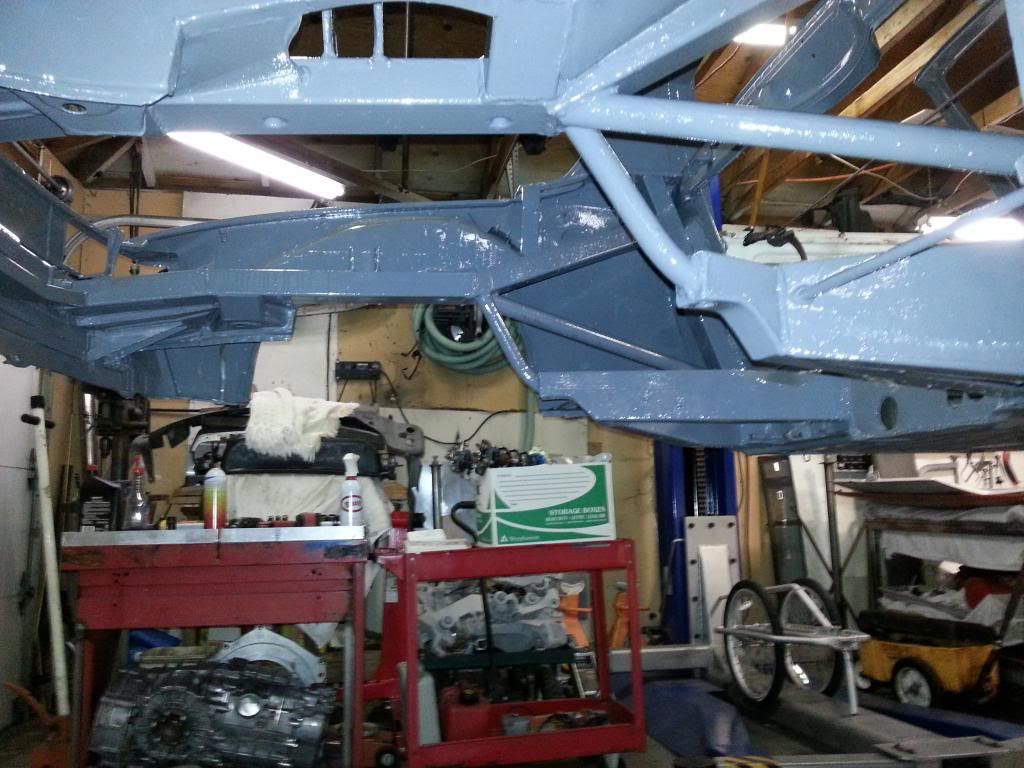

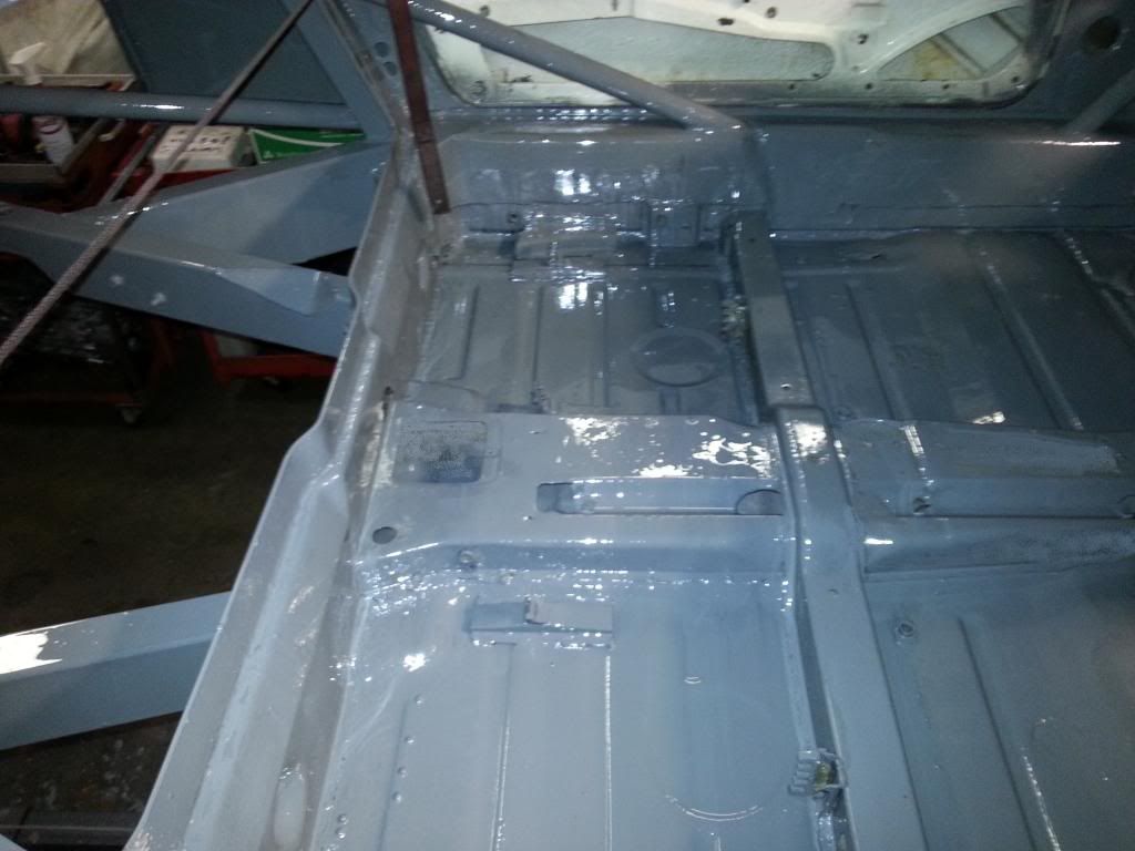

I decided to put an epoxy based anti-rust coat on the project. What a pain that is to do in your garage !!!! I used Por-15 a bit pricey but good stuff. :superhack: I'm going to install a rubberized coating next. Its a polyurethane product using a catalyst. This product will soften vibrations. Then ready to start installing the suspension and do the body work.
http://i60.photobucket.com/albums/h3...214_223000.jpg
http://i60.photobucket.com/albums/h3...214_223016.jpg
http://i60.photobucket.com/albums/h3...214_223044.jpg

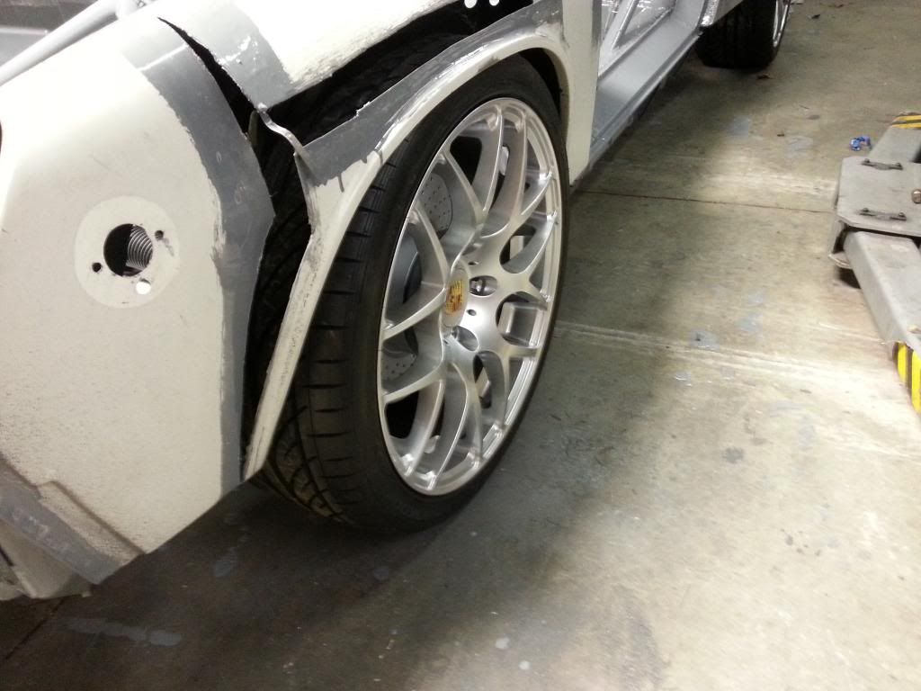

My front flairs need someone who knows what their doing. I can set the edge but the rest is up to my buddy in Washington State. I have to get the car running and drive it up there from CA. 1250 miles one way LOL
http://i60.photobucket.com/albums/h3...227_212433.jpg

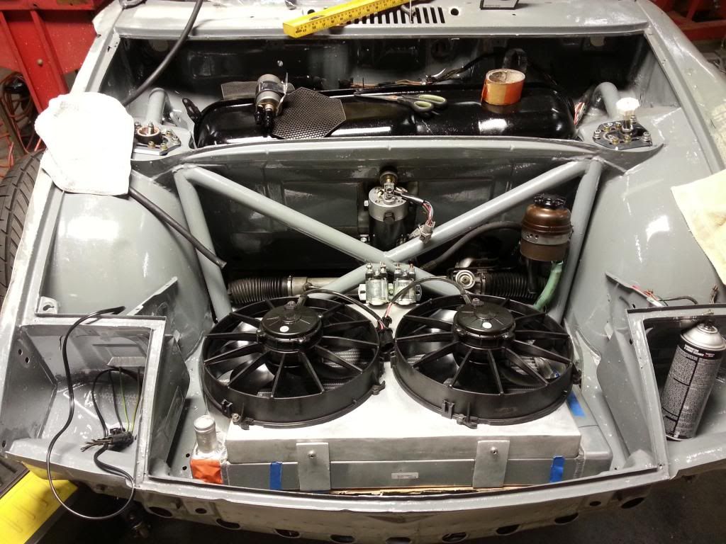

Electric power steering pump installed
Working on the radiator and fans ( Two, 12' Spal fans 3800 cfm total )
http://i60.photobucket.com/albums/h3...317_205640.jpg
Wired things up, the relays are made to handle 100 amps each (@ 100% duty cycle). They say 400 amps for short bursts, sounds like welding to me. The relays were to be used on a full size transit bus but I was happy to take them home LOL.
http://i60.photobucket.com/albums/h3...323_232328.jpg

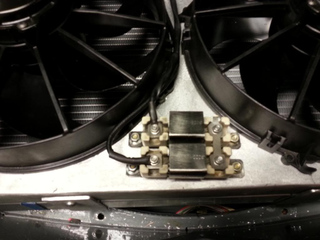

Two resistors, to be used to regulate a lower cooling fan speed. I'm mounting them on the other side of the fan shroud so they can get some air while in action. These are off a 6000 lb. Mercedes S500. Made quite well and should hold up fine. I still need to wire them and another relay.

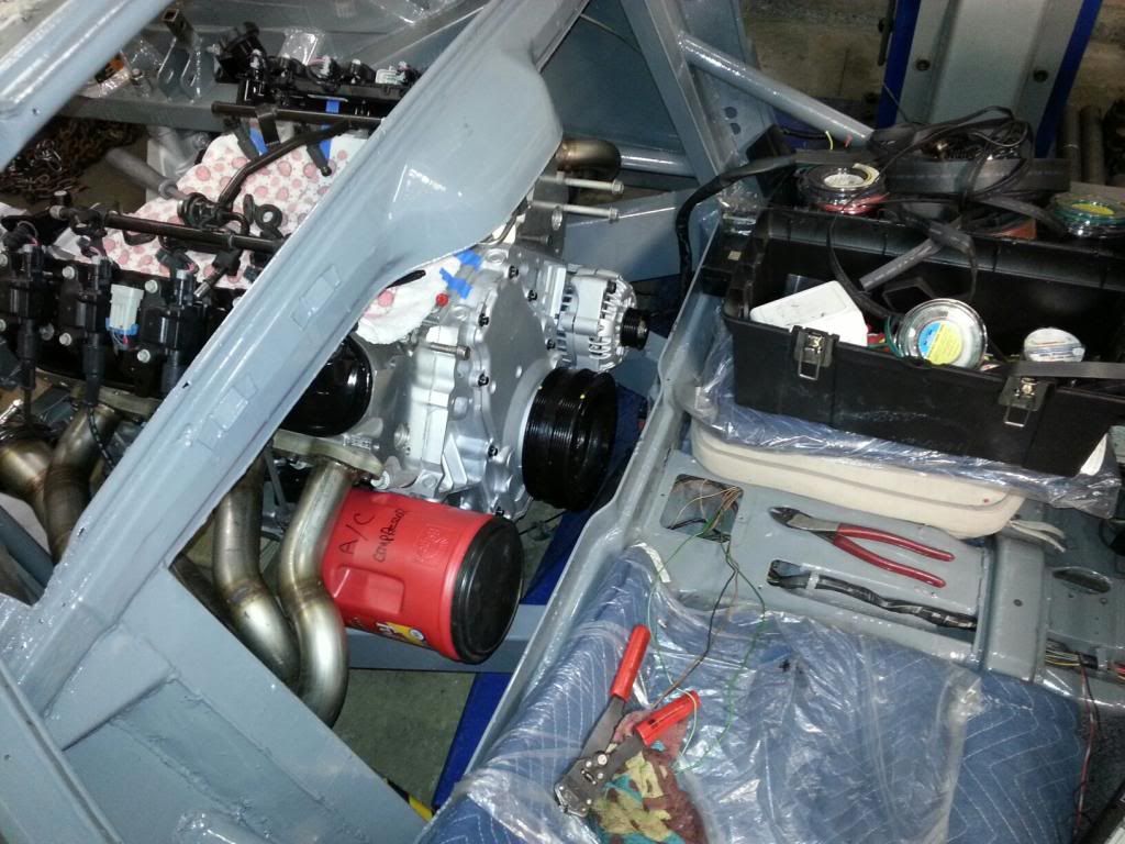

Cool project. I really like the red AC compressor.
HWY Nova 04-01-2014 03:43 PM
That is a new compressor line from Folger. I'm sure the better shops on this site carry them.

Ha Ha,
The compressor makes a strong cup of coffee !
