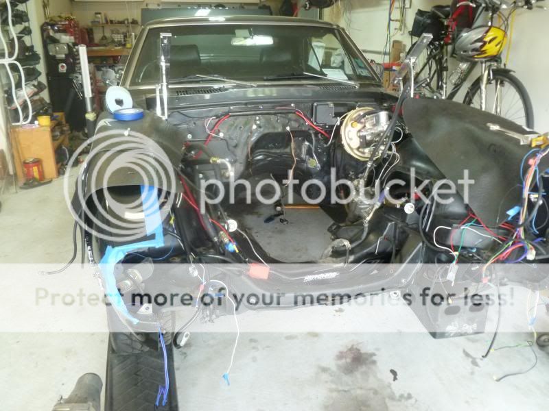

Dynamatted the car (3 boxes total), replaced all wiring with American Autowire, put front/rear disc brakes from an 02 Firebird in the car. Installed VA a/c, Mark 8 fan, Hotchkis subframe connectors.
Got the car running and entered it in a car show in Vancouver, WA. That was back in 2011. Almost 3 years after I started.

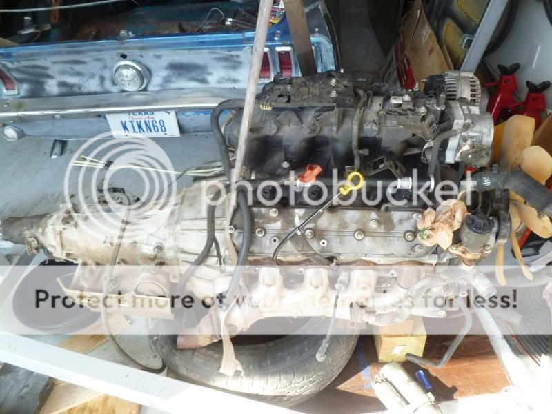

Sold the Pontiac drivetrain and found a complete 5.3/4l60e drop out from a 2001 pick up truck.
http://i616.photobucket.com/albums/t...psf6ed84f2.jpg
http://i616.photobucket.com/albums/t...ps8bcc7245.jpg
http://i616.photobucket.com/albums/t...pse1cf25c2.jpg

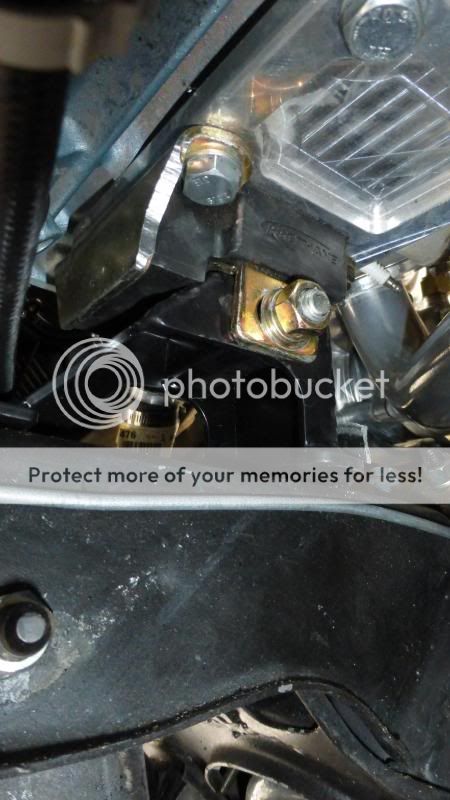

Also seen in the back ground is a 68 Mustang project that I picked up after moving to Houston. Sold the Mustang to fund the LS swap.

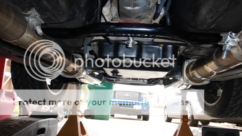

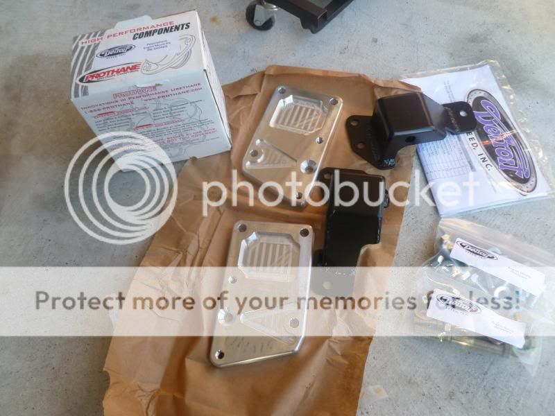

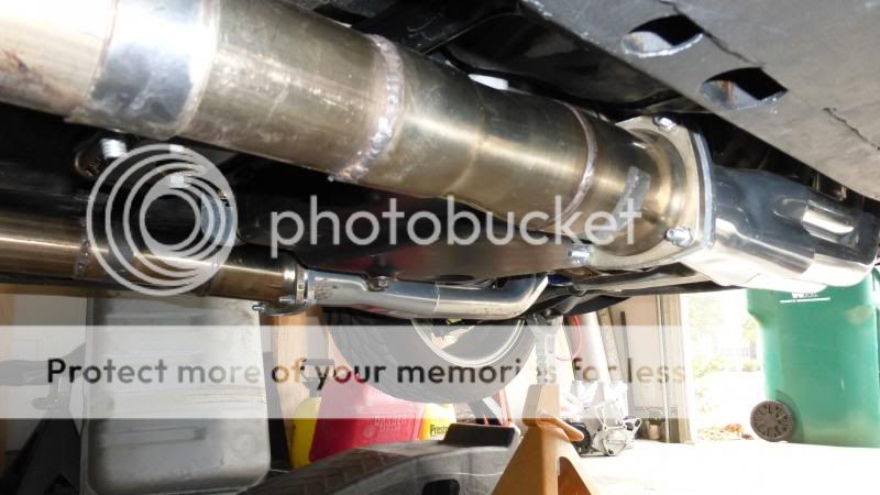

Did some research and settled on DSE LS swap mounts/Dynatech headers
http://i616.photobucket.com/albums/t...ps98028c0d.jpg

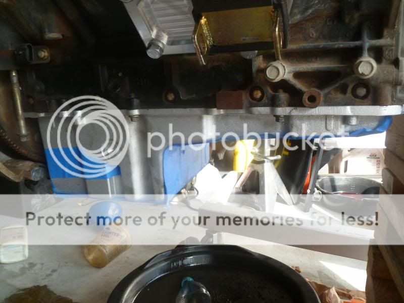

Mast oil pan. For the price Mast was asking, I was expecting the casting to be a little bit better. The casting on pan I received was a bit rough, but it fit great.
http://i616.photobucket.com/albums/t...ps0b51c0a9.jpg

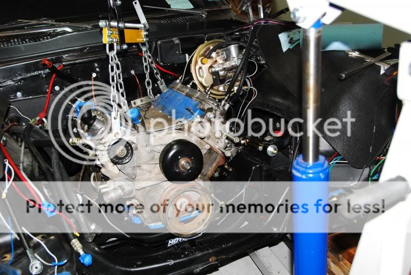

Engine/trans mocked up in the car
http://i616.photobucket.com/albums/t...ps62eb0c73.jpg
http://i616.photobucket.com/albums/t...ps2a23fbc9.jpg

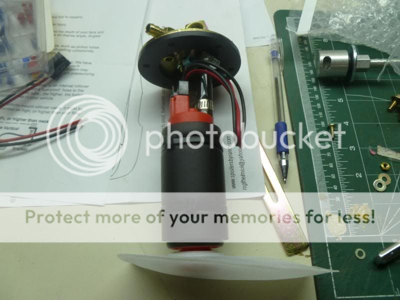

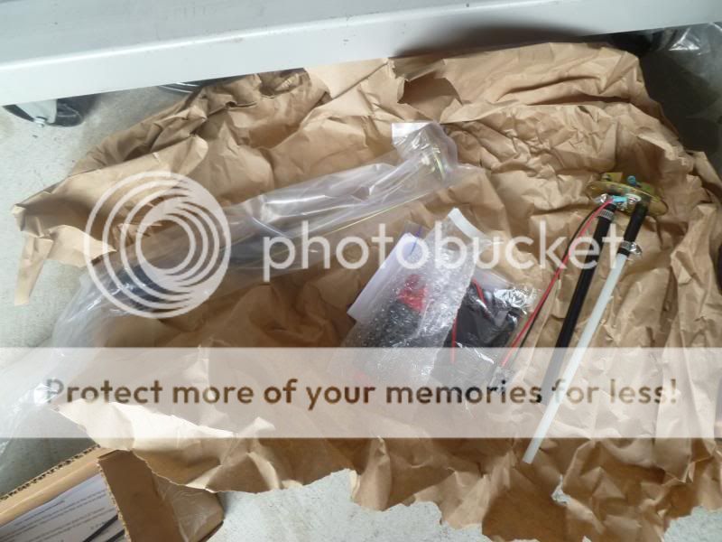

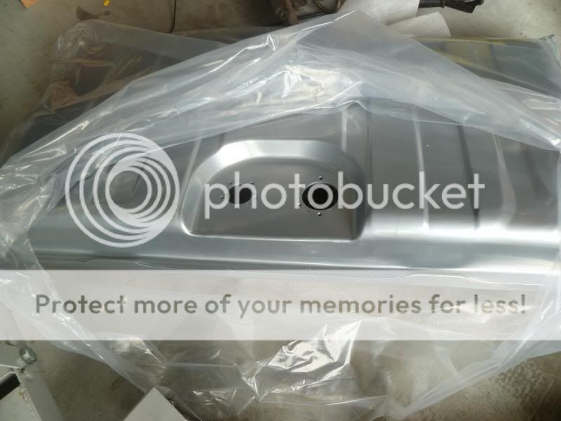

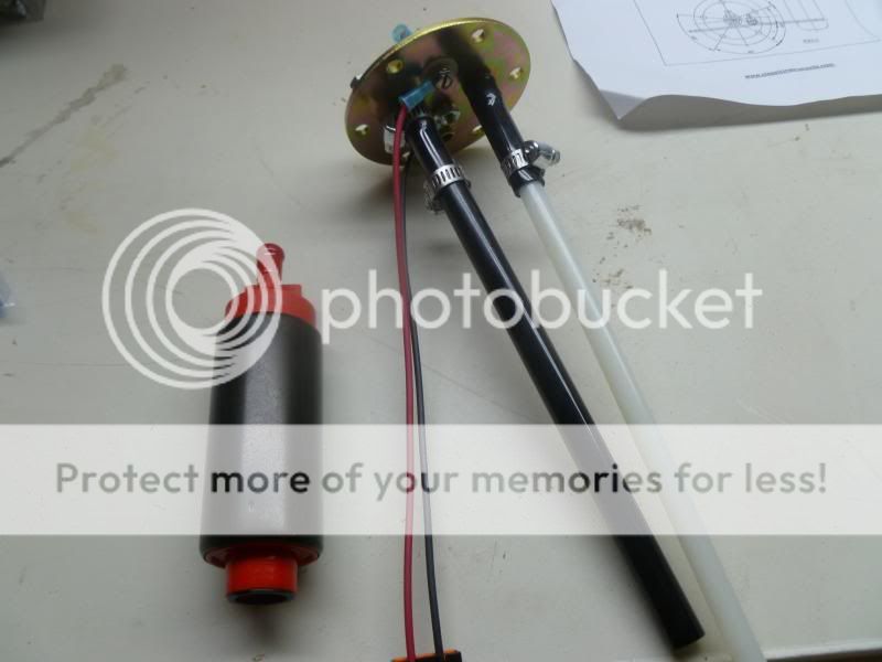

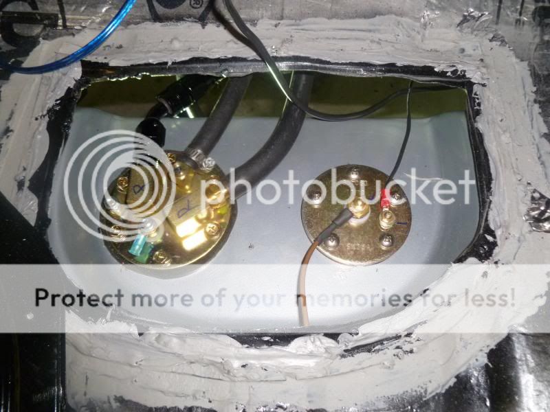

Tanks Inc FI tank with Aeromotive 340 pump
http://i616.photobucket.com/albums/t...pse201cde4.jpg
http://i616.photobucket.com/albums/t...ps4607b018.jpg
http://i616.photobucket.com/albums/t...ps3a5aebd5.jpg
http://i616.photobucket.com/albums/t...psd31d41d3.jpg

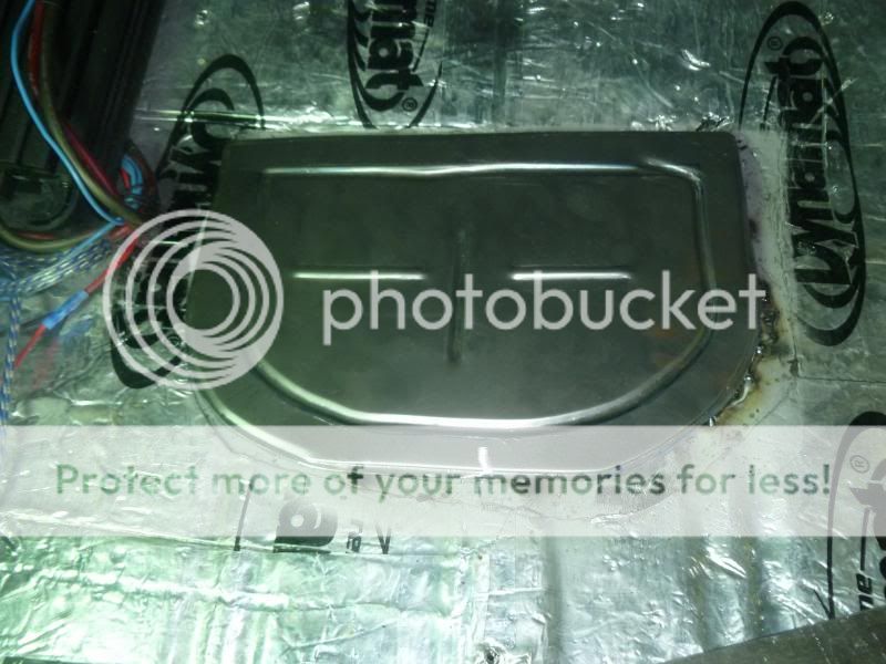

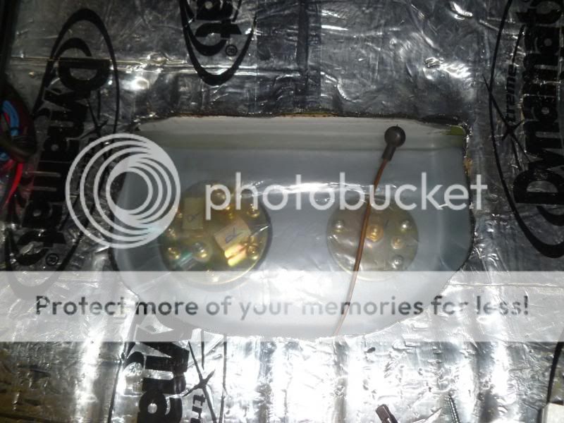

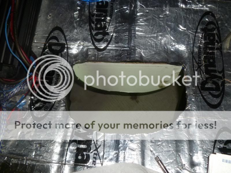

I saw on several DSE builds an access panel was created for the fuel pump access so I copied the idea. It did not come out as nice as DSE but it works. Now if I need to change the fuel pump, it's a 15 min job without dropping the tank.
http://i616.photobucket.com/albums/t...psfb07766b.jpg
http://i616.photobucket.com/albums/t...ps1ea2c93a.jpg
http://i616.photobucket.com/albums/t...ps090eac45.jpg
http://i616.photobucket.com/albums/t...ps3581c8ec.jpg

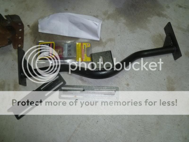

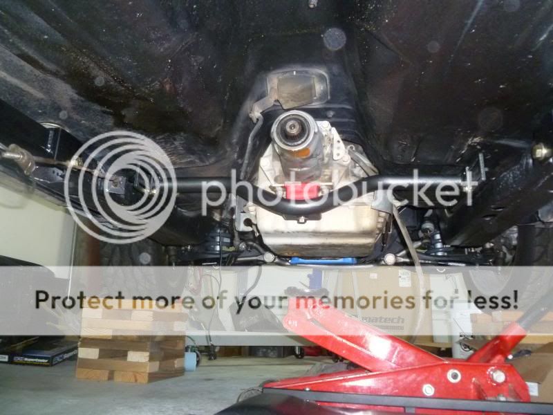

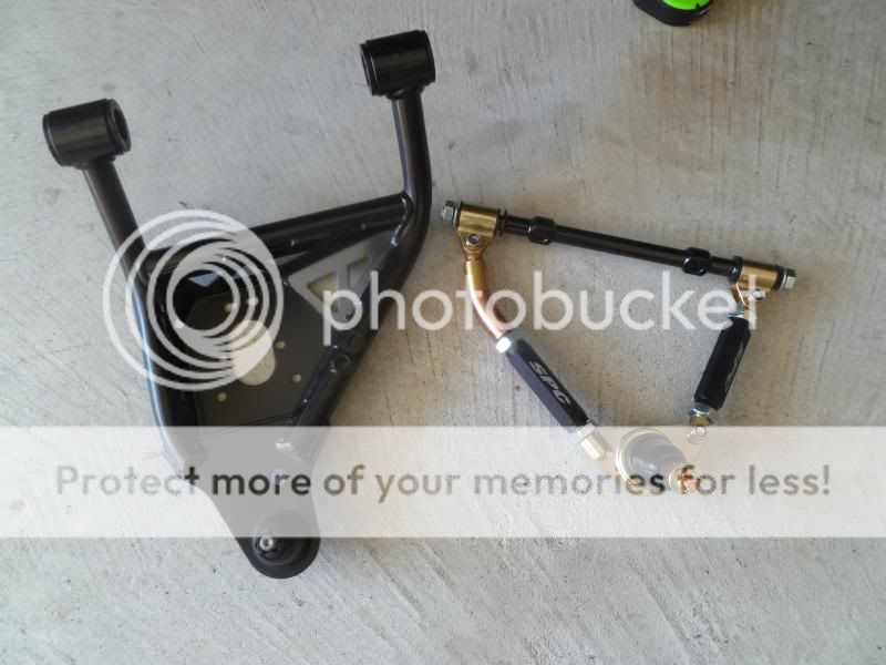

Got BMR crossmember
http://i616.photobucket.com/albums/t...ps31a25476.jpg
http://i616.photobucket.com/albums/t...psea380e9b.jpg

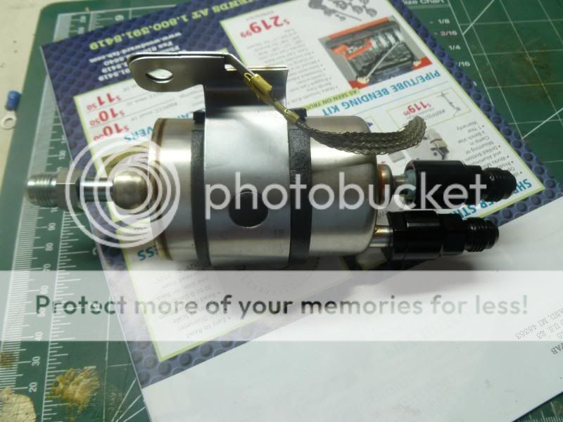

Corvette filter/regulator
http://i616.photobucket.com/albums/t...ps1b602224.jpg

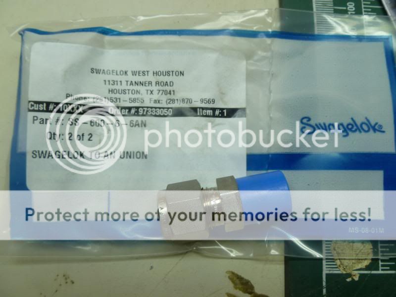

Swagelok an to hardline adaptor
http://i616.photobucket.com/albums/t...ps3604abb4.jpg
Filter installed, and wrapped up fuel tank/line installation

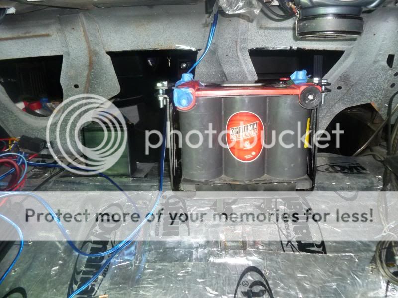

Mounted Finch dual vent next to the relocated battery.
http://i616.photobucket.com/albums/t...ps9705fd26.jpg

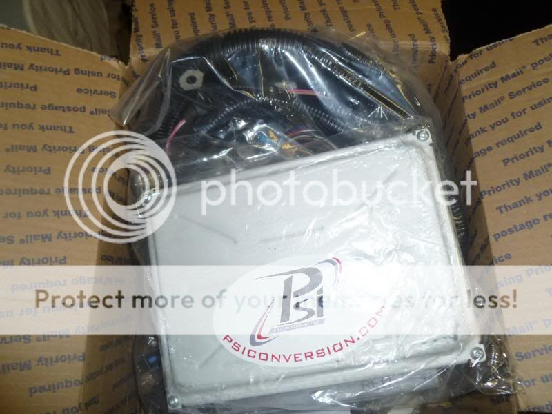

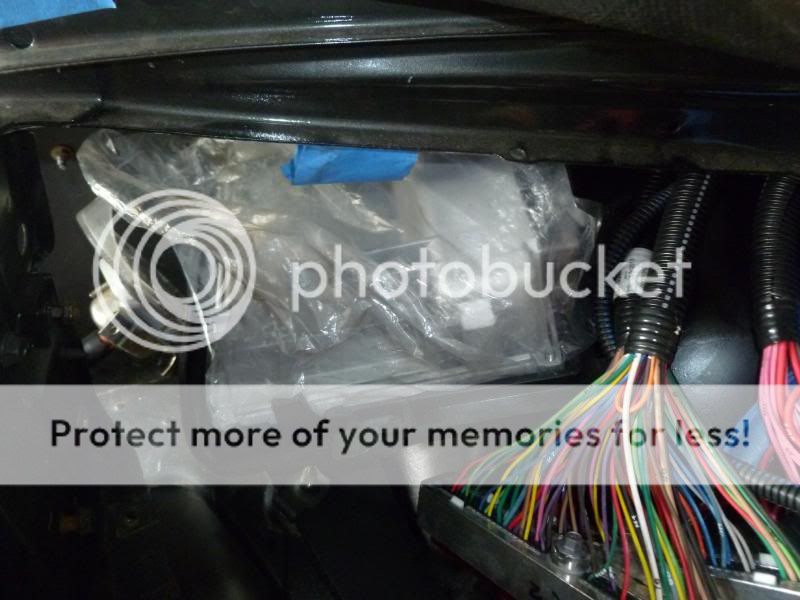

Got new wiring harness and LS1 ECU from PSI Conversion.
http://i616.photobucket.com/albums/t...ps99f0a20c.jpg

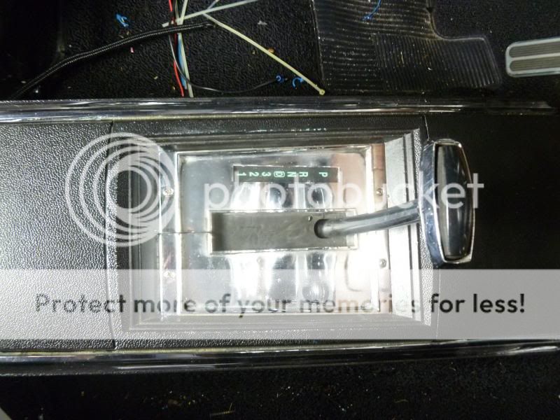

Shiftworks 4l60e shifter conversion kit
http://i616.photobucket.com/albums/t...ps23db2149.jpg

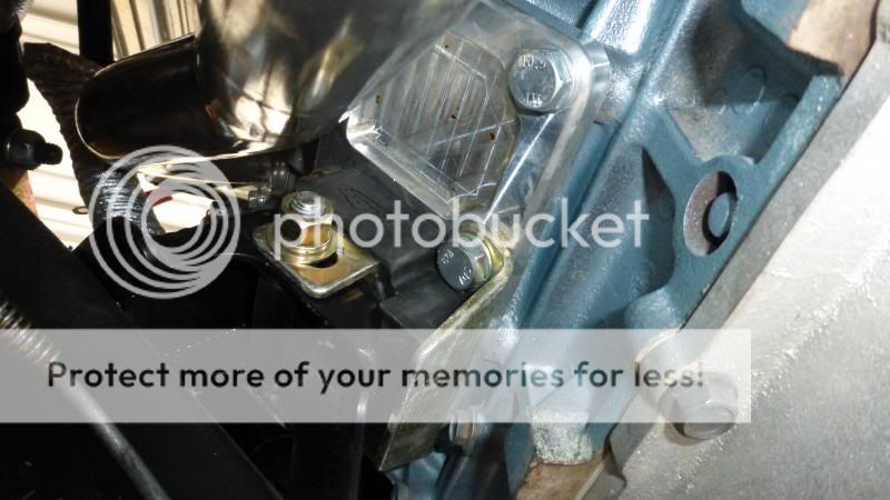

Rebuilt shifter with new bushings/neutral safety switch/shifter detent
http://i616.photobucket.com/albums/t...psd8feaa46.jpg
http://i616.photobucket.com/albums/t...ps0927096d.jpg

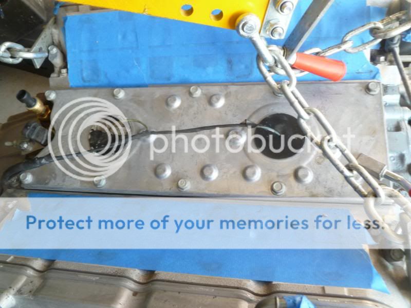

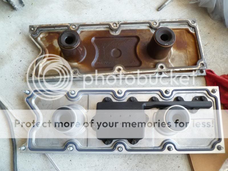

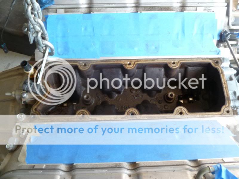

I converted the PCV system to the newer LS6 style. The new LS6 valley cover with the built in PCV next to the original one.
http://i616.photobucket.com/albums/t...psa52ea03e.jpg

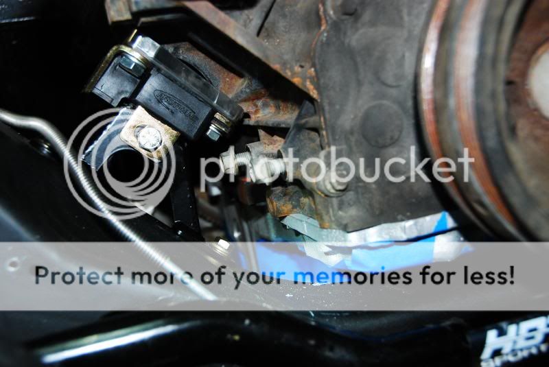

Removed the old one and install the new style valley cover. Reinstalled knock sensors and done. A quick 30 min. job.
http://i616.photobucket.com/albums/t...ps541831b1.jpg
http://i616.photobucket.com/albums/t...psd739fe72.jpg

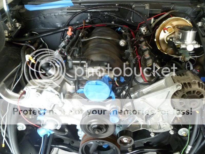

Picture of the engine bay with Holley accessory brackets, LS1 intake/fuel rails, truck coils
http://i616.photobucket.com/albums/t...psabe5f750.jpg

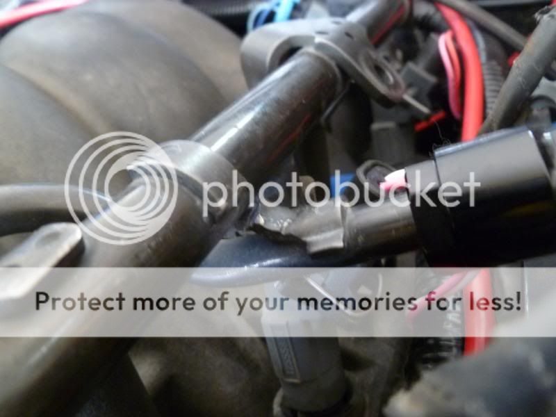

I had to bend the fuel inlet rail slightly to clear the taller truck coils
http://i616.photobucket.com/albums/t...pse8544ed3.jpg

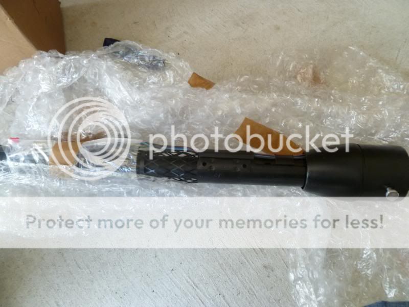

Swapped in a tilt column from Jim at gmtilt.com. Very nice piece.
http://i616.photobucket.com/albums/t...ps9b2a4406.jpg

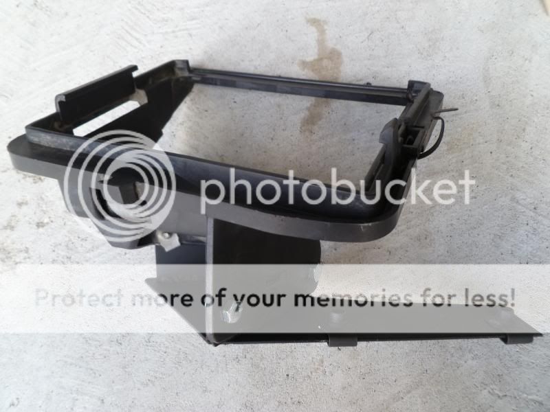

Also made a bracket to mount the ECU behind the pass side headlights.
http://i616.photobucket.com/albums/t...ps3e17d88a.jpg
http://i616.photobucket.com/albums/t...ps85a4c8cf.jpg

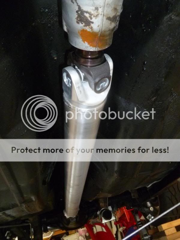

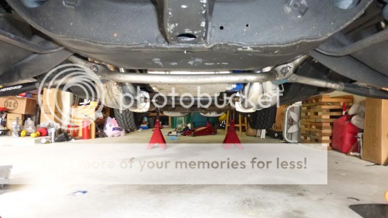

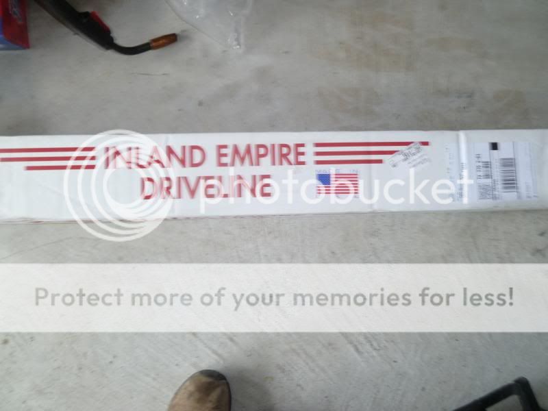

New 3.5" aluminum driveshaft from Inland Empire.
http://i616.photobucket.com/albums/t...ps1aaa7c15.jpg
http://i616.photobucket.com/albums/t...ps07586ef5.jpg

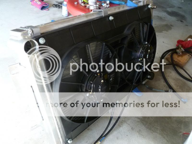

New al. radiator with dual Meradyne fans.
http://i616.photobucket.com/albums/t...pscadcf466.jpg

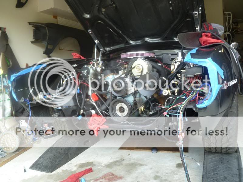

Picture of the engine bay.
http://i616.photobucket.com/albums/t...ps4c512046.jpg

I have Dynatech headers and DSE motor mounts on the car. The headers fit very well, but they hang way too low. In talking with Greg at Dynatech, and looking at photos of Ridetech's Velocity, which was used to develop the headers, it turned out that I had the mounts backwards. So I spent the last week lifting the motor up and flipped the mounts around.
DSE mounts I had installed initially.
The mounts flipped around.
http://i616.photobucket.com/albums/t...ps21fec192.jpg
http://i616.photobucket.com/albums/t...psd971cdb2.jpg
Ground clearance before
http://i616.photobucket.com/albums/t...pse9922b91.jpg
After. The headers tuck up a bit more. I gained prob 1.5" of additional clearance, which what I needed.
http://i616.photobucket.com/albums/t...ps69970d6d.jpg
http://i616.photobucket.com/albums/t...psda6bafe5.jpg
http://i616.photobucket.com/albums/t...ps59af379d.jpg
http://i616.photobucket.com/albums/t...ps7d174c45.jpg
The car is still on jack stands so I have not measured the ground clearance just yet.

Clearance looks much better after the swap of the adapter plates. I am actually surprised it made that much of a difference but glad it did.
I was surprise too. The headers did not tuck up as tight as Holley's new set up, but it works. Was told by Dynatech that they used Ridetech's old Velocity camaro as a mock up, and they flipped the motor mounts.

Drove the car around the block yesterday afternoon. Pretty stoked that my exhaust cleared the driveway, but now the belt is squealing like a pig.:hairpullout:

The headers fit a lot better that way.

Yep, apparently it was designed with the motor mounts upside down. Greg @ Dynatech said they will update the installation instructions.

I purchased an SC&C Street Comp Stage 1 plus from Marcus and full set of Ridetech HQ shocks back in thanksgiving of last year, but now finally had time to put them all together.
SPC upper and lower control arms
http://i616.photobucket.com/albums/t...ps6f68c1af.jpg
One side installed (missing the shocks)
http://i616.photobucket.com/albums/t...ps56d89134.jpg
Now just have to do an alignment.
