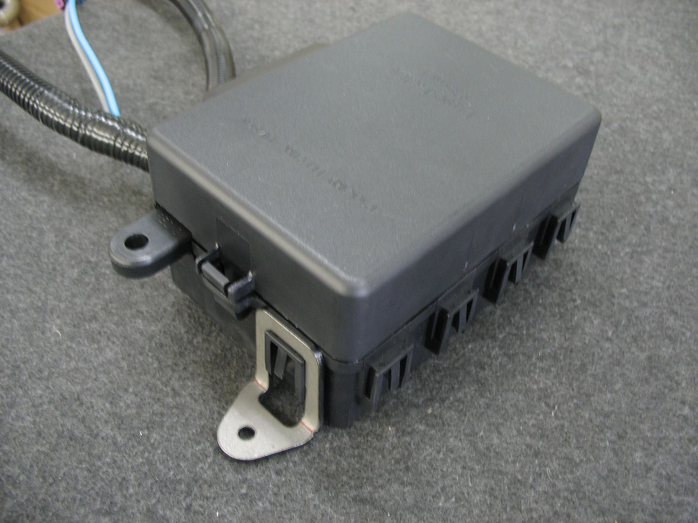

HPIcustoms 02-19-2016 05:03 PM
Hey guys, long time no post! So I just wanted to let you know, as far as the GMPP fuse box mounting, we have some cool news! HPI came out with a universal tab that you guys may seriously want.... it allows you to mount this pesky box anywhere, VERY EASILY. We also have model specific Connect-and-Cruise bracket kits coming out as we develop them (68-72 chevelle/a-body available now) that mount the ECU, TCU, DBW pedal, wiring pass through, and fuse box with only drilling 3 holes total, WITH HIDDEN ecus and optimum harness routing. These also come with braided harness wrap kit that includes cloth tape, hardware, and tools for installing the sleeve!
Take a look at these tabs. $10 for 2 black coated tabs with stainless hardware, or 2.50 raw each in bulk format! Our new webstore launches in a week, but you can call us or email us for these products immediately. I think its a great problem solver at a killer price. I hope not to sound preachy, but you guys asked for solutions!
http://i1204.photobucket.com/albums/...psvemxooty.jpg
http://i1204.photobucket.com/albums/...psb4hrtap5.jpg
http://i1204.photobucket.com/albums/...ps7nlnn5yj.jpg
http://i1204.photobucket.com/albums/...psswcvfy0a.jpg

Top left looks like accelerator pedal bracket, bottom right ECU bracket. I'm guessing the other 2 are for fuse box and trans controller. Would have been nice to have an all in one solution like this when i did my conversion.
