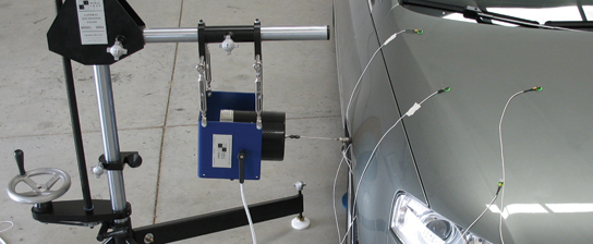

Setting aside the other design requirements, as far as axle noise is concerned, it takes three things to get axle noise. A source of the vibration to generate the noise, a path for the noise to take and a responder – or speaker – to make the noise audible to the driver.
The sources of the noise can come from the gear meshing but can also come from bearing faults as well. There are different mechanical vibration frequencies that can be the source of the noise depending on what is happening.
There are two paths for the noise to take and the associated speakers: through the suspension into the body that vibrates a body panel or forward into the driveshaft and that set off motions in the driveshaft that travels through the air into the vehicle cabin.
The classic gear noise that drives everyone crazy generally comes from vibrations generated by the first harmonic of the gear meshing that either travel through the suspension into the cabin or into the driveshaft and rings it like a bell. It generally occurs when either accelerating through the 45 – 65 MPH range or decelerating 65- 45 MPH. But not always.
Looking at the driveshaft path first, it is spinning hollow and is now commonly made out of aluminum with various OD’s and tube wall thicknesses depending on the manufacturer. Bare with me here – I’ll try to get to my point quick. It’s supported at one end at the axle and on the other end by the transmission. One end of it has to be able to translate in the vehicle fore/aft direction to allow the rear axle to move in the path dictated by the suspension. It has to take the engine torque, amplified by the transmission gear and sent it through to the rear axle through universal joints. The U joints are optimized to run an included angle between the transmission and driveshaft of no more than 3 degrees and, for best performance, an equal included angle of no more than 3 degrees to deliver smooth rotation from the transmission to the rear axle.
The point is that the driveshaft is allowed to move in its mounting and doesn’t deliver smooth power to the axle. The rotation accelerates and decelerates as the u joint rotates. The ring and pinion don’t mesh smoothly by themselves either. These accelerations / decelerations set up the gear mesh vibrations that forces the driveshaft into various resonant frequencies that you hear depending on the geometry of the tube and amplitude of the acceleration / deceleration of the rotation. The OD, wall thickness and length for a given material determines the bending frequencies and shell modes – or bell ringing – frequencies and the torsional frequencies of the driveline. Changing these dimensions move the resonant frequencies up or down in vehicle speed. Naturally, the OEMs try to increase these frequencies to mask the gear noise by other noises like wind or engine noises that aren’t so annoying or damp out the noise using tuned torsional dampers or inserts in the drive shaft tube. Neither eliminates the source of noise – it just moves the energy around. No free lunches.
The later 4th gen f-body driveshaft had an aluminum driveshaft with a larger OD and had both a tuned torsional damper that was pressed onto the transmission side slip yoke to damp out the torsional resonant frequencies. If you were to tap your knuckle along the axis of the driveshaft, there’ll be spots that will ring and spots that will go thud. Inside the tube, there are inserts to damp out the bending and bell modes of the driveshaft.

It would be interesting to apply sections of Dynamat to the underside of the test sheet to see how it impacts the patterns.
Flat plate in set gauges is one thing, plate formed by stamping has to be an entirely different animal.
Are there sensors that can be applied to plate to measure frequencies?
Thanks for the education!
4mul8ion 09-30-2013 09:26 PM
Thanks. This has been a fun discussion but apologies to 69x22 for pulling the topic of this post not just into the weeds but now through the weeds, through the guard rail and halfway into the corn field.
You're absolutely right. Formed steel is completely different. With different boundary constraints, bends and dimples, you can change the performance of the panel. They test it by having something apply a known force and measure the response using an array of accelerometers to measure the response.
http://www.pcb.com/portals/1/Images/...ages/Modal.jpg
Dynamat has done something to determine the effects of their acoustic material to the patterns. Look at what they say for their XTreme product.
http://www.dynamat.com/technical_spe...at_xtreme.html
I'm not sure what the effective absorbing range it can cover but for gear noise it needs to be most effective in the 300 - 600 Hz range to absorb gear mesh frequencies. That product may only be effective at absorbing lower road noise related frequencies.
