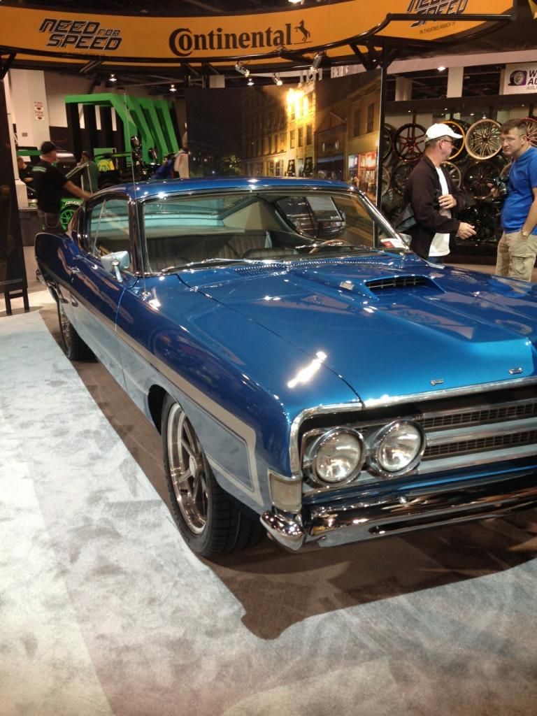

Wish I was that far along.
:cheers:

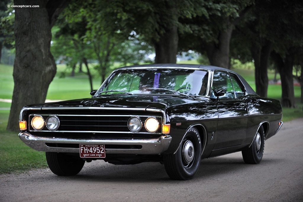

http://i291.photobucket.com/albums/l...ps8d966b6c.jpg
jarhead 11-01-2013 03:15 AM
that black Cobra is "Sinister" looking :thankyou: for posting it!
May have to see if the plotter at work will print it in a large "SHOP" size, lol

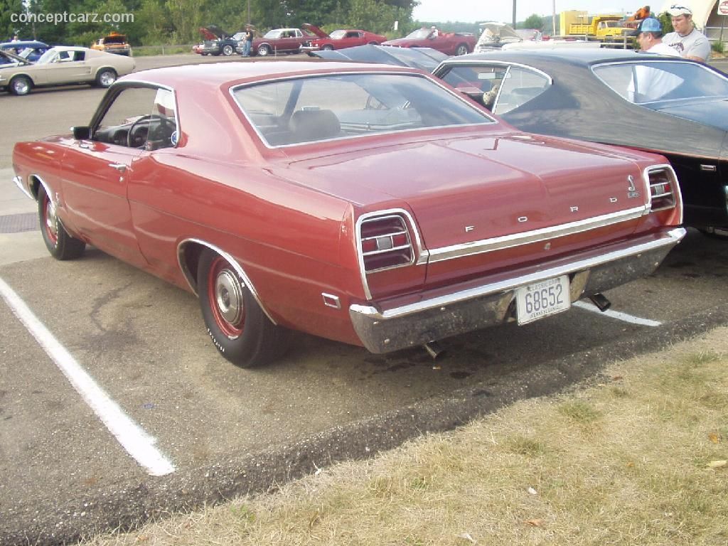

Yep good stuff
:cheers:
http://i291.photobucket.com/albums/l...psc0c1b4e2.jpg
