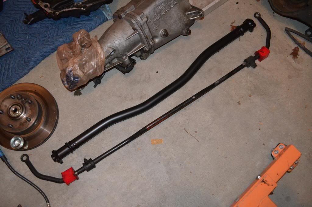

Suspension was delivered last Friday! :ups: It was like an early Christmas!! I know you guys already know this, but MAN is that stuff well built!! I can't wait to drive this car in the spring! I was AMAZED at how big the monster bar was compared to the original sway bar that was on the car! NO WAY is this thing gonna roll at all with that bar on there! haha!!
UNREAL!!
http://i220.photobucket.com/albums/d...ps712b4ed5.jpg

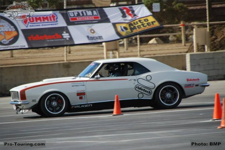

Rod P 12-09-2013 08:49 PM
I know you want it low but a softer spring will just require more preload to hold up the same weight and the ride will suffer I would have recommended 650lbs front and 175lbs rear for a daily street driver with a good ride.....personal opinion from builds I have worked on, the 550 for a 350 SBC with iron heads is to soft
Originally Posted by conester2013 (Post 520021)
I bought the Level 2 Ridetech coil over suspension system with the front muscle bar!! Talking with Kim at MCB, based on my engine and how low I wanted it to sit, she said I'd be looking at 550# springs.
My car runs 750 fronts and 225 on the rear for the track and still rides low
http://i752.photobucket.com/albums/x...psc5667177.jpg
the Muscle bar is a very good bar,I switched to the same one after testing it against 1-5/8 bar I had before
UNREAL!!

Glad you love the kit, I love the swaybar side by side pic, haha! The level 2 is the perfect system for your use and you never have to buy shocks again :trophy-1302:
