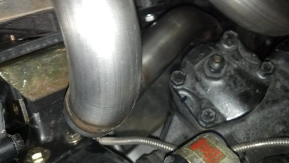

jeremy30thz 01-09-2014 08:27 PM
Stainless Works headers fit great around the steering box too
http://i271.photobucket.com/albums/j...psa816e63c.jpg

jeremy30thz 01-20-2014 07:04 PM
A quick video to show how the Stainless Works headers fit on my car
http://youtu.be/OEOxDvYYhgE

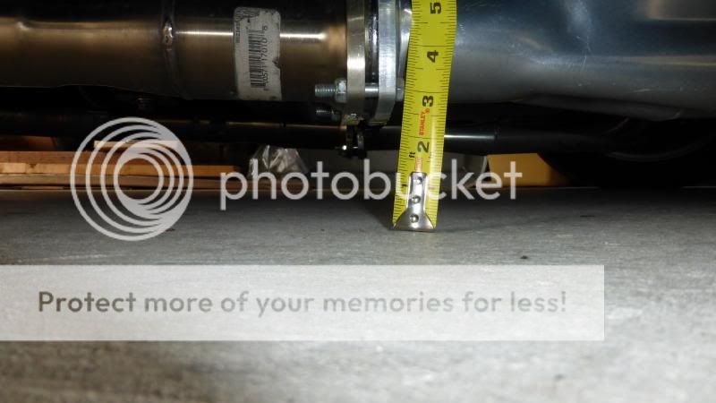

rickpaw 02-11-2014 08:18 AM
Originally Posted by toddoky (Post 526820)
Hey Vince, do you have a picture of how far the collectors of the Dynatech headers hang down below the subframe? I've read multiple comments from users saying they hang too low and I'd like to see it for myself.
Toddoky,
Here are a few pictures of the Dynatech headers I took yesterday for a member here. I'm using DSE mounts as recommended by Dynatech, and as the pictures show, they hang way too low. My car is lowered with Hotchkis 2" drop front/1.5" drop rear.
http://i616.photobucket.com/albums/t...pse9922b91.jpg
http://i616.photobucket.com/albums/t...ps6d94cfaf.jpg
I'm in the market for different headers now.
OBeer-WAN-Kenobi 02-11-2014 09:00 AM
Holy crap those things are low!
