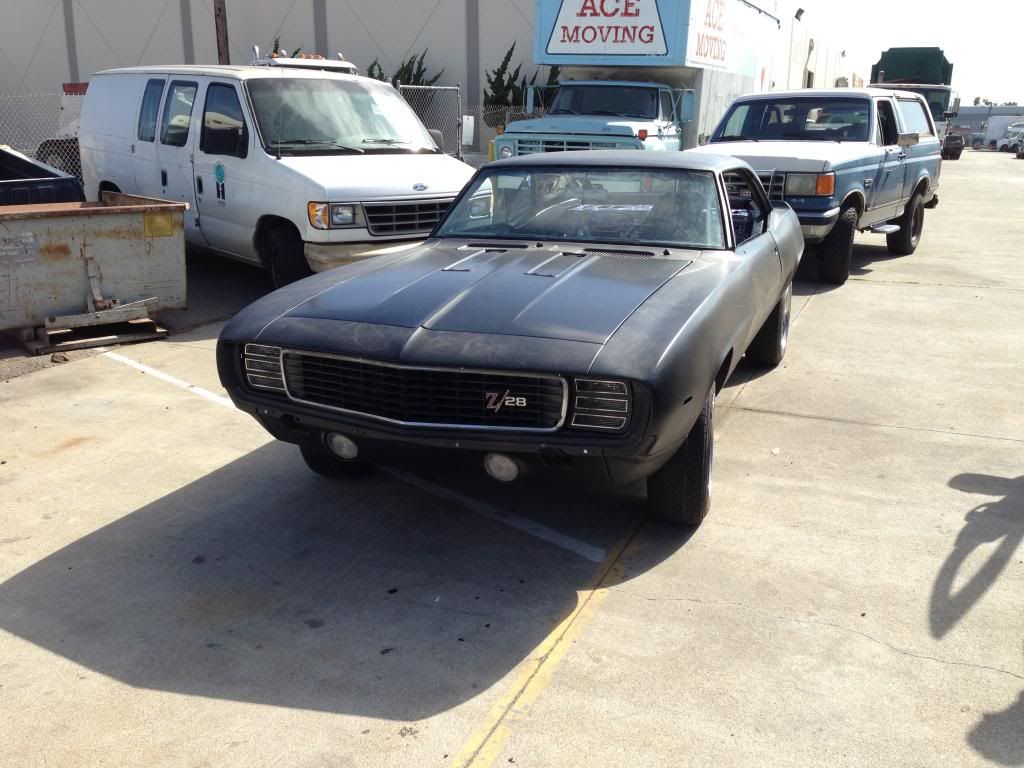

geberhard 01-27-2014 02:10 PM
Anthony great to hear. Back on Mike's note, you can also enter the "tags" manually.
Copy the address of the pic:
http://s1278.photobucket.com/user/69...5a79.jpg.html][IMG]http://i1278.photobucket.com/albums/y513/69greyghost/IMG_3253_zpsd04c5a79.jpg
and add [XXXimg] on the front of the address - minus the XXX
and then [XXX/img] at the end of the address:
[XXXimg]http://s1278.photobucket.com/user/69greyghost/media/IMG_3253_zpsd04c5a79.jpg.html][IMG]http://i1278.photobucket.com/albums/y513/69greyghost/IMG_3253_zpsd04c5a79.jpg[XXX/img]
remove the XXX on both and you will see the picture embedded:
http://i1278.photobucket.com/albums/...psd04c5a79.jpg
