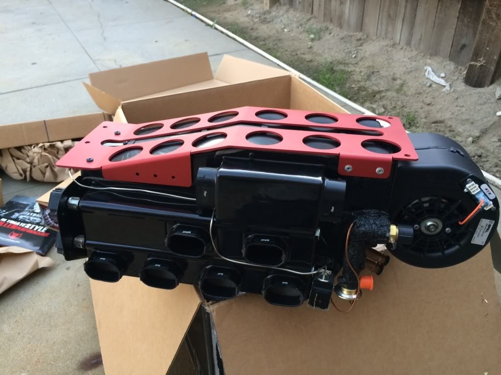

frankv11 01-30-2014 10:29 PM
Another option
Restomod air , just got it. Not installed but quality seems top notch and fully serviceable.

frankv11 02-02-2014 04:53 PM
Originally Posted by 67Rally (Post 532946)
What made you choose Restomod Air over the others? I have seen their banners on other forums, but don't know much about them.
i saw it at SEMA and just liked the overall quality, spal fan, fully accessible for repairs, ( not sealed ), plenty of outlets, plenty of options for control knobs and very smooth operation. just a very sturdy well made product in my opinion http://i1232.photobucket.com/albums/...ps09d7c060.jpg
