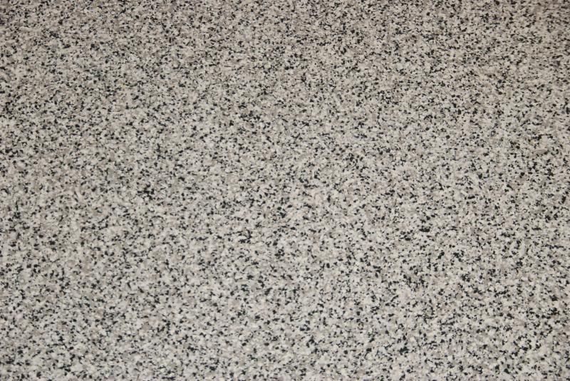

OK guys I usually don't ask for help but I'm at a loss on my new car shop on what to do with the floor. My last shop had U-Coat it floor paint and it lasted about a year then started to pull up.
My shop is 45 by 45 and I'm finishing half of it so 45 X 23 approx. It is 10 year of concrete in great shape 6 inches thick.
So do I:
  • Epoxy coat myself
    Hire a guy to do the Epoxy coat
    Tile
    Stain
    Seal coat
    Leave it raw
I want it nice but I don't want to kill my budget.

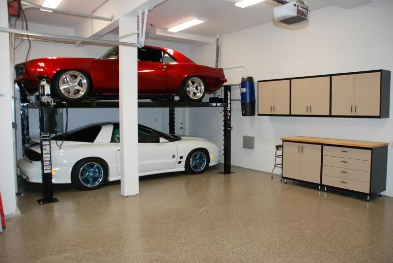

I have Armstrong "Imperial Texture" VCT tile (The name is odd since it has no texture) in my 24x36 shop. It's been down for about 4 years now, I'm quite happy with it. Occasionally gets a weld burn on it but since the color runs through the whole 1/8" thickness, you can take a razor blade to it and scrape it off. It's pretty damn durable, more than I had expected (note how well it holds up to pallet jacks, etc next time you are at your local supermarket.) And it was very cheap, and easy to repair if I ever decide I want to replace any tiles. The pics shown are right after I put it down, I have not done anything to maintain it since, other than to mop once in a while, and it still looks pretty decent, after four years of complete neglect. I think I will move stuff around one of these days and give it a buff and polish, seeing these pics again reminds me of how nice VCT can look, when it's treated well, LOL.
I just couldn't see spending $3k on a high end 100% solids epoxy process like Wolverine, which is about the only type of epoxy system I'd go with, if I were to do epoxy. I think that the concrete polishing/staining/sealing process is another nice option. -Rob

Just happened upon this thread and would like to offer my suggestion, I had a local company install this finish in my garage:
http://www.parkplacegarage.net/garage-flooring.html
Apparently it is called: polyaspartic polyurea garage flooring
I am not sure of the construction but the stuff looks unbelievable and is exactly as advertised. Its tough and does not leave tire marks from hot tires. Super easy to clean as well and does not stain.
