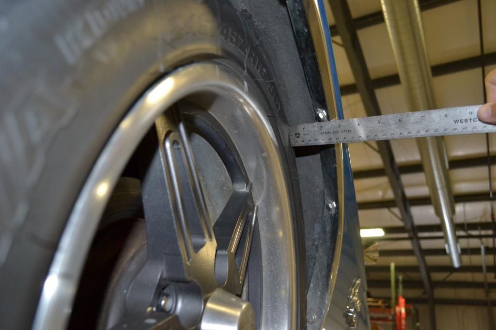

Wanted to give my 2 cents (earned the hard way) on the ridetech tru-turn and the ability to put a 10” 275 tire on a 69 Camaro.
The short version is it doesn’t really fit.
My setup is probably pretty common for people buying this system.
  • Stock subframe
  • ˝” Drop body bushings
  • Full ridetech front suspension with the muscle bar
  • 18x9.5” front wheel w/ 6.25” backspace
  • 265/35 tires
The car has been fully aligned per the Ridetech's specs.
Here is how well it “fits”

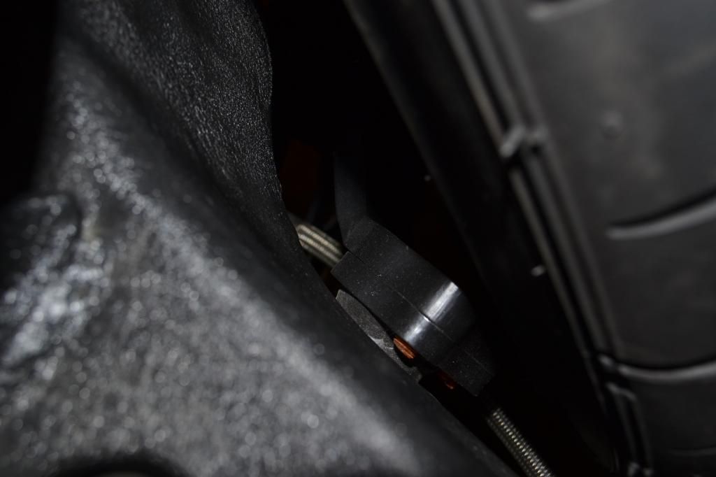

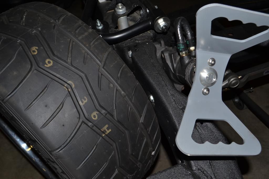

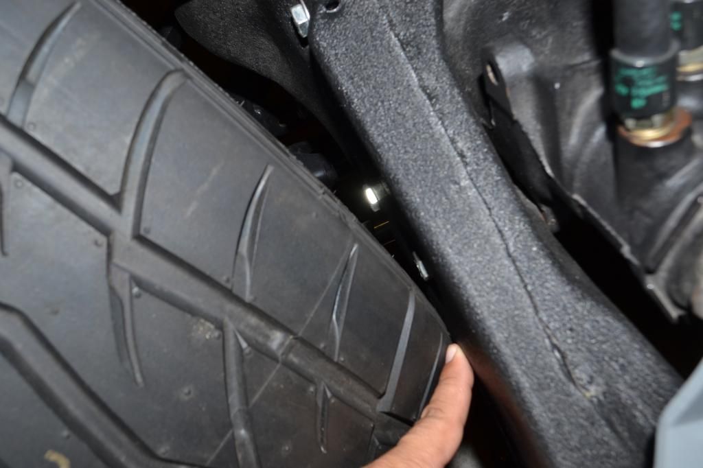

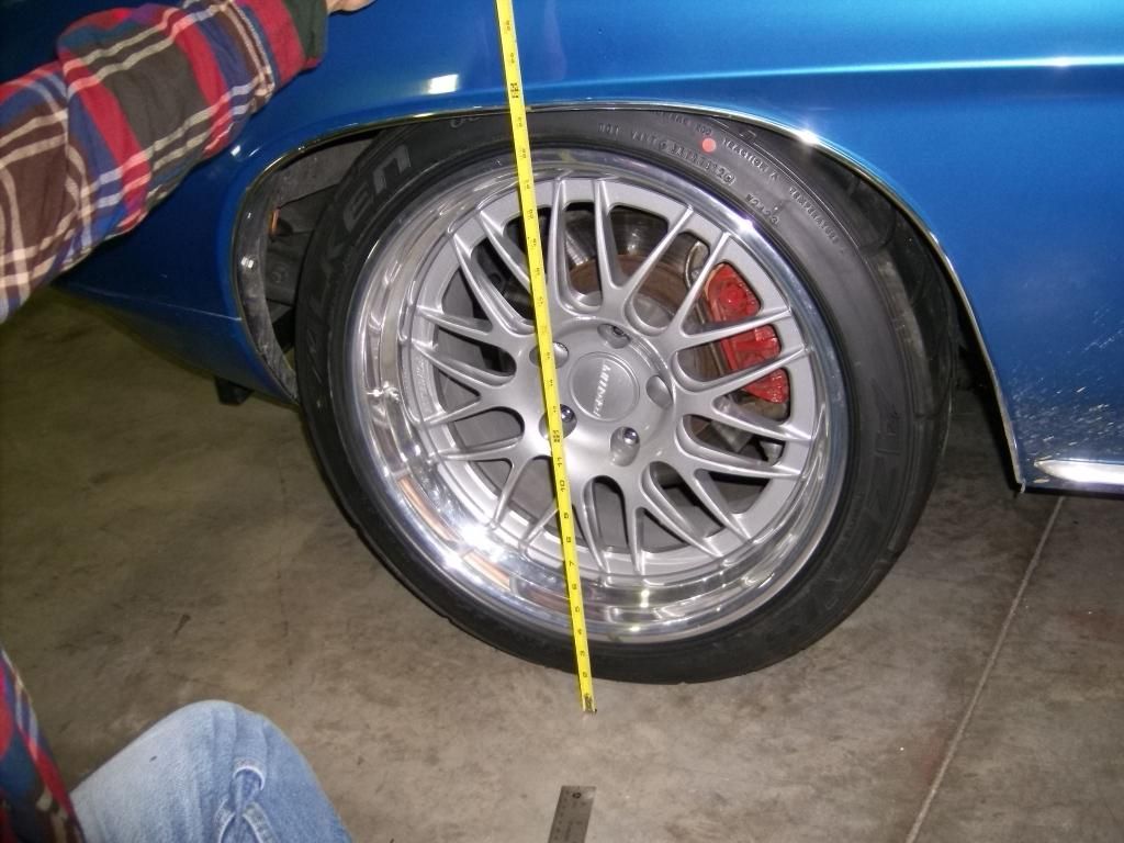

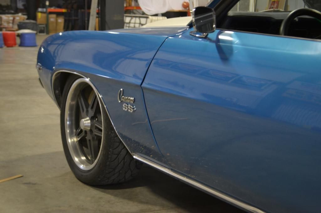

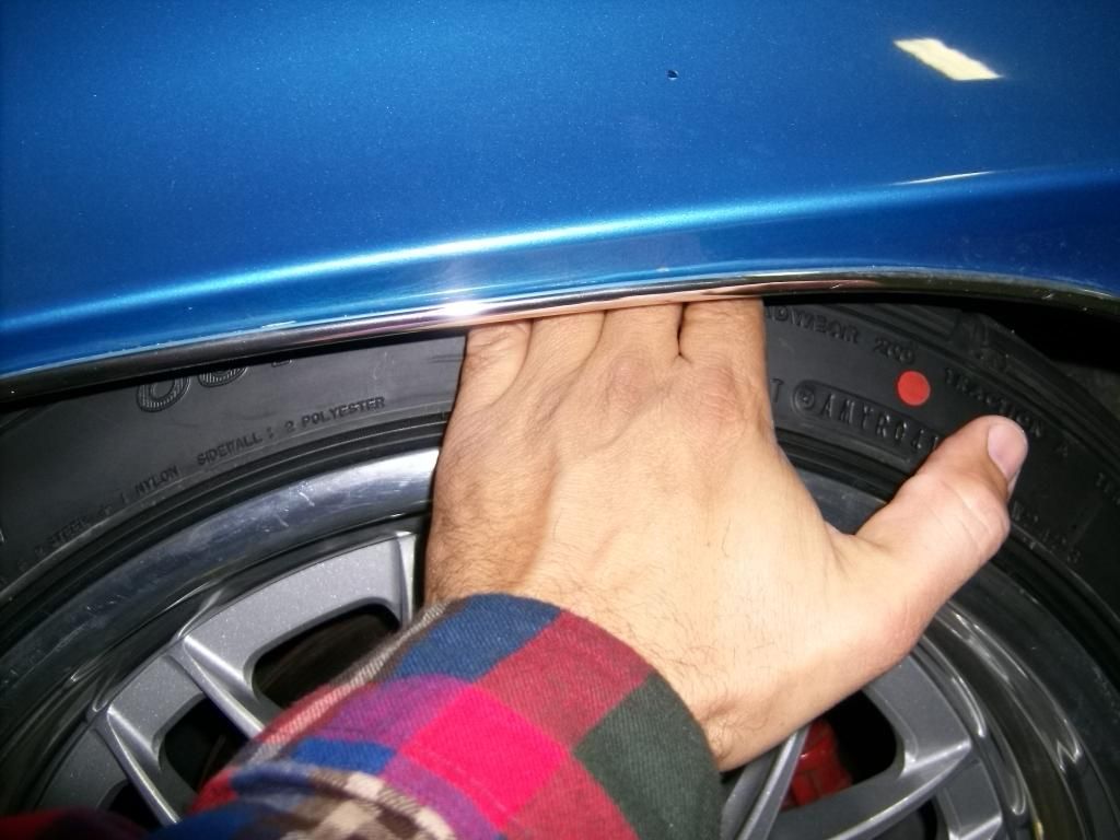

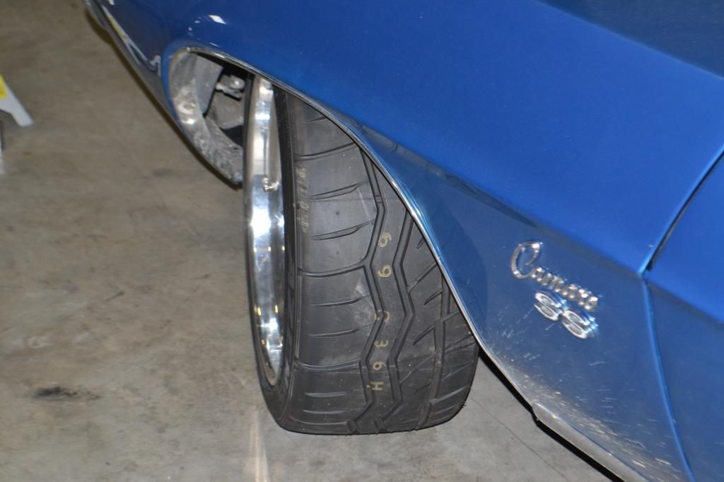

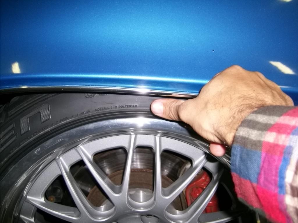

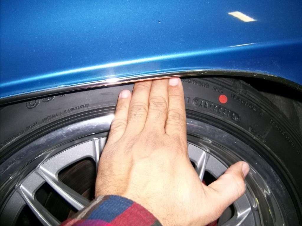

As you can see it really doesn’t fit well. The fender sits on tire when the wheel is turned.

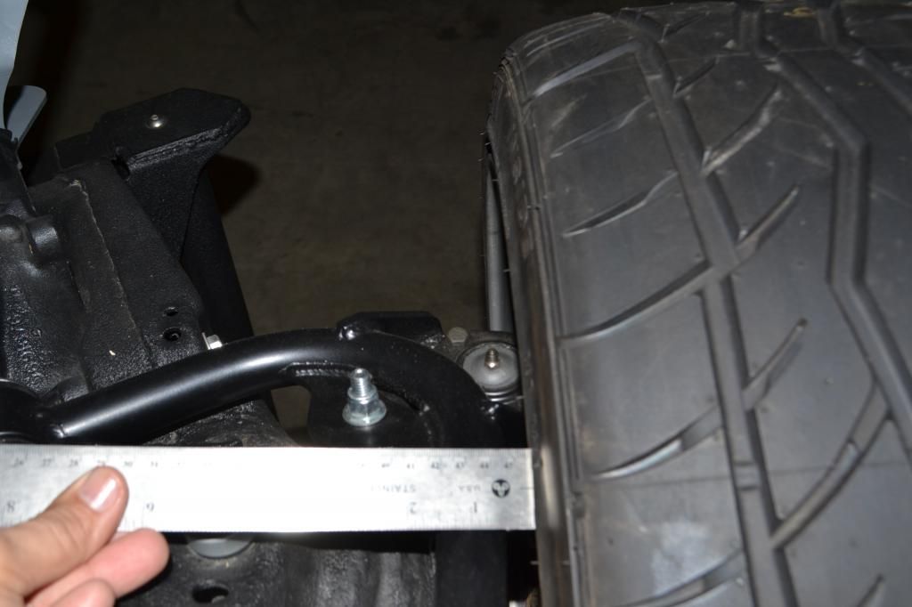

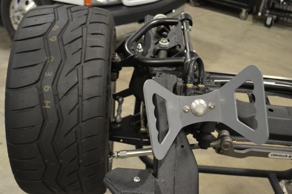

What you can’t see is the rear of the tire hits the frame rail long before I reach lock on the steering wheel. I would probably have to do a 3 point turn when taking a right at a stop light if I left it this way.
I’ve said in another thread and will say it in this thread - I don’t see how you stuff that much tire into the fender well with a stock subframe. There just isn’t enough room to make it work.
The only options I have at this point are:
1)New wheels and smaller tires upfront
2)Raise the car 0.5”-1” and hope I can clear the fender and just live with the mile wide turning radius
With option 2 I think I still may have to get stiffer springs in order to keep the tire from riding up into the fender while turning over a large rise in the road (aka turning into a parking lot)

Your tire hits the outer fender because the 265/45-18, at 27.4" tall, is about 1.8" taller than the 25.6" tall 275/35-18 tire that we (and most others) use. It hits the subframe at full lock because you've selected the wrong wheel back spacing by 1/2". Our printed recommendation for back spacing is 5.75".
If you install the correct parts on the car it will fit just fine.

glr0212 02-01-2014 01:28 PM
1st of all you cant make a hard BS recommendation because you don't know what my track width is. Depending on what brake setup people have the track width can move by as much as 1/2" or more.
2nd, and most important - If you look at the pictures the fender is practically sitting on the tire. adding an extra 1/2 of backspacing in my case and the fender will be sitting on the tire.
Basically I can not move the tire out towards the fender any more.

I clearly do not have room to move the wheels and tires OUT 1/2". The fender is already sitting on the wheel practically. I'll get another picture later to demonstrate this for you.
Also not sure how body height bushings are going to create more side to side clearance in the fender wells.

Won't half height bushings tuck the tire further into the fender and aggravate the problem?
What about adding a litte more camber?
Don
Vince@Meanstreets 02-01-2014 06:01 PM
Yep, 5.750 would put you into the fender.
I'd go -1.8 on the camber and see what you have to do to keep your turn radius. Looks like its in the sway bar hardware already.

MarkM66 02-02-2014 05:57 AM
You're right, there's only so much room to fill. To get it off the fender, you need more backspacing, but that makes your frame clearance worse.
Looks like the wheel is already in negative camber. More would help, but you can't go to far.
The only way you're going to make this set up work is to raise the car a little, and notch the frame where the tire hits.

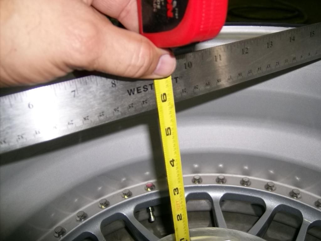

Could you post pic of the tire size? I'm not finding a 265mm tire in a kdw.
The standard height subframe bushing will serve to raise the body/fenders by about 1/2". You can simulate by adjusting the coilovers up to test fitment.
Also, additional camber will help fender clearance, help turn in for autocross ing, and will not significantly harm tire life

glr0212 02-02-2014 02:19 PM
https://dl.dropboxusercontent.com/u/...202_153943.jpg
Tire size.
I bought the tire a year or more ago. They don't make the 335 tire anymore either i believe.

glr0212 02-04-2014 06:56 AM
here is another picture of my tire clearance from below with the wheels straight -
https://dl.dropboxusercontent.com/u/...202_154229.jpg
https://dl.dropboxusercontent.com/u/...202_154148.jpg

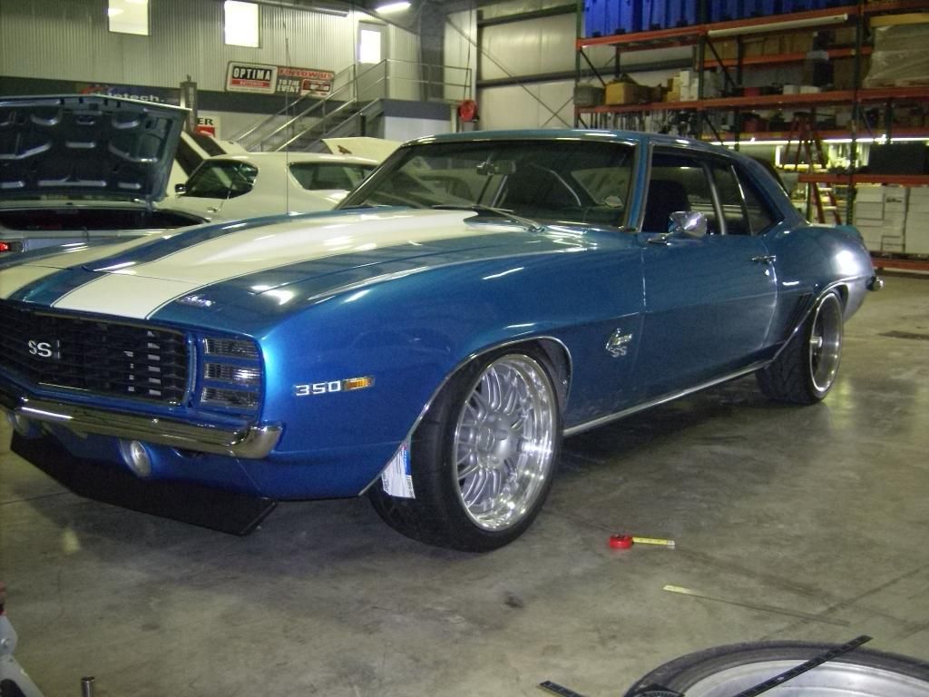

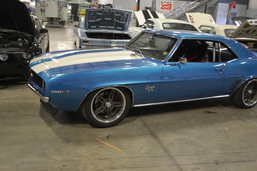

garymac69 02-04-2014 09:32 AM
18x9" with 5 3/4" B.S.
1 Attachment(s)
I have had the Truturn system on my '69 for over a year and went with 18x9" with 5 3/4" B.S. and 275 KDW tire. Before ordering wheels and tires I did a test with a borrowed 18x10" 5 3/4" B.S. and 275 tire and decided there was no way it would fit well without some modifications to the outer fenders. My car was already painted and been driven for many years so that was not an option. At my present ride height, the tire sometimes rubs the paint off at the top, bottom area of the fender while turned full lock and while moving over bumpy surfaces (like parking at a field). You can not see the damage except getting down on the ground and looking up at the fender lip. I will have to touch up the paint a couple times a year if I keep it this height. About half the time I do have to make 3 point turns while parking. I have only neg 0.5 camber now and plan to get it realigned to about neg 1.5 in a couple months, so that might help some. Also I removed those top fender bolts about 18 years ago and the fender has not fell off yet.
Gary
garymac69 02-04-2014 04:26 PM
DSE cars
I will also mention that while at the Southern Slam Track event last year, I asked Stacy of DSE to turn the wheel full lock on her '69 Camaro test car. (The car now has a 10.5" wheel and 285 tire) The tire tread touched the top of the fender. And on another DSE equipped Camaro that had a lower ride height, I noticed some slight fender damage (bent) in that area.
My car presently has 1/4" between the tire tread and fender at full lock with no one in the car.
cwylie 02-05-2014 06:54 AM
Mine sits about the same height as yours and I am running the same size tire on a 18x9 5.25 backspace so I should be further from the frame and closer to the fender than you. I still need to finish my front body panel alignment but I am going to have to mod the fender for sure. I really wish ridetech would put out a little better info on what will and will not fit with the tru turn setup. Looking back if I was not so commited with the brakes and everything I would have gone with an aftermarket subframe.
garymac69 02-05-2014 12:41 PM
I agree that Ridetech should modify the info to recommend an 18x9" unless fender modifications are made. Right after I ordered the TruTurn system for my '69 I got to see their '67 48-hour Camaro at the RTTH event. While lying on the ground looking at the setup it appeared the clearances were really tight on that car. That made me worried about fitment on my '69. I'm lucky I was able to borrow a wheel & tire for testing. I have a friend about 90% done with a '69 and he installed the TruTurn system . After looking at my setup he went with 6" B.S. on an 18x9. If he has too much loss of turning radius, he says he might section the frame.
I would like to crawl under that yellow '69 that Ridetech just built for Goodguys to see how they got a 10" on there. Too bad they don't provide detailed pics and instructions on the mods.

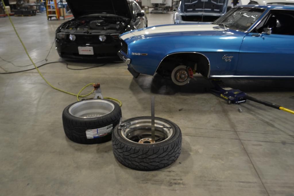

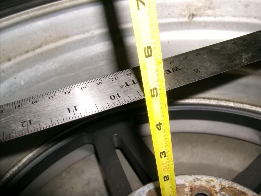

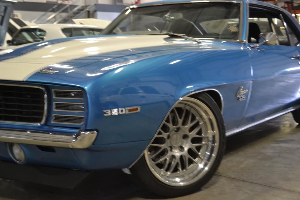

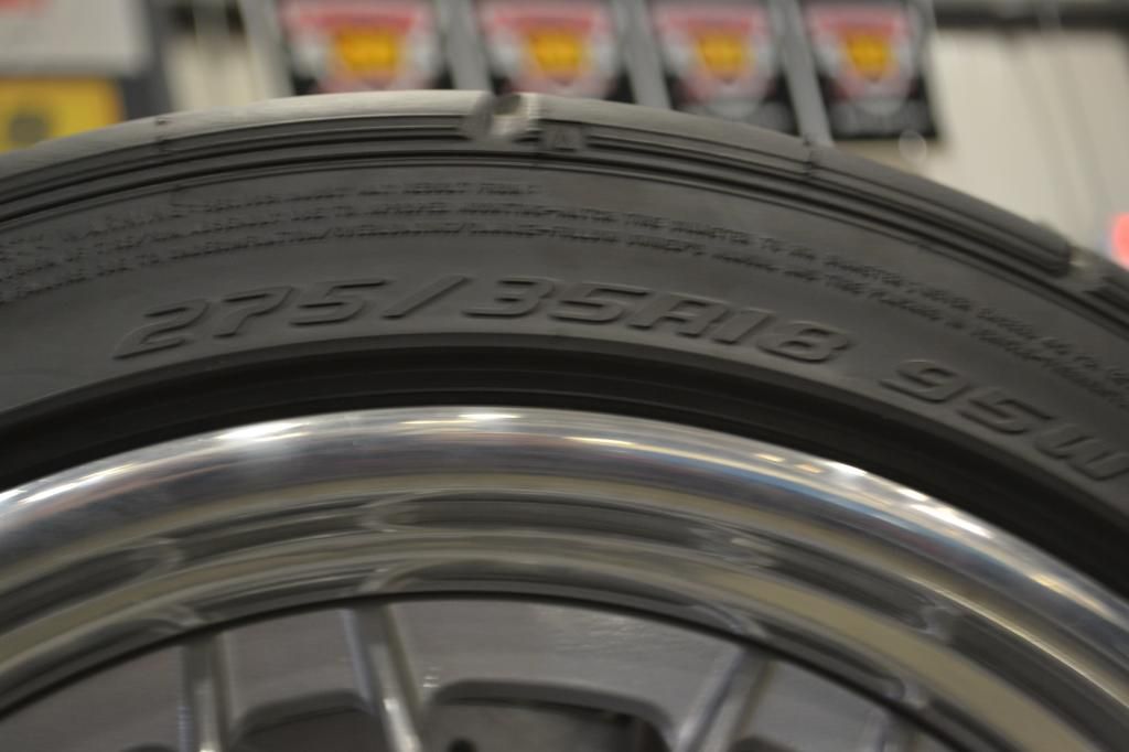

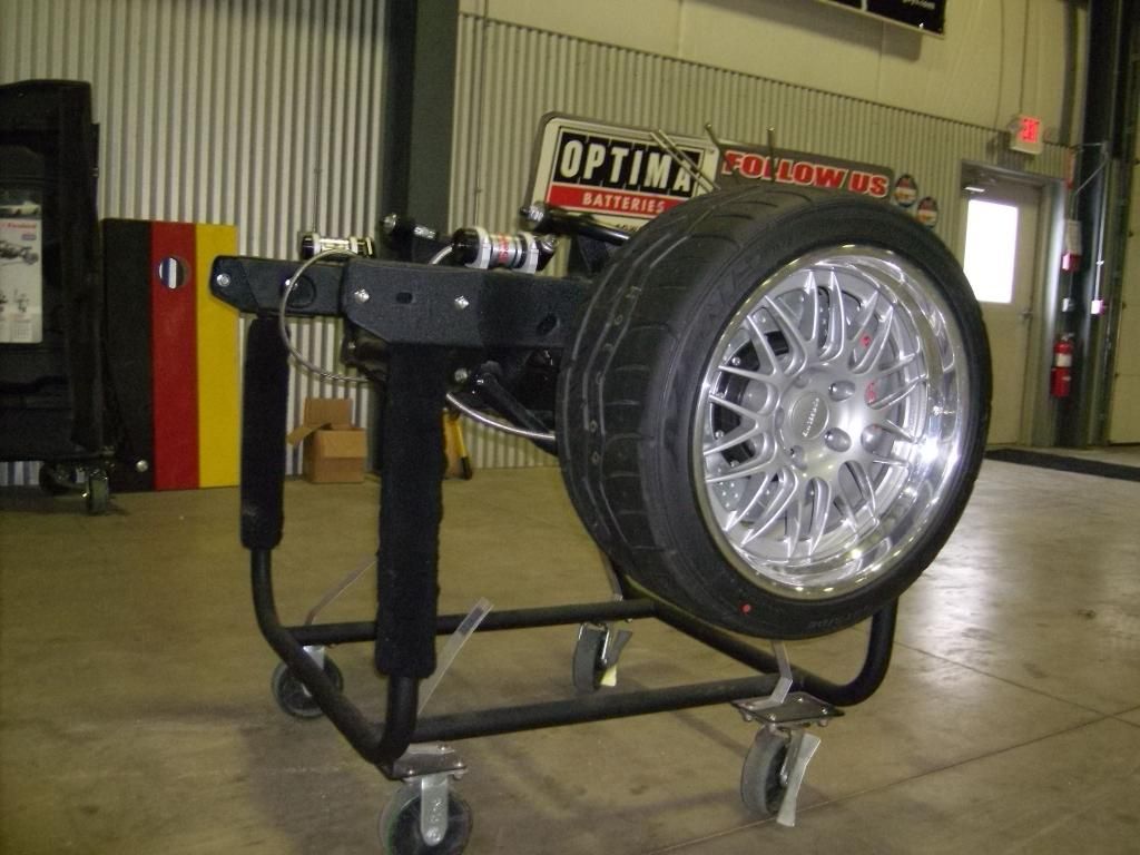

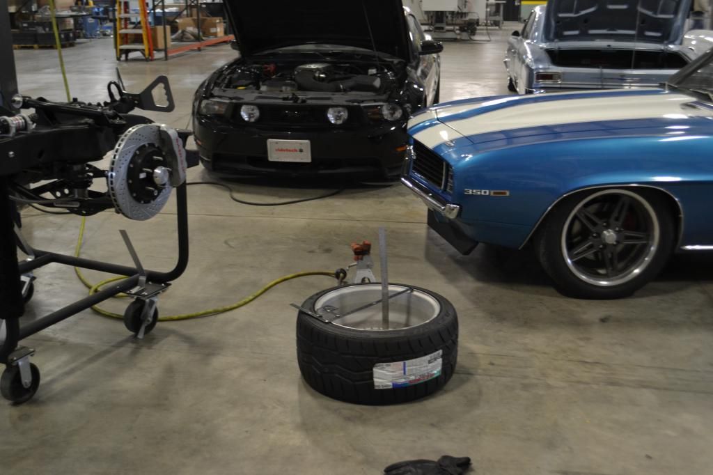

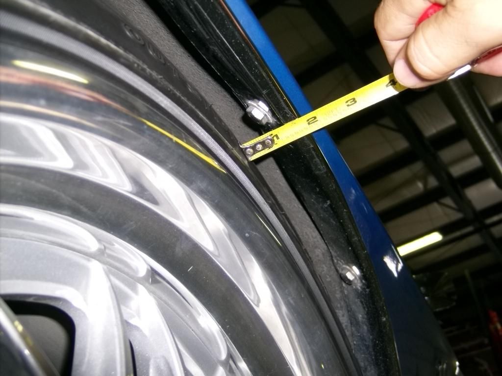

Rod P 02-06-2014 12:59 PM
I did a little leg work for you guys today and just want to see if any of this helps you and other builders but first I will help with the last few request and these answers come fromthe Ridtech website on the tru-turn FAQ section
Can I really fit a 10" wide wheel with a 275mm tire?
Yes! There is no modification necessary to the subframe, but you WILL need to create clearance on the inner wheelhouse and the outer fender lip. These modifications can be as simple or elaborate as your talent and ambition dictate, but if done nicely, are all but invisible.
Will I sacrifice any turning radius?
No loss of turning radius! An 18x10 wheel with 5.75" of backspace and a 275/35-18 tire will lightly kiss the framerail or the swaybar at full lock under full compression...just enough to clean the paint off...no damage to the wheel, tire, or other components.
one of the guys here at the shop has a Daily 69 with all the suspension gear and stock fenders, chrome fender trim, and a low ride height and he runs 8 inch wheels, so he pulled it in the shop and I used a recommended 18x10" rim with 5.75 back spacing and a new 275/35/18 to check fitment, right off our shop Tru-Turn display, here's a few pictures and I hope these helps
first the tru-turn setup with the 18x10 rim for reference
http://i752.photobucket.com/albums/x...ps3049df04.jpg

lock to lock views of tire to frame clearances left and right
left turn first
http://i752.photobucket.com/albums/x...psa3a1a4b3.jpg
here is the tire barely touching the frame under full lock
http://i752.photobucket.com/albums/x...psb6e1f067.jpg
then right tire just kisses the sway bar under full lock
http://i752.photobucket.com/albums/x...pse88320b5.jpg
and over a half inch away from the arms
http://i752.photobucket.com/albums/x...psecf3fd13.jpg
next we bring in the victim! a nice 69 camaro with stock unmodified fenders, with chrome fender edges, and all the bolts in place
http://i752.photobucket.com/albums/x...pse9710d04.jpg
here you can see the 8 inch rim and all the clearance
http://i752.photobucket.com/albums/x...ps1bd86f6b.jpg
http://i752.photobucket.com/albums/x...ps056949f1.jpg
now to measure back spacing as a prof of life for everyone
http://i752.photobucket.com/albums/x...ps4cff541b.jpg
http://i752.photobucket.com/albums/x...ps09af6fcb.jpg
it was hard to read the silver ruler with the camera flash so we switched to a standard yellow tape to show the 5.75 backspace
http://i752.photobucket.com/albums/x...psba053026.jpg
Rod P 02-06-2014 01:00 PM
and I measured the 8 inch rim and it was a 5 inch backspace(it read 4-7/8 in reality)
http://i752.photobucket.com/albums/x...ps43dc7d24.jpg
ok now to install the rim, and then I moved the car around the shop to settle the suspension to actual ride height
http://i752.photobucket.com/albums/x...ps3f3cc973.jpg
now left and right turns for clearance
http://i752.photobucket.com/albums/x...ps3b7a625c.jpg
http://i752.photobucket.com/albums/x...ps27674322.jpg
so the question is how much space is there?
http://i752.photobucket.com/albums/x...ps0bdab1df.jpg
enough my fingers fit
http://i752.photobucket.com/albums/x...psa08eccbe.jpg
http://i752.photobucket.com/albums/x...ps9ca10ddf.jpg
roughly about a thumbs thickness above the rim
http://i752.photobucket.com/albums/x...ps7dcf9a22.jpg
or here is the actual ride height numbers ground to fender edge 23-3/8 inch
http://i752.photobucket.com/albums/x...psf09cdb22.jpg
http://i752.photobucket.com/albums/x...psae5682dd.jpg
Rod P 02-06-2014 01:02 PM
I hope this helps, after we used the car I would roll the fender edge and remove the large bolts or change them to button heads and you shouldn't have to do to much abuse to the inner fender
Vince@Meanstreets 02-06-2014 02:34 PM
2 Attachment(s)
every car is different...I still say its all in the alignment..btw....18x10 6 7/8" back space 285/30/18 23.5" fender height -.8 camber 5.6 degrees on caster on a 71 Nova.
Modifications, button head fender well bolts and tru turn. Steering components are 1/8" away from wheel hoop inner step. Fully cleared on a smooth hoop.
Ok, whats up with the bump stops guys.

I know the Camaro and Novas are different, but I run 18x9.5" with 275/35/18 with complete Ride Tech set up. I ran the wheel/tire combo off the 48 Hour Camaro at RTTH's and they do fit.
