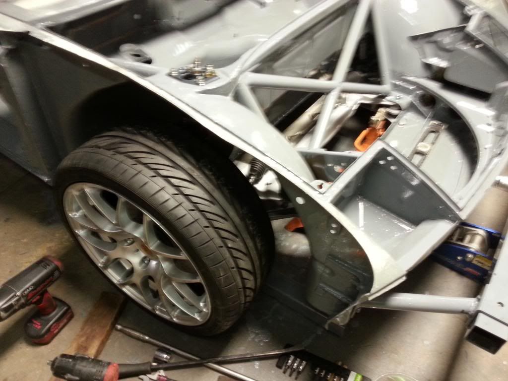

This picture is before I blasted and painted up parts and after. Needless to say lots of this had to be made custom.
http://i60.photobucket.com/albums/h3...bility/970.jpg
http://i60.photobucket.com/albums/h3...223_163633.jpg
http://i60.photobucket.com/albums/h3...26_2142262.jpg
http://i60.photobucket.com/albums/h3...227_212443.jpg

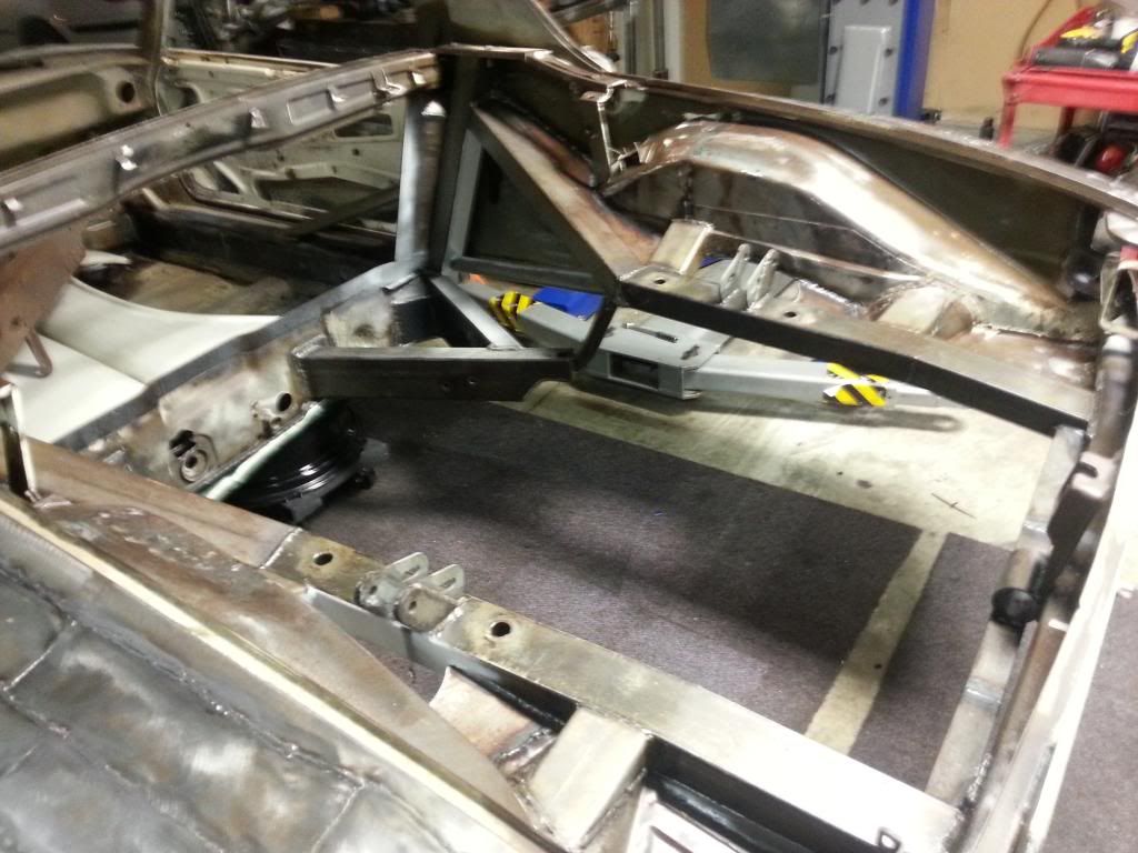

This is a look at the way the 996 suspension was fitted
http://i60.photobucket.com/albums/h3...bility/110.jpg
http://i60.photobucket.com/albums/h3...bility/104.jpg
http://i60.photobucket.com/albums/h3...ility/0562.jpg
http://i60.photobucket.com/albums/h3...223_193012.jpg
http://i60.photobucket.com/albums/h3...225_232601.jpg
http://i60.photobucket.com/albums/h3...lity/022-1.jpg
http://i60.photobucket.com/albums/h3...bility/060.jpg

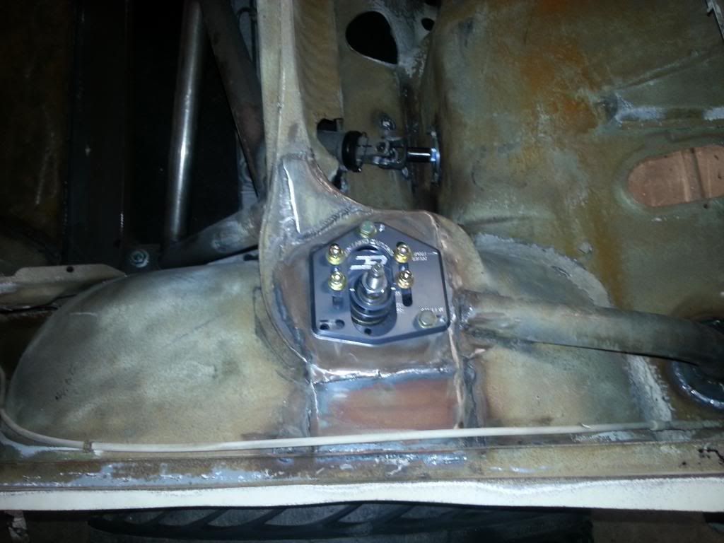

Great project! Really like the camber plates. :thumbsup:

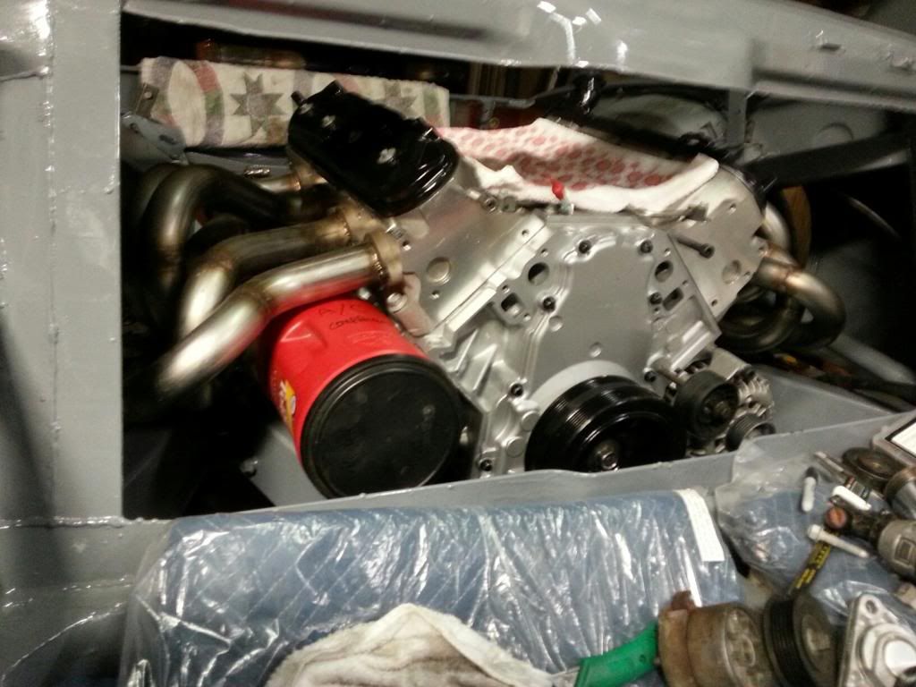

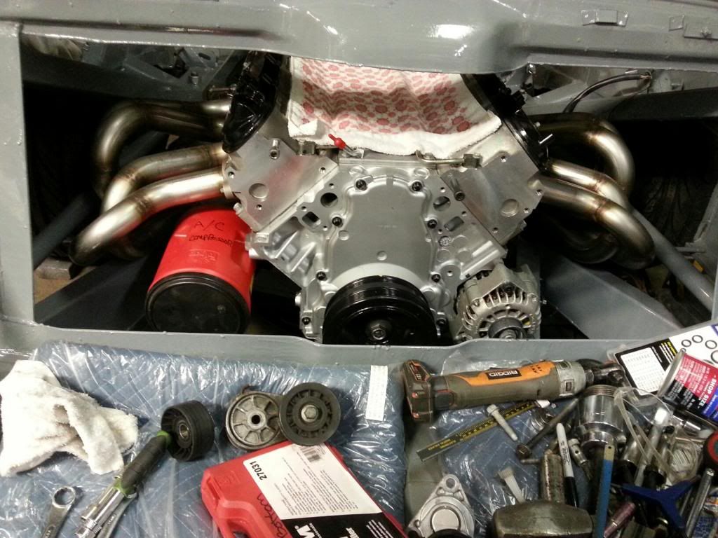

driveability 02-28-2014 10:09 PM
Moving along building this project, it seems almost endless. I am getting the engine together and building the cooling system. I've got the 914 wiring harness installed and have the LS1 unit ready to install. I'm going to use 2 Spal 12 inch fans. I think they seem small but they say each is rated at 3,000 cfm that's a total of 6,000 cfm. I'm going to call Spal and ask them about this spec. to be sure. I'm also looking at a clutch, its a pricy unit because I have to use a Porsche 911 unit.
http://i60.photobucket.com/albums/h3...19_resized.jpg
http://i60.photobucket.com/albums/h3...45_resized.jpg
http://i60.photobucket.com/albums/h3...54_resized.jpg

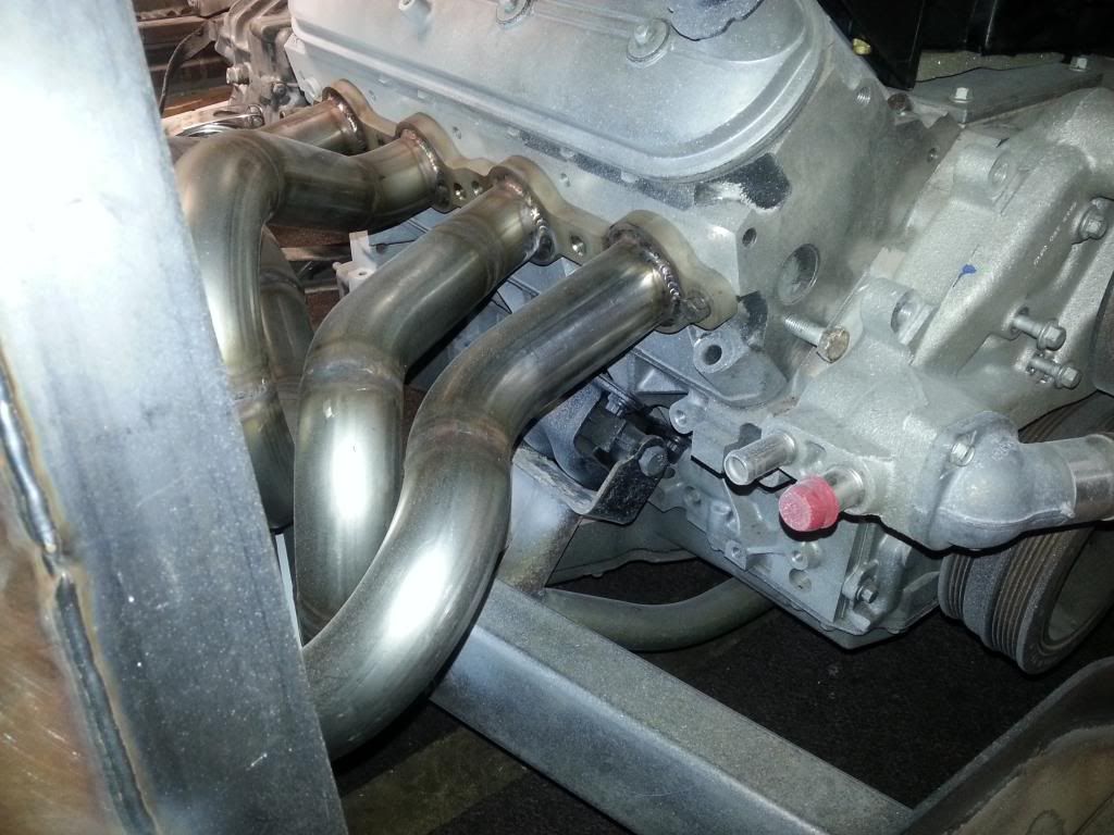

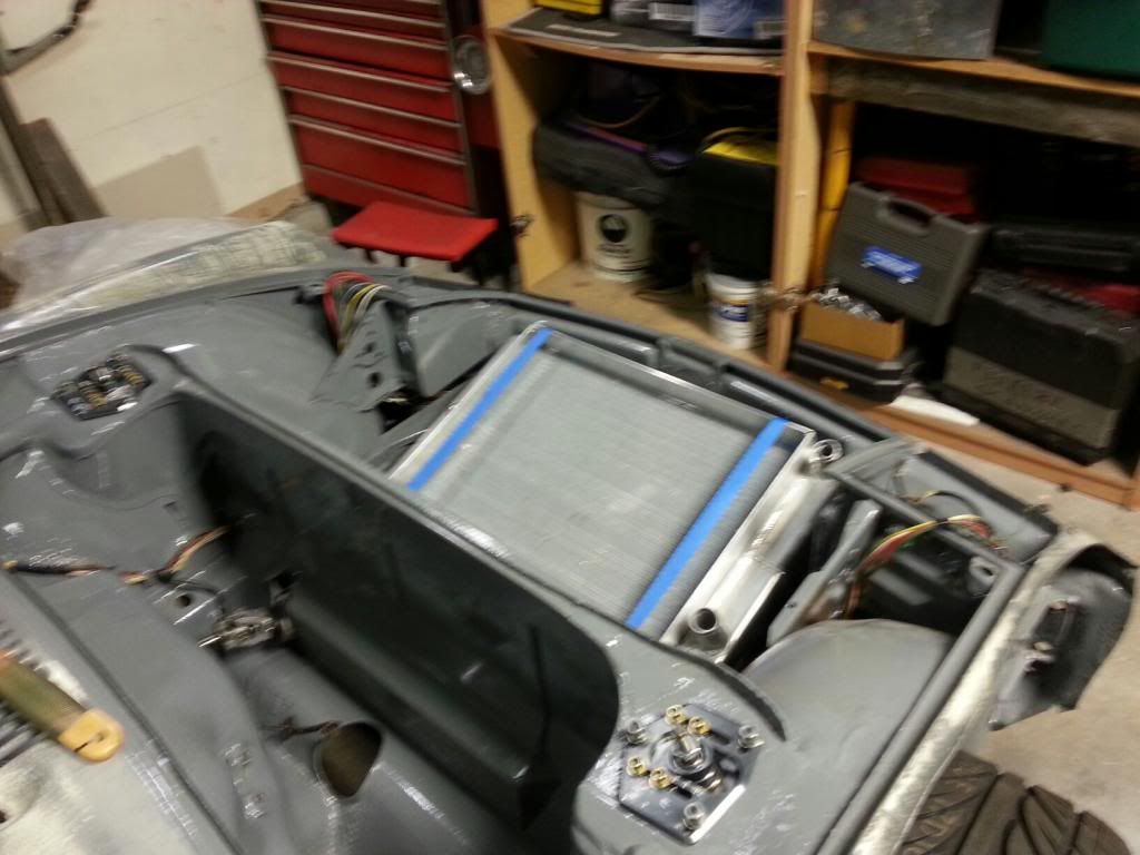

I'm waiting for my radiator cooling fans to arrive, so I decide to mount the electric power steering pump. This pump is found on a 90 - 93 Toyota MR2, built of all steel/metal and since I used it on my last V8 914 & had success in the past. I built my former cars P/S system using a VW Jetta steering rack and made my tie-rods using a mix of Porsche 930 parts and Jetta. Here some real engineers designed this system (Porsche inc ) since I'm basically using 2004 Porsche 996 suspension. I may need to tweak the pressures to get the desired steering feel. I also picked up some great relays (transit bus) to handle the amperage load. I tried using starter relays on my last build and they just melted down quickly and the factory ones aren't designed to run fulltime and roasted. I also will incorporate a cooler to handle the extra heat because of the 100% duty cycle.
http://i60.photobucket.com/albums/h3...10_resized.jpg

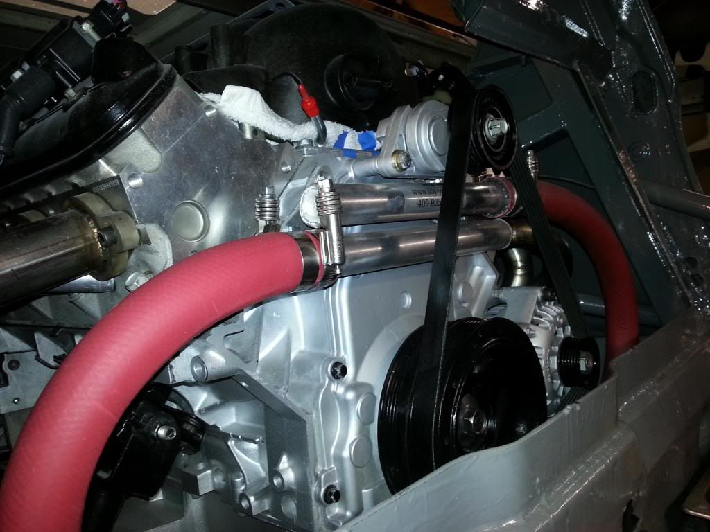

driveability 05-02-2014 12:40 AM
Here is a picture of the engine and the water pump manifold I picked up. It is a pain to install because of real hard to get to fasteners but worth it.
http://i60.photobucket.com/albums/h3...429_221015.jpg

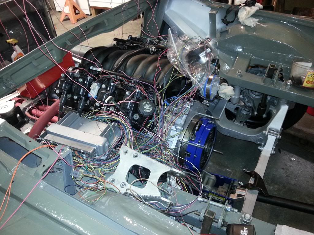

I'm wiring the engine, really quite easy but time consuming.
The price of a built harness can be pricy.
http://i60.photobucket.com/albums/h3...9_205438-1.jpg

The blue one is backwards.

In this picture of the blue clutch pressure plate I forgot the starter ring gear is bolted to the pressure plate hold down bolts. I forgot to install it !!!!!! Did notice it prior to installing the transmission :trophy-1302:

I was looking at that too but I noticed it must be pre 2003.
then that would be what we like to call a "mock up".

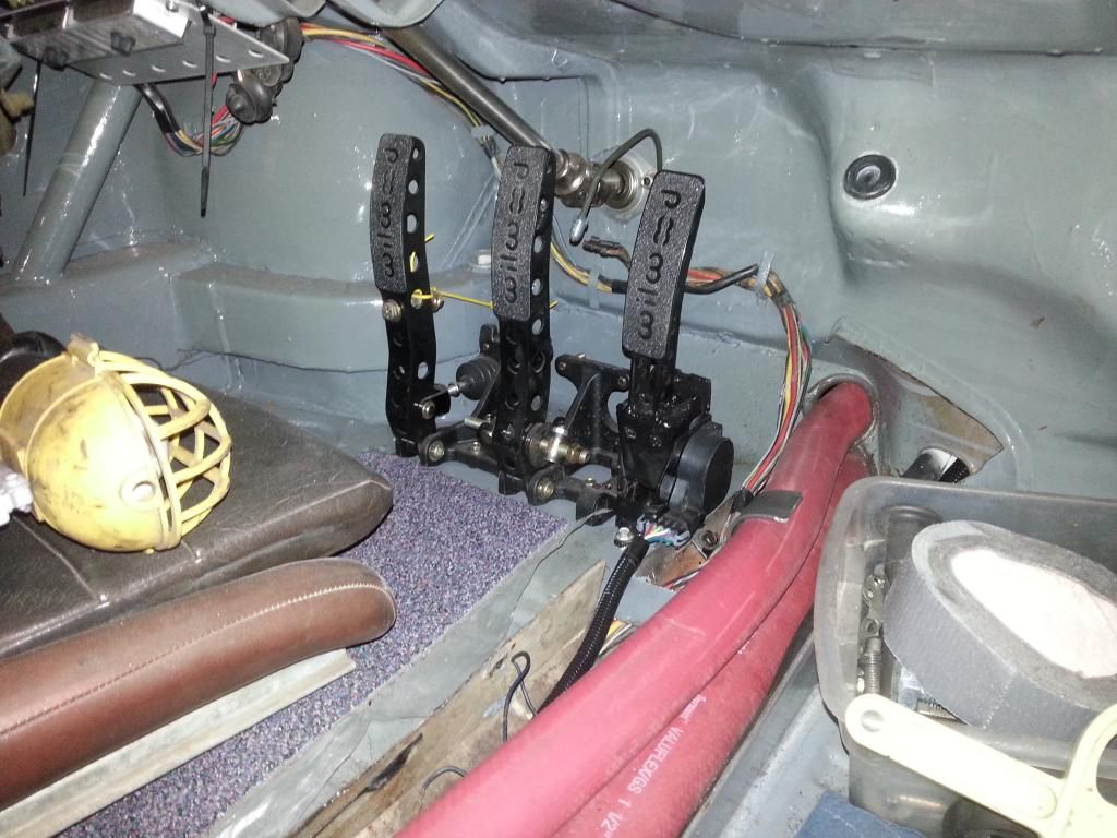

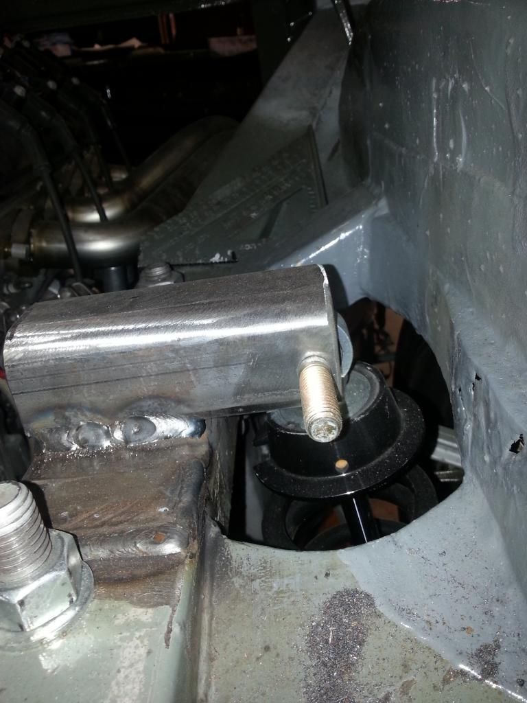

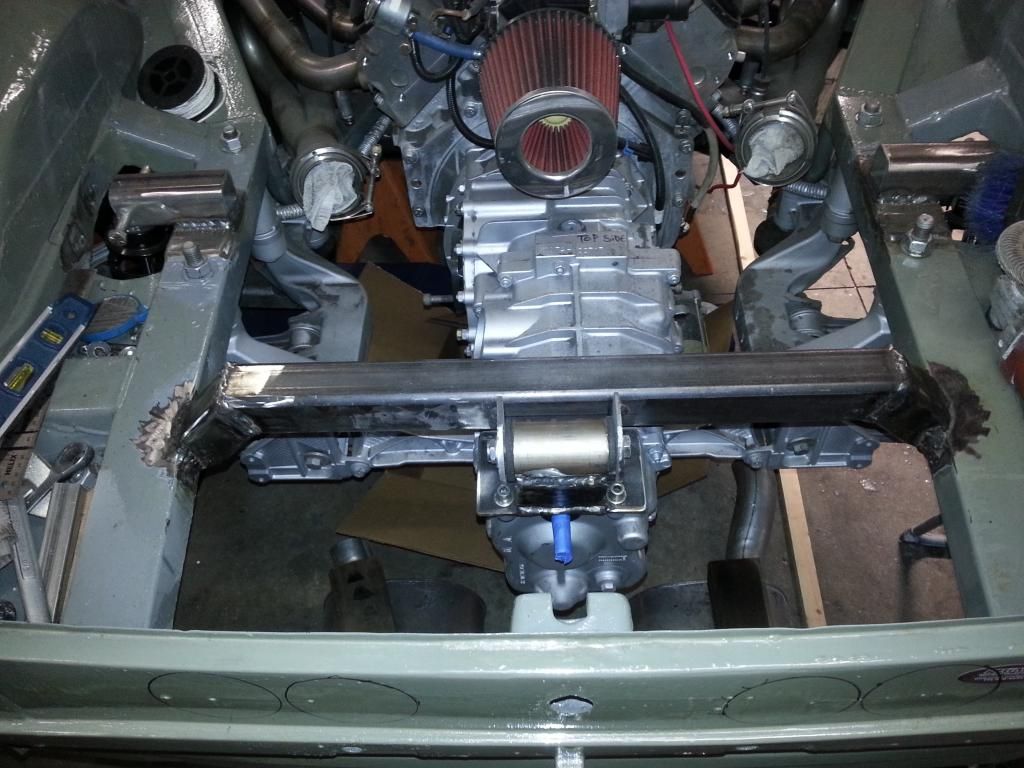

driveability 12-25-2014 10:20 PM

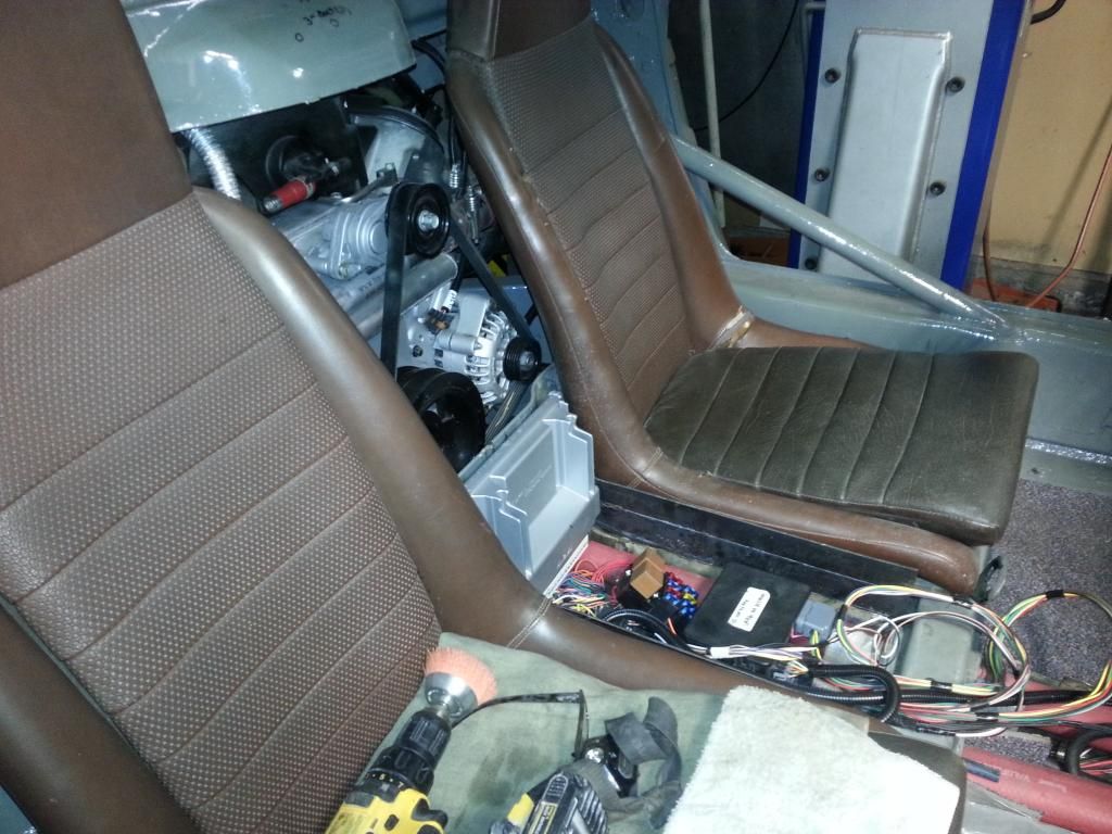

http://i60.photobucket.com/albums/h3...205_164053.jpg
Did some changing around of the trans. mount, and have a few more parts installed.
http://i60.photobucket.com/albums/h3...212_193616.jpg
http://i60.photobucket.com/albums/h3...215_221923.jpg
http://i60.photobucket.com/albums/h3...130_172512.jpg
