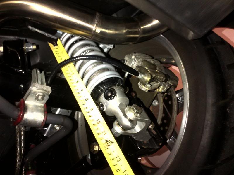

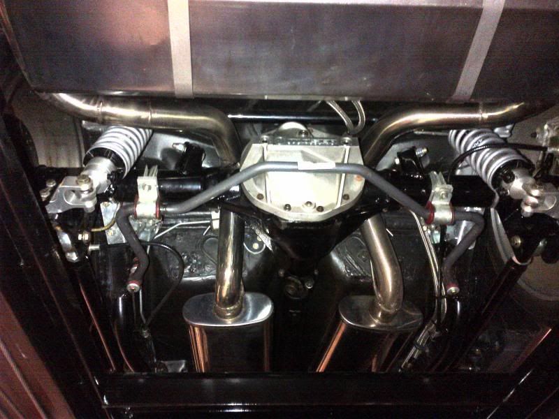

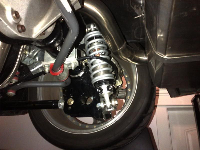

Chassisworks 03-05-2014 01:40 PM
Hi Larry,
Here's some pictures for you to check out. Hopefully you're running the Splined Billet Arm anti-roll bar as the sliding-link version makes it nearly impossible to go over the top. Shoot me an email if you need more pictures and I'll hunt some pics down for you on my hard drive.
~Carl
https://scontent-b.xx.fbcdn.net/hpho...57123286_n.jpg
onevoice 03-05-2014 05:15 PM
In this post, you can see pictures of mine:
https://lateral-g.net/forums/showthread.php4?t=24447
If you go over the axle, placement has to be PERFECT, to prevent hitting at full jounce. Going under is really far easier, and the shocks will run out of travel before letting the axle droop far enough to hit the pipe. My mufflers don't hang any lower either, they are at the same height they were before the glink was installed.

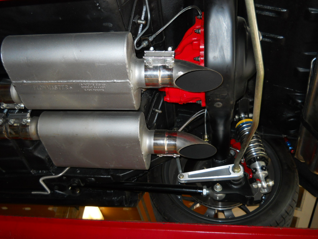

TheJDMan 03-14-2014 07:46 PM
This is how I ran my exhaust. Very simple. I have had to remove it several times and this setup is easy to put on and take off.
http://hayes-ent.com/steve/images/Ca...maro%20071.jpg
