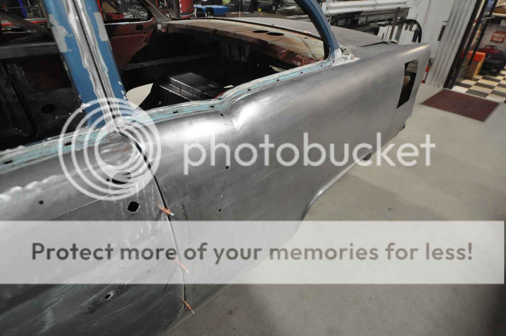

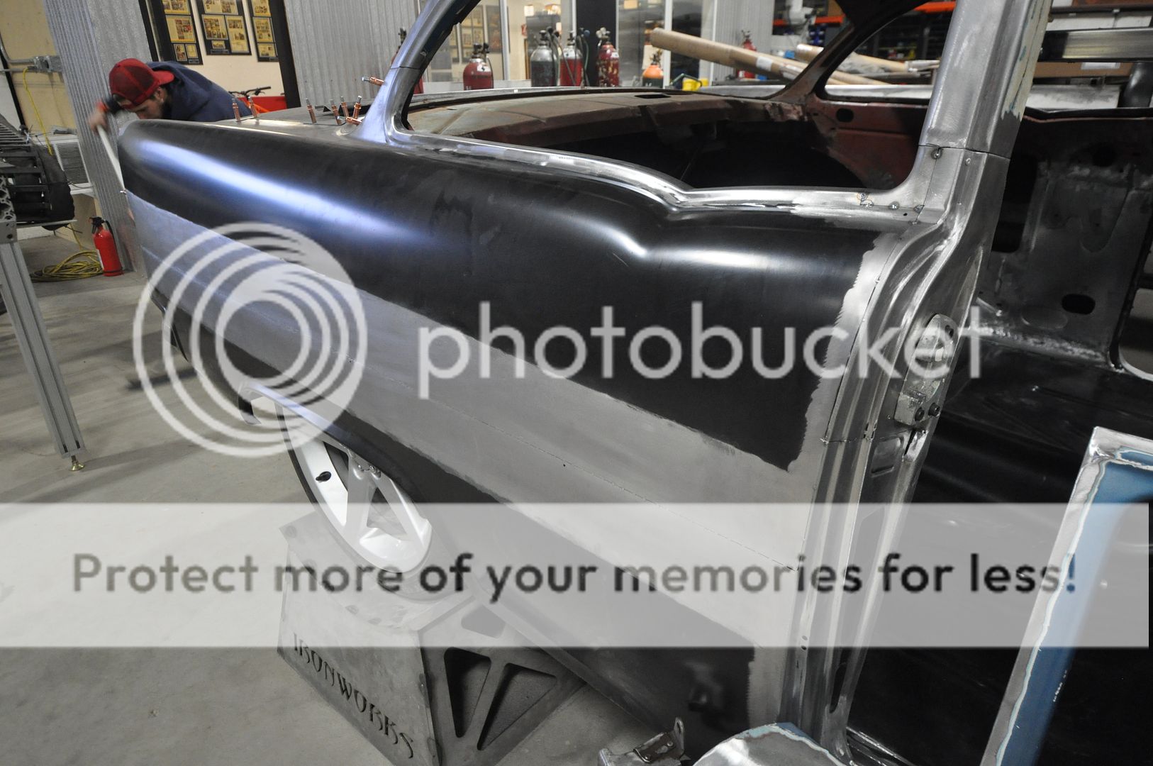

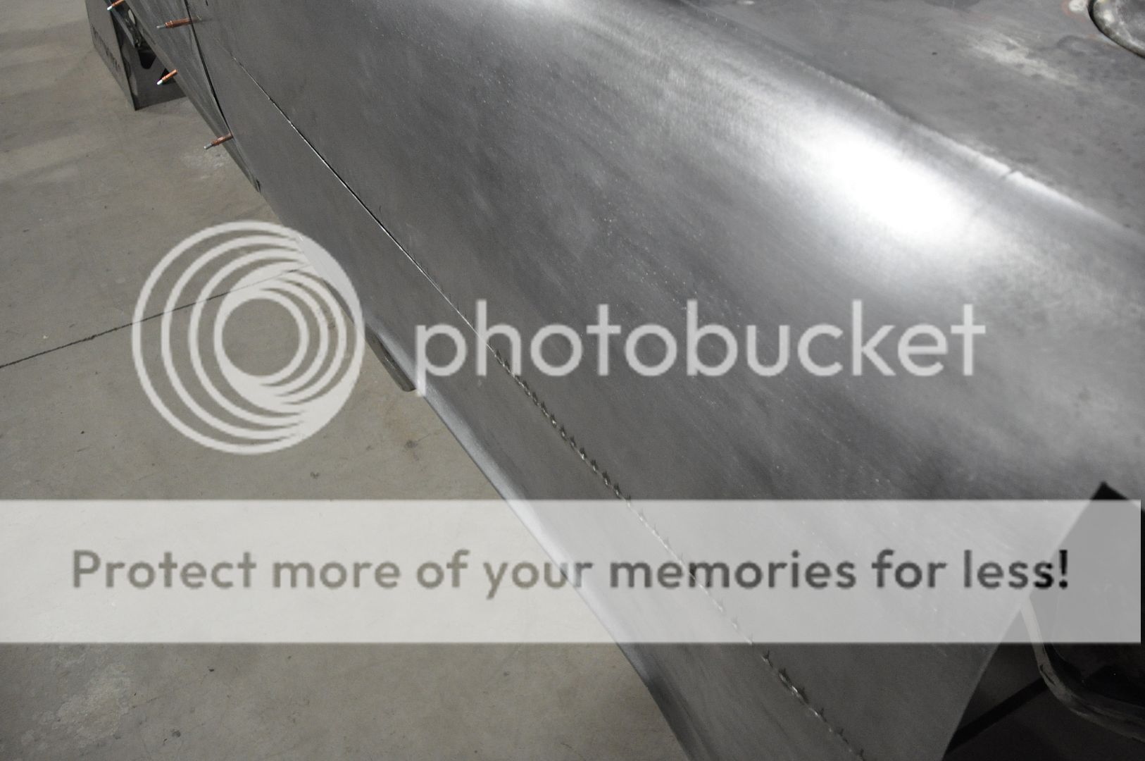

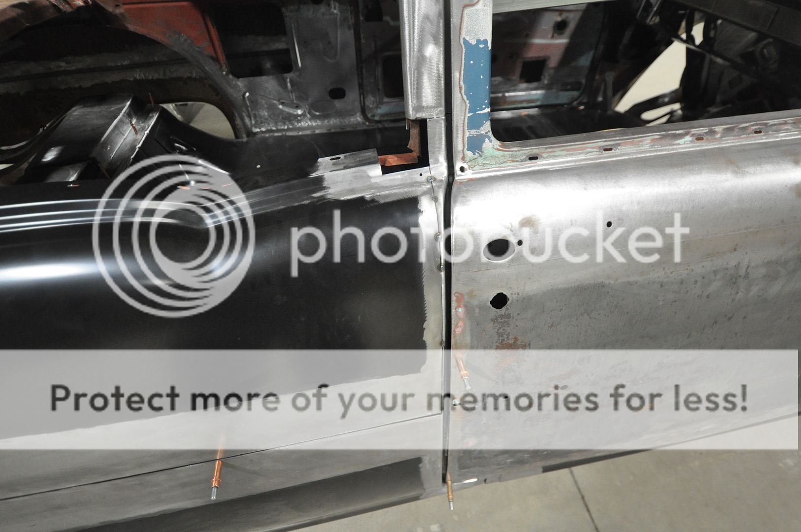

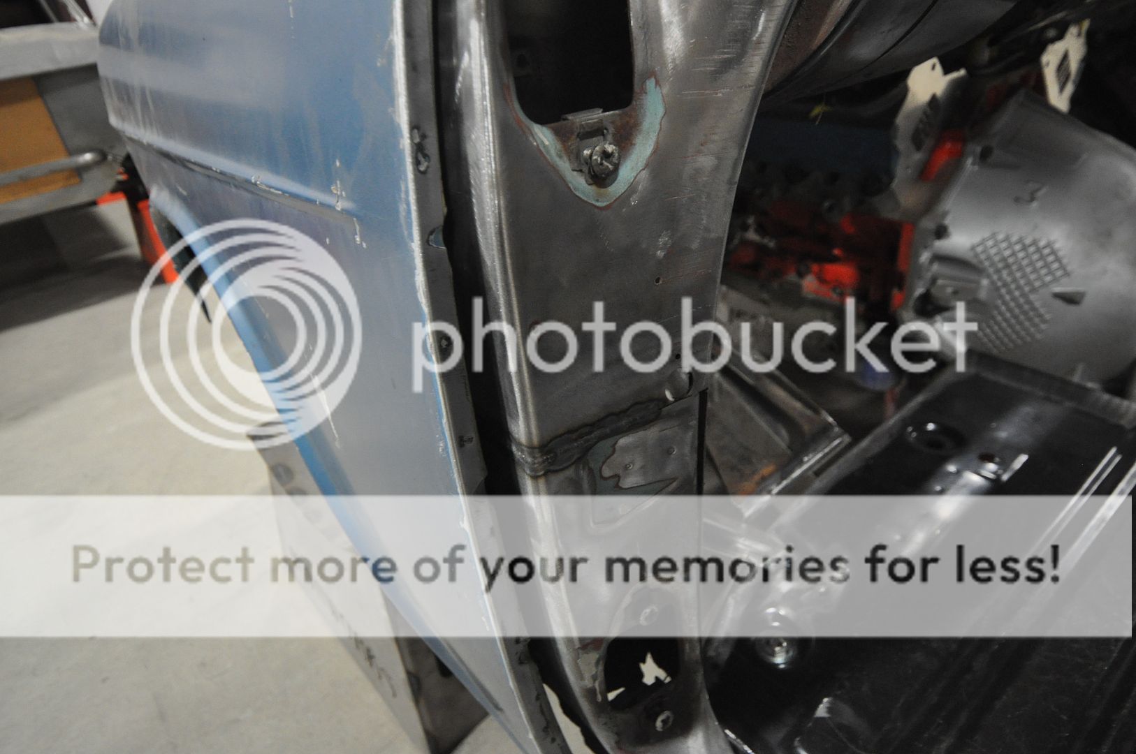

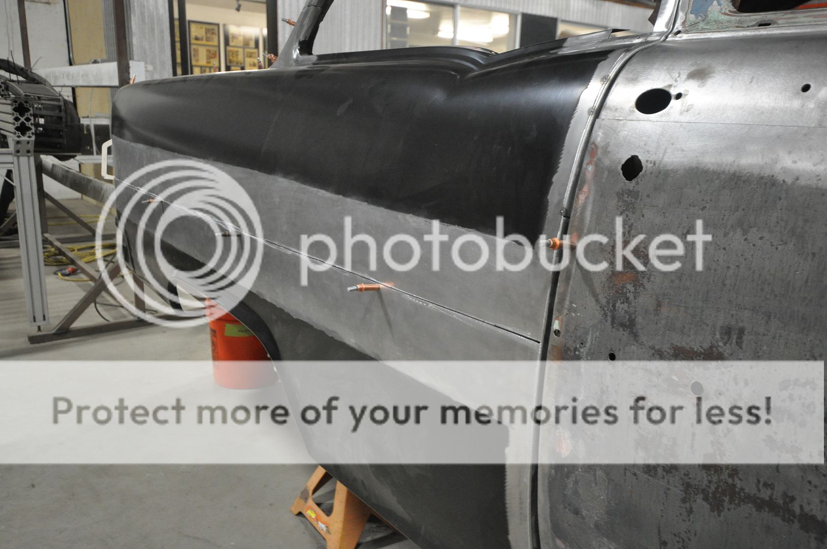

ironworks 05-19-2014 07:09 AM

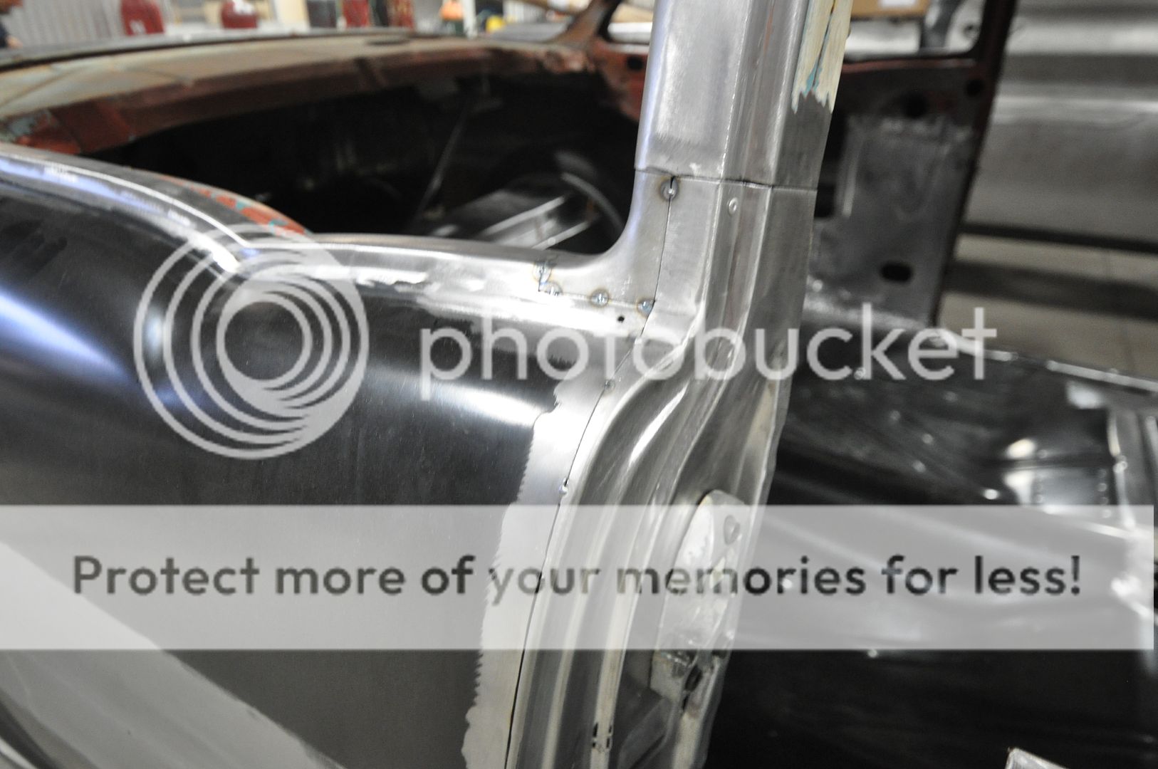

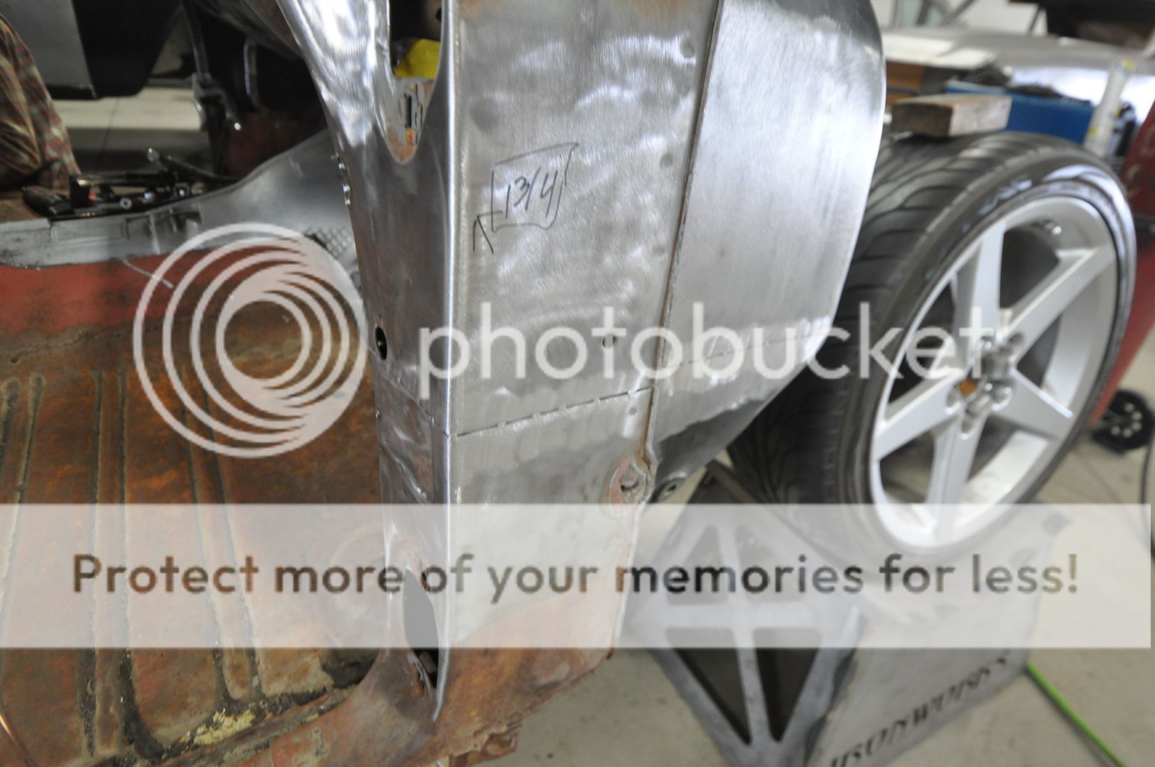

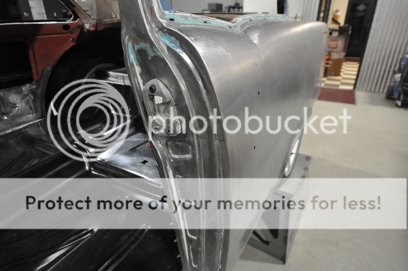

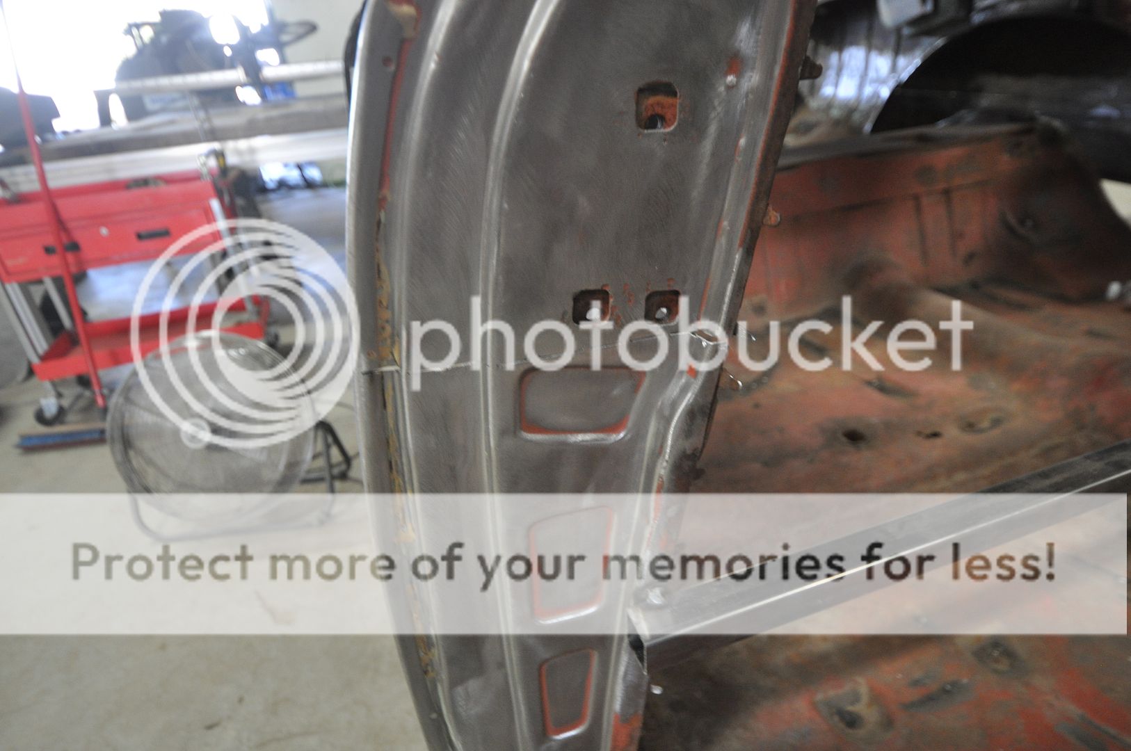

So the next step in the process was welding up the seams in the car. This is where the precise cuts and proper fit up pays off in dividends.
http://i616.photobucket.com/albums/t...oppics2029.jpg
http://i616.photobucket.com/albums/t...oppics2030.jpg
http://i616.photobucket.com/albums/t...15-2014010.jpg
http://i616.photobucket.com/albums/t...21-2014009.jpg
You can see the amount of work that was needed to get this Danchuk quarter panel to fit properly. The original door skins will be replaced as the final step to get the flow down the sides proper once everything is complete. They are just riveted on for looks at this point.
http://i616.photobucket.com/albums/t...21-2014011.jpg
You can see this quarter panel has been welded and metal finished. This is the stock quarter that remained on the car and was cut and welded back together. We also shaved the gas door at this point to minimize warpage.
http://i616.photobucket.com/albums/t...21-2014012.jpg
http://i616.photobucket.com/albums/t...31-2014009.jpg
http://i616.photobucket.com/albums/t...31-2014010.jpg
Looks factory at this point.
http://i616.photobucket.com/albums/t...31-2014013.jpg
http://i616.photobucket.com/albums/t...31-2014014.jpg
