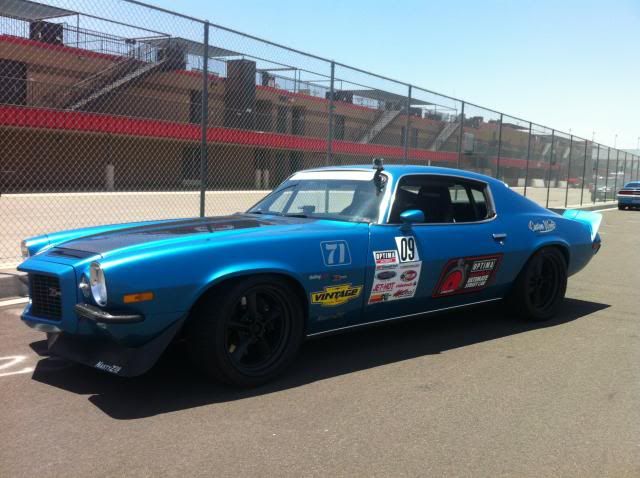

So all went well. The only issues we had were a too soft rear sway bar, and one of our BFG Rival tires decided to start coming apart. Our autocross and Speed Stop results weren't what they could have been, but that's what we had for the course that day. The Roadcourse was a lot of fun, and I feel we placed about where we should have. It was an honor to place second in the design and Engineering Portion, which was judged by Steve Rupp, Cam Douglas (optima), Lingenfelter Honcho, someone from K&N, and Larry Calehan from Pro-touring.
10th- Overall finish
12th- Autocross
12th- Speed Stop
7th- Roadcourse
2nd- Design & Engineering
here is a video of the 3 competition events
https://www.youtube.com/watch?v=-ksxc-fXkVA

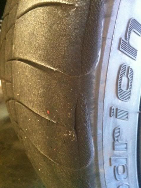

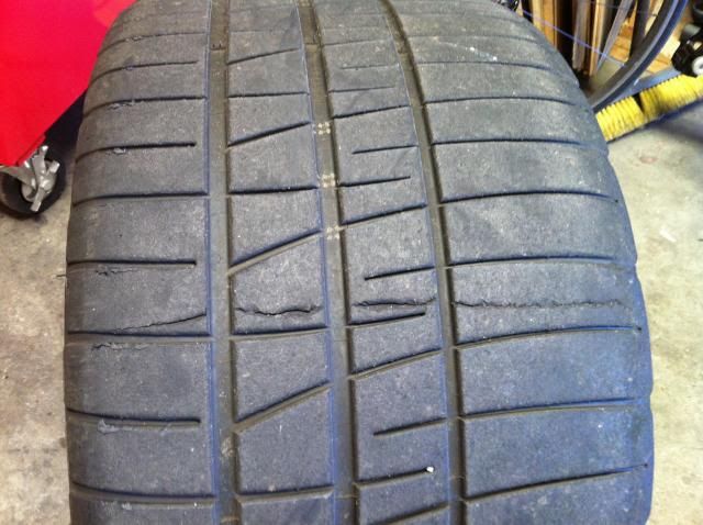

So everyone is aware of the tire issue we had with the BFG Rival, here is an update. BFG has not done anything regarding the issue as of yet. Tirerack, who is the exclusive retailer and distributor of the Rival tire informed me that they have had issues with some of the other sizes of there than my 275/40/18 with the shoulder of the tire delaminating from the tread. Their technicians have received my photos below, and i provided them with my alignment specs and video of the car being run. They haven't gotten back to me as of yet with a determination. Below are pics of the single tire that has come apart. It was a left front. Also is a rear tire that appears to have cuts accross the tread, both rear tires have this and it appears to be as deep as the rubber. I have seen this on other tires we have run on the car in the past and never resulted in an issue. My biggest concern with the Rival tire is the durability of the tire when used in competition, for which it was supposedly designed for. Just a not, the outer shoulder is not worn through, and did not contribute to the splitting of the tire itself. The tire has about 60% tread left

Matt@BOS 07-04-2014 11:31 AM
I have Rival with the same cross tread cut/tear marks on it. I always thought it was just from a particular track though.

The outside edge looks like a rub to me? Notice the inside edge is not blued. Are you sure you didn't hit a piece of debris? The horizontal line is concerning.
ks71z28 07-06-2014 10:14 AM
Its not a rub, apparently there are lots of Rival tires doing this. The rubber on the shoulder is not worn at all, and the depth of where it is coming apart isn't consistent around the tire, the tread is pealing off!
dontlifttoshift 07-07-2014 02:51 PM
Based on the pictures, the front tire does look to be under inflated. You are rolling to far over on the sidewall. I don't think it should delaminate like that, though.
The rear "cut" across the tread is where the splice is. It is supposed to be a non issue and I have seen several Rivals do this in all sorts of sizes.
Vegas69 07-07-2014 05:09 PM
Definitely no bueno....
