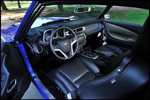

I'm following the same path on my 68 camaro, it seems to be getting more popular. I haven't begun installing them yet but here are some pics Ive found across the net.
http://i198.photobucket.com/albums/a...6458523132.jpg
http://i198.photobucket.com/albums/a...2-139639_3.jpg
There's also a very detailed build thread over on pro-touring.com worth following if you plan on doing this

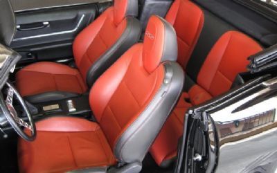

dhutton 01-21-2019 05:28 AM
1 Attachment(s)
Finally got these seats installed. It was extremely tight with the MCI console. Seats look a little odd because they are so tall but they are very comfortable. Driving position is great for me at 5’9”. A tilt wheel is essential. Probably wouldn’t do it again but there was no turning back.
Don

I didn’t do anything this sophisticated. Just added some small extensions to the floor pans with correct mounting nut locations. I cut the locating features off the bottom of the tracks. I had to remove a skooch from the rear outside track to clear the seatbelt mounting bolt hole. One of my goals was to retain the stock mounting holes in the event that I could not get these to work.
Jim’s solution is superior but I think it would exclude the Morris three point belts I wanted to use. His method would work better with the TMI console.
