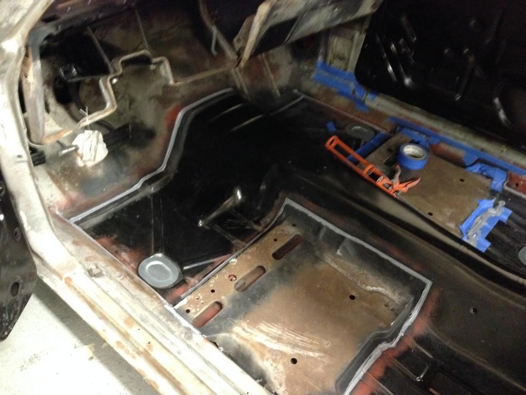

Cut out the cowl, right side cowl shoulder, floor pan, trunk pan, and left rear quarter panel...

At this point, with all that out of the way, I decided to go mini tub and 4-Link rear suspension. So Corbin added that to the parts list for me.
