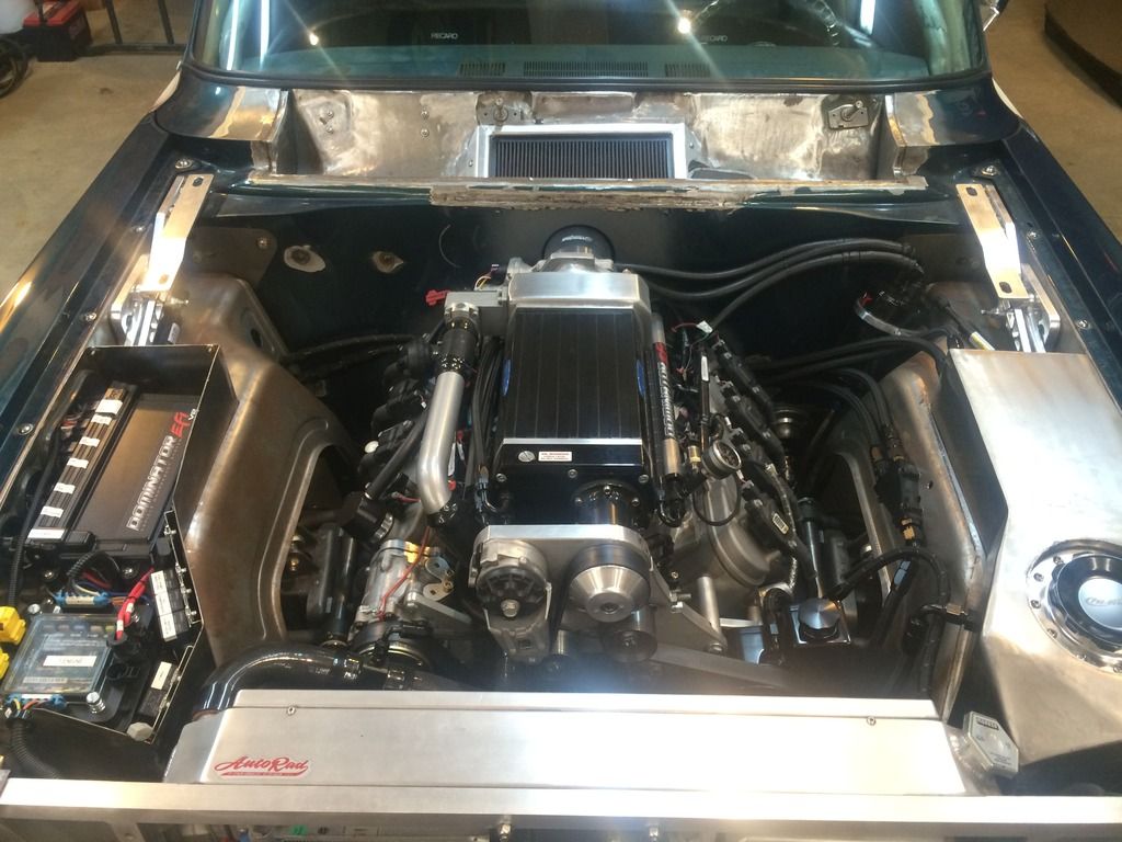

All depends on your preference, what you want to do with it and the motor it's going on.
I have a radial entry Whipple on a 427CI GM LSX with Air Flow heads. I wanted the old school look, high tech blower, EFI and more HP than I knew what to do with.
I got it. Ignore the 2x4 holding up the hood at my body shop. I am redoing the paint...

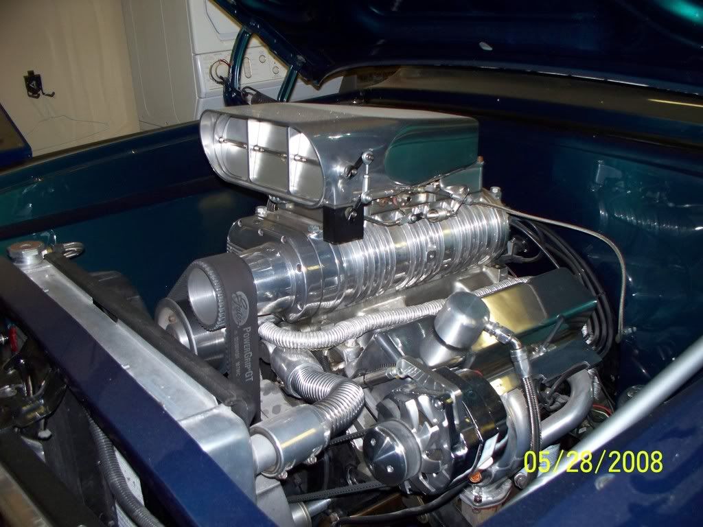

Kenne Bell on my ls2 408!

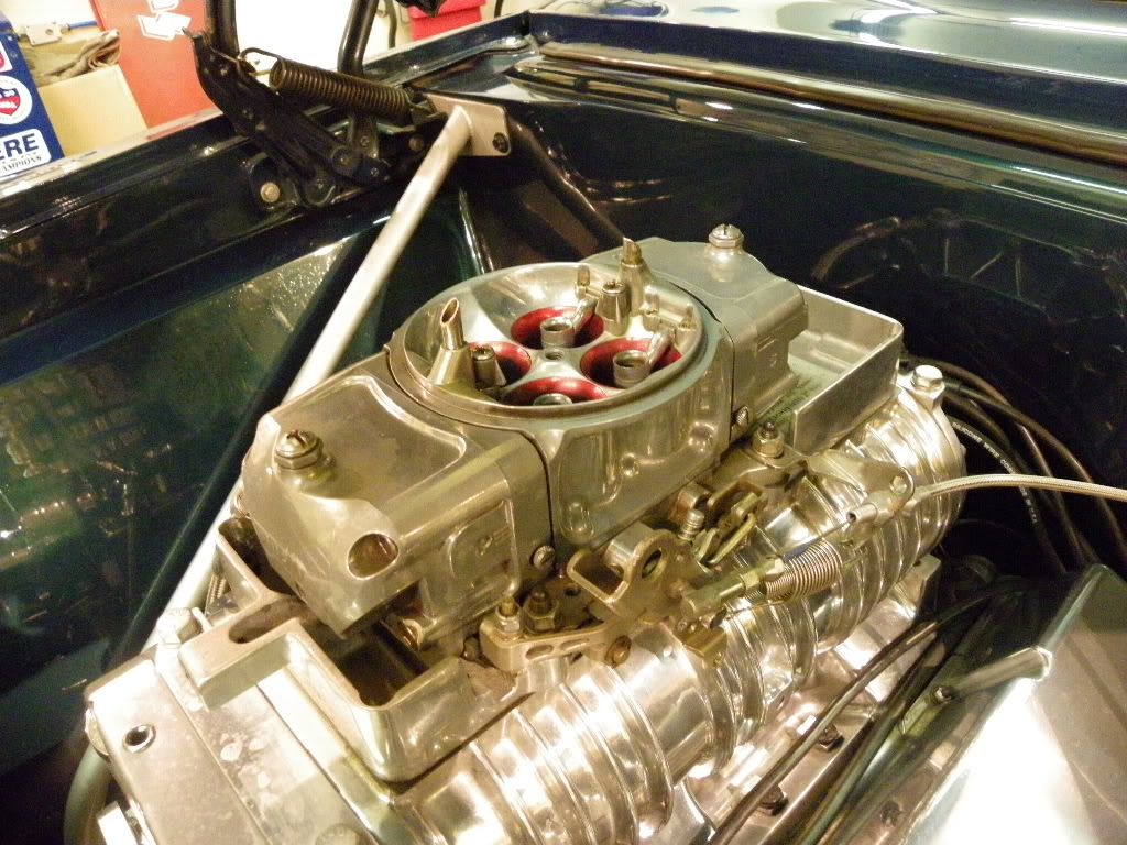

I don't know if it will work but may give you some ideas. Here is what I ran on my Nova (with a carburetor).
This is a scoop out of New Zealand the carburetor fits inside the scoop.
http://i300.photobucket.com/albums/n.../62nova014.jpg
