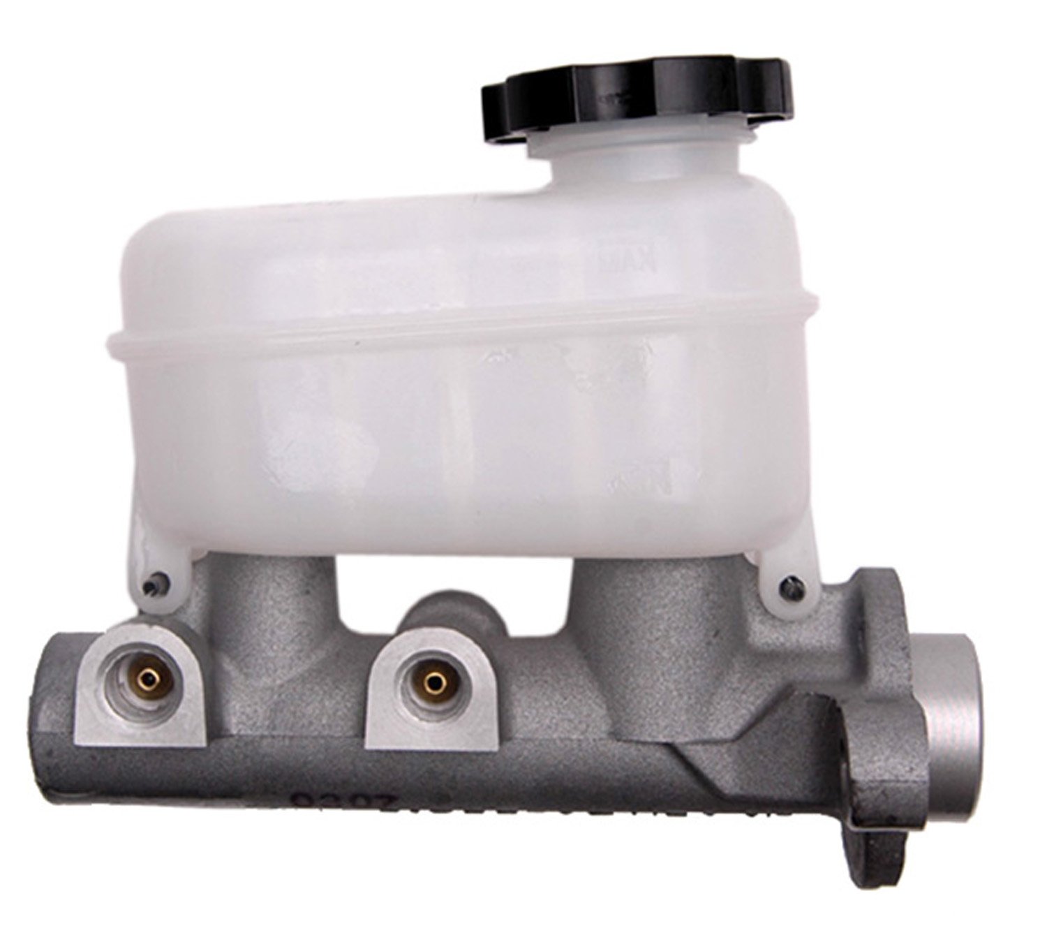

redfire69 08-10-2019 08:45 AM
brake line size
Des anyone know if it's safe to go directly with 3/16 brake lines off the master using this setup?
https://www.amazon.com/ACDelco-18M97.../dp/B000C9E5IW
https://images-na.ssl-images-amazon....L._SL1500_.jpg
