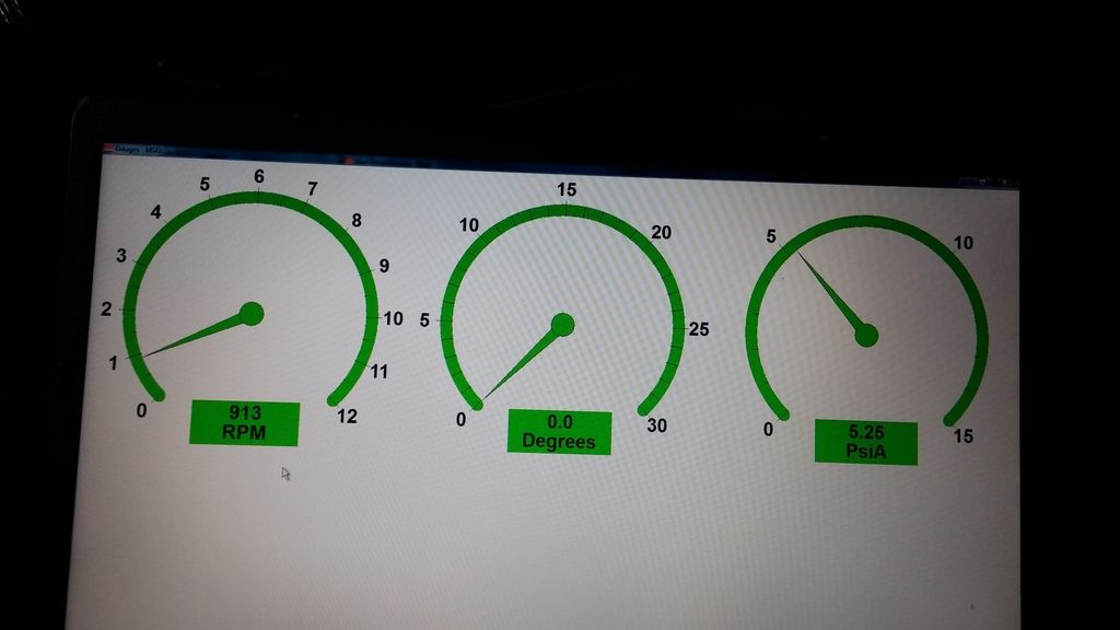

Here is my graph at idle as it sits now.
https://lh3.googleusercontent.com/-V...0307151129.jpg
and like I said it's pulling 20" of vacuum at idle
https://lh6.googleusercontent.com/-s...307151129a.jpg
When I had the initial at 10* it was idling at 1100 RPM and pulling 23" of vacuum.

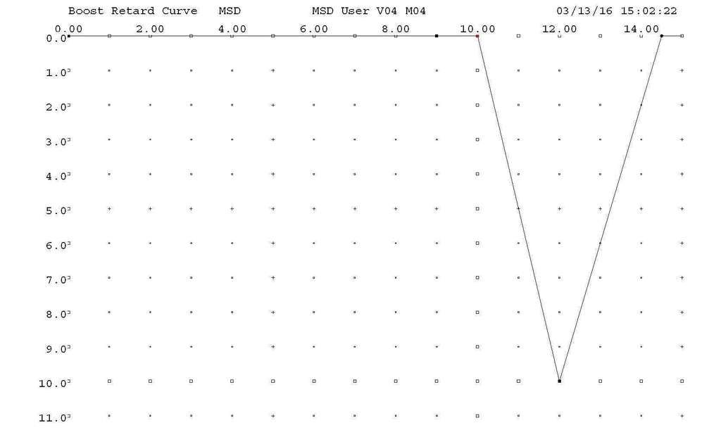

68Cuda 03-10-2015 08:50 PM
1 Attachment(s)
Originally Posted by SSLance (Post 598072)
OK... is this your boost retard graph, if so it is currently doing nothing!
This is an "example" curve to dial in 10 degrees of retard progressively with 10 PSI of boost. Your car is naturally aspirated - correct?
The 14.75 point you see on that chart where the red and blue meet is "0" boost -or- "0" vacuum. It is the 14.75" reference point of atmosphere, the same pressure as your outside air.
If you are not running boost, to get 14 degrees of "advance", do the following: From 0 to 5 PSI on that chart set the "degrees of retard" to "0" (same as it is now). Then, from 5 PSI to 14.5 PSI have the chart slope down from "0" to "14" degrees of retard. From 14.5 PSI to the right leave it at "14". After setting this curve, set your timing to your current 7 degrees initial with the vacuum unplugged from the MAP sensor. When you plug in the MAP if the vacuum is 20", it should jump to 21 degrees. If you have a hand vacuum pump you can test this through the range to make sure it does what you think. Anytime you want to disable the advance and go back to your base curve it can be as simple as unplugging the vacuum line from the MAP and capping the manifold port. This will dial in the full 14 degrees "boost retard" and effectively put you bask to your 7 degrees base timing.
I took the example they sent and superimposed the curve I described as a purple line, why MSD does not illustrate this is beyond me. If you like the outcome and want to dial in more, say, up to 20, then instead of going to 14, go down to 20 at the same point and reset your base timing.

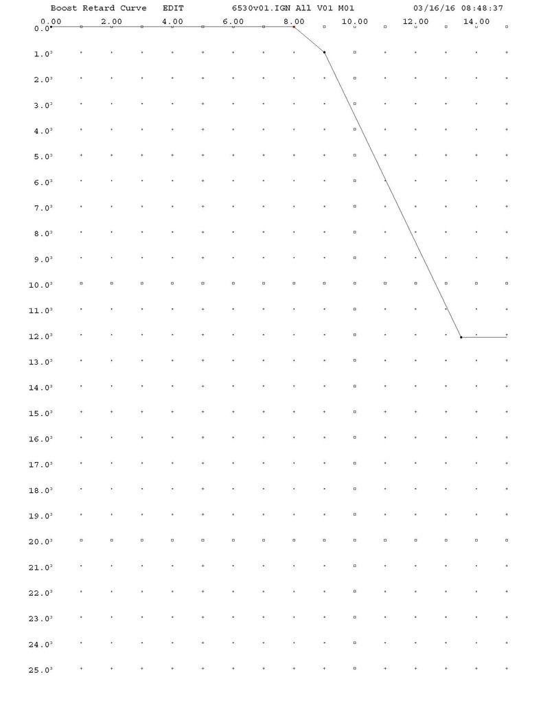

SSLance 03-11-2015 06:05 AM
Okay, I think this is starting to sink in...thanks...
How my brain looks at this now is 14.75 PSI on the graph is zero vacuum or WOT and at that point there is no advance from the MAP sensor\boost retard curve. When the throttle is closed and vacuum increases, the graph moves to the left and the further it goes to the left the more advance is being added to the distributor. Furthest left is full advance at max vacuum at idle (based on your curve shown anyway).
Last night I drove the car with the laptop and vacuum gauge inside the car so I could watch. At idle and when at high vacuum when running the red line in the Boost Retard graph stays right around 7.00 PSI with the vacuum gauge at 20"
I never saw the red line go less than 7.00 PSI. So should I start the left side of the curve at 7.00 PSI or at 4.00 PSI as in your graph. And the bottom of the curve should level off at 14.75 PSI all of the time right?
The one thing I'm still fuzzy on, the relation of the 20" on vacuum gauge to 7.00 PSI on the graph.

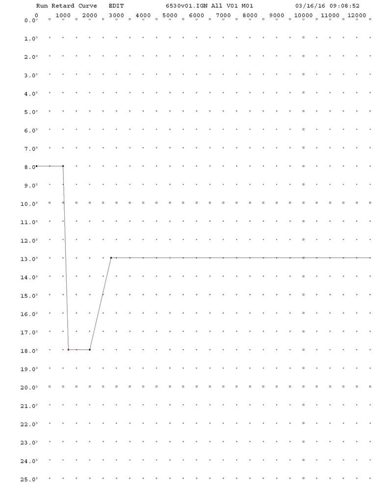

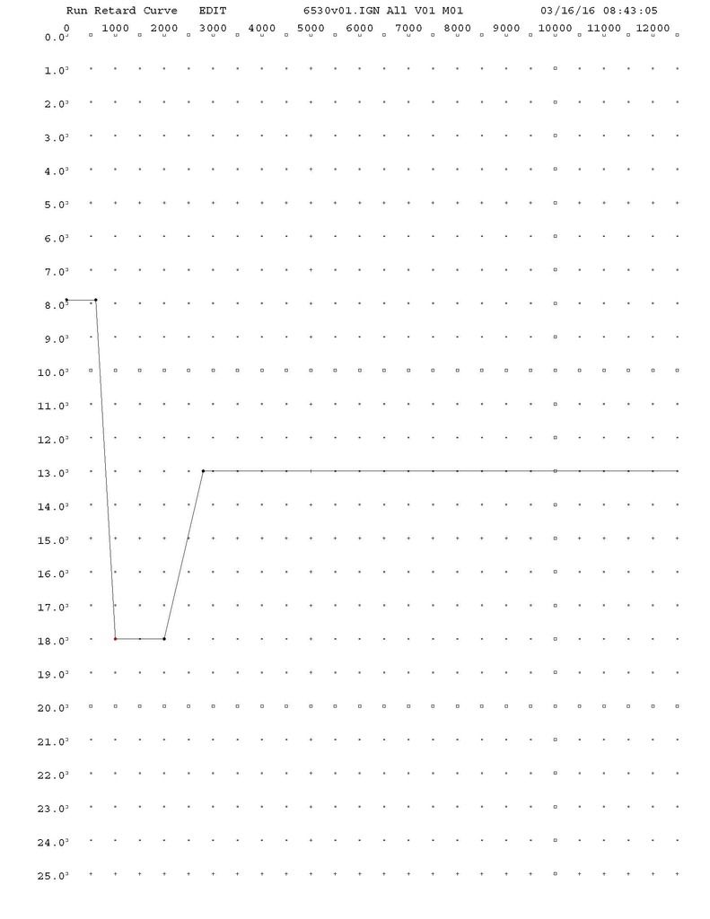

SSLance 03-11-2015 08:22 AM
Sometimes I do some of my best thinking in the shower in the morning... :D
I did some playing around with the curves, please let me know your thoughts on these. I haven't put them in the box yet.
First, my engine likes 7* at idle and 32* total. Actually I think it would like 6* and 33* better, more on that in a minute.
Here is my current Run Retard curve
https://lh3.googleusercontent.com/-e...rd%2BCurve.jpg
I don't think I want to add any vacuum advance in at idle, I think I want it to kick in just off idle...so here is my idea for a Boost Retard Curve...
https://lh6.googleusercontent.com/-X...rd%2BCurve.jpg
It currently idles at 850 RPM and around 7 PSI
Now...and this is where my brain starts kicking in... :D Can I use the Boost Retard Curve to pull even more timing out at idle, say instead of the curve being at 14.0 from 6 PSI to 8 PSI, can I put that at 16.0 to pull another 2* of timing out at idle?
This would let me bump my full advance up to 33* and still let it idle at say 6*...

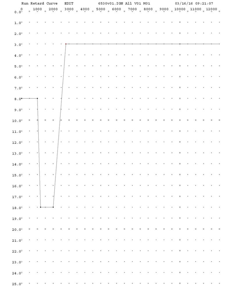

68Cuda 03-11-2015 11:14 PM
I would not make sharp transitions like that, it could cause the engine to surge, oscillate between two points or do something funny. Sharp transitions in control systems are never a good idea.
Why the aversion to running so much advance at idle under no load? It may actually let the engine run cooler. As soon as you put a load into it the advance will drop out. People run locked out distributors at full advance on race cars, I don't think your idle speed is going to run away or anything funny. Just try it out and see how it behaves, you can always plug off the vacuum port and disconnect the MAP sensor until you can change it back if it does something you do not like. Disconnecting the MAP sensor will trick it into thinking you have no manifold vacuum and it will pull out all the timing. If you are worried try a smaller amount to begin with, like 7-10 degrees. Just match the amount of advance you put into the initial timing with the amount you take out with the "Boost Retard Curve".
It doesn't matter much if you start at 4" or 7", it just changes the amount of advance a little. Starting at 7" should be fine since that is where your MAP sensor is telling you the engine runs. You can also cheat the end point on the right a little. When you disconnect the vacuum from the MAP does it read 14.75"? I would want the full amount of spark advance pulled out before that point, maybe set it to 14" even to have some margin
The difference between 5" and 7" could be the MAP sensor calibration or your vacuum gauge, either or both could be a little off. 20 sounds like a lot to me for an engine that is not stock, maybe your gauge is a little generous or non-linear. It does not matter much, it is just a reference point, use the MAP sensor since it will be controlling the spark.

SSLance 03-13-2016 01:18 PM
So, a year later I am revisiting this topic. It was interesting to read back and see what I bailed on last year and attempting again this year with the new engine.
Last year I disconnected the MAP sensor and just ran the run retard graph in the box and it did pretty good all year. With the new engine, and new train of thought...I'm trying to program in a "boost retard" curve once again.
My engine builder concentrates on race engines and we dynoed this engine at 32* locked out 0-6500 RPM. I initially started with the run retard curve in the MSD that I ran last year that pulled 10* out at idle ramping up to all in at 2000 RPM. (22* at idle, 32* 2000+RPM) It ran pretty well but the idle was a bit unstable, most wouldn't have noticed it but while trying to tune the carb it was kind of giving me fits. I finally took the builder's advice and locked in 32* 0-6000 RPM. That cleaned the idle up a lot and I was able to get the carb dialed in nicely. It pulls about 17" of vacuum idling at 850 RPM with an AFR of 14, cruise AFRs are right around 15 and it gets a bit fat under WOT around 12-13 depending on what RPM I start the pull at. It runs very smooth, makes great power, and is safe if I get a bad tank of gas somewhere.
The only issue is it will ping if I lug it down under 2000 RPM in 3rd, 4th or 5th gear. I have to try to make it ping, under normal driving circumstances I can not hear any detonation.
So I have put the MAP sensor back in place and am working on using the Boost Retard function to try to pull some timing out under low vacuum situations.
Here are the dials at idle completely warmed up.
http://img.photobucket.com/albums/v3...ps46kxfkxy.jpg
It idles around 5.25 PSI, will drop to 3.5 PSI under full engine compression like downshifting coming to a stop and the highest I've seen is about 13.75 PSI at WOT in 3 or 4th gear. I created this Boost Retard graph and drove it.
http://img.photobucket.com/albums/v3...psdcwbrb58.jpg
It's basically pulling 10* of timing out (32-10=22*) when vacuum drops under WOT pulls and stopped the pinging. The thing is, at WOT the PSI gains to 13.75 and the box stay at 5* retard (27*)...never letting the timing get back up to the 32*s it needs.
I'm thinking about pulling the right dot that is right now at 14.5 to the left and putting it at about 13, that way at just less than WOT the box would put the full timing amount back in, only retarding the timing between 10-13 PSI.
Am I thinking correctly here? I can't seem to find a way to pull timing out at WOT (zero vacuum) at low RPMS, but not pull the same timing out at WOT at higher RPMs where the timing is needed. So my hard head is thinking to just tell the box to pull the timing at just about WOT...
68Cuda 03-13-2016 01:44 PM

68Cuda 03-14-2016 06:40 PM
1 Attachment(s)
Originally Posted by SSLance (Post 632335)
Trying to compare vacuum advance with vacuum in inches to Boost Retard with instead of vacuum in inches, manifold pressure...makes one's head spin.
What I need to do is decide if it's worth the effort to lock the distributor in at say 45* crank timing and plot both run retard and boost retard graphs to pull enough timing out with either or both to get the timing in perfect spot for all scenarios? I could probably end up with total timing in the 40+* range at idle and cruise RPMS and use the MAP sensor\boost retard to pull timing out under a load and WOT.
Yeah - kind of confusing... theoretically atmosphere is 14.7", so anything under that is a vacuum. It is just whatever your reference is. You just have to unplug to figure out what your atmospheric pressure is. The crazy part is the fact that your scale is flipped. If 14.7 is atmosphere, that is what you think of as 0 vacuum. The numbers don't really matter in reality, it is all just a reference. Sounds like your "0" is WOT at 13.75, so be it.
OK... two different camps on this. Manifold vacuum and port. Based on the problem you are describing let's try port vacuum, this may give you the effect you want. With port vacuum you should only see vacuum at partial throttle. This will eliminate the extra advance at idle and at full throttle and stabilize the rpm at idle. The "port" you want to plug into should be above the throttle blades and should read 0 vacuum at idle when measured with a vacuum gauge.
I think you are still thinking of the vacuum curve backwards.
OK, two different curves! One for RPM (aka centrifugal advance) and one for the "boost" retard (aka vacuum advance). For the RPM curve let's say you want to go from 8 to 32, all in by 2800 rpm. And, for the "boost" you want 10 degrees advance max on the ported.
Your base timing with no curves would be 8+24+10= 42 degrees (pretty close to the 45 you stated). Remember that everything on the MSD is backwards, it is all retard. So, the RPM curve would start at 24 degrees retard. If your idle is 900, then maybe you start adding timing back in above 1200. Your "curve" would be 24 degrees retard from 0 rpm to 1200, then progress to 0 degrees retard at 2800. The effect is timing would be 8 degrees at idle and at 1200, it would then increase gradually to 32 degrees at 2800 rpm. This is my example... set it for power at what works best for you! I used "8" as my idle timing just as an example.
OK, for your boost curve (connected to port vacuum), if 13.75 is WOT, then you want 10 degrees retard at WOT to give you 32 total above 2800. So, left to right you put 0 retard to about 4 then increase your retard to the full 10 by about 12, leave it at 10 total all the way to the end of the graph on the right. At idle, or with the port vacuum line unplugged even, the 10 degrees retard will be pulled out and the timing should be whatever you want it to be, it should not jump around.
So add these together... say you are running 2800 rpm with the throttle barely cracked and a little downhill, you could then be running as much as 42 degrees advance. No problem under light / no load. As you tip into the throttle and start to load the engine the vacuum will drop and your timing will move to 32. Cruising speeds around 2000 (half way between 1200 and 2800) you would be running 18 advance due to RPM, and if there is no load, as much as an additional 10 which will help mileage.
Attached charts make sense? Boost:

SSLance 03-16-2016 07:29 AM
I've been tinkering and picking brains a bit more and I think I've come up with a plan. Please take a look at this and make sure my thinking is straight before I implement.
Distributor is locked out at 45* advance,
Run Retard is set as below,
Idle timing 0-600 RPM -8* (37* actual)
1000-2000 RPM -18* (27* actual)
2800+ RPM -13* (32* actual)
http://img.photobucket.com/albums/v3...pssm0zdqen.jpg
Boost Retard is set as below
Full vacuum
17"-12.4" at idle or cruise -0* (37* idle, 27* 1000-2000 RPM)
9 psi (12.2" vacuum) -1* (26* actual 1000-2000 RPM)
10 psi (10.1" vacuum) -3.2* (23.8* actual 1000-2000 RPM)
11 psi (8.1" vacuum) -5.7* (21.3* actual 1000-2000 RPM)
12 psi (6.1" vacuum) -8.4* (18.6* actual 1000-2000 RPM) (23.6* 2800+ RPM)
13 psi (4" vacuum) -10.9* (16.1* actual 1000-2000 RPM) (21.1* 2800+ RPM)
13.5 psi (3" vacuum, WOT) -12* (15* actual 1000-2000 RPM) (20* 2800+ RPM)
http://img.photobucket.com/albums/v3...psenblntrp.jpg
On the idle side, the only thing I can think of is I might need to adjust the Run retard between 800 and 1000 so it remains at a steady state there as my idle fluctuates in that range and a moving timing mark will probably make it fluctuate more.
Maybe something more like this. Is that too sharp of a transition between 1000 and 1200 RPM?
http://img.photobucket.com/albums/v3...psmaeazv0b.jpg
On the WOT side, it appears that I need to make the Run Retard more like this so I can see full 32* timing 2800+ RPM
http://img.photobucket.com/albums/v3...psx9u3pa12.jpg
12 psi (6.1" vacuum) -8.4* (18.6* actual 1000-2000 RPM) (33.6* 2800+ RPM)
13 psi (4" vacuum) -10.9* (16.1* actual 1000-2000 RPM) (31.1* 2800+ RPM)
13.5 psi (3" vacuum, WOT) -12* (15* actual 1000-2000 RPM) (30* 2800+ RPM)
I'm not sure how to get those last three lines closer to the desired 32* timing at WOT past 2800 RPM? The variable is vacuum inches, not RPM...so it's almost back to my other method of stopping the Boost Retard right before WOT.
68Cuda 03-17-2016 06:28 PM
Lance, I would leave the RPM based curve flat in the idle area and just do a straight ramp from 1500 to 3000. Why do you want so much timing at idle? It does not do much. Factory these cars usually ran 10 or less at idle with the vacuum advance unplugged.
As far as the pinging, I would tweak one curve or the other so it gives you a little bit less timing. Your boost curve might be a little too aggressive, try pulling it a little to the left. For example set it to the full 12 degrees from 10psi to 15psi and start the ramp down a little earlier, maybe 6psi instead of 8. In other words, at 6psi it would be 0 and then ramp down to 12 degrees by 10 psi. Try that first.
There are so many variables in the way the engine is built, load, the quench, the camshaft, air density (temperature, pressure, humidity) that no one answer will work you just have to tweak it until you are happy with it. On my 440 when I put the mechanical advance MSD distributor I set it by ear and drove it. Later in the week we put a light on it and it measured 35 total. I have been running big block Mopars since the 80s, I know what they are supposed to sound like...
