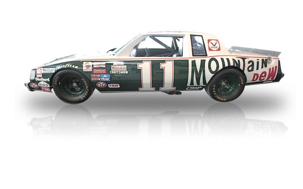

Very cool build. G-body looks like a great platform to get into this scene efficiently. You keeping the exhaust cut-outs? Green on green is such a design cue from the era as well. Throw some Sparco's in there covered in the same green vinyl.
Watching this build makes me want to do an old buick regal of similar era and paint it like the Mountain Dew car DW use to drive.
http://i1372.photobucket.com/albums/...pseb56c9fc.jpg
