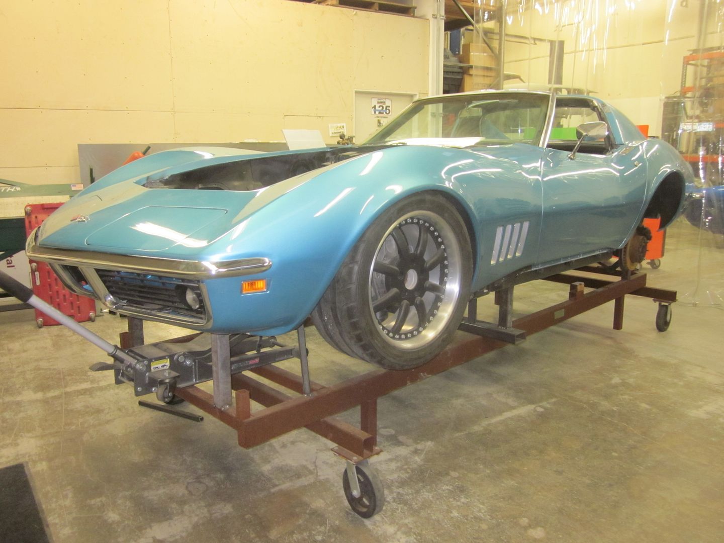

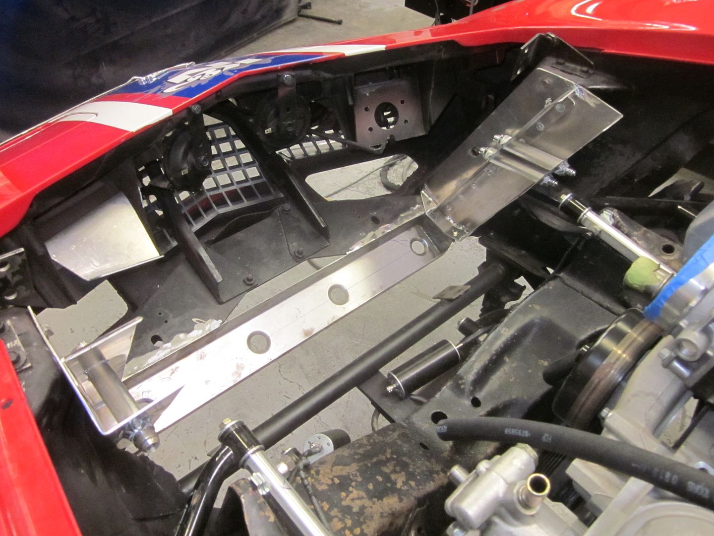

Cris@JCG 05-21-2015 10:06 AM
Got some time finally to post what I did to upgrade the suspesnsion.. The car had already been set up for Auto-X but need to freshened up.. So I just went ahead & rebuilt the whole suspension with Van Steel, JRI Shocks & Wilwood brakes.. I built my own front sway bar.. Modified the the rear trailing arms so that I could run the shocks on the back side where the leaf spring would go for quick adjustments & spring changes.. The car already had a quick ratio steering box in it.. Very basic simple bolt on stuff with just some minor changes..
http://i1015.photobucket.com/albums/...pslefuimrx.jpg
http://i1015.photobucket.com/albums/...psyzjxnfkv.jpg
http://i1015.photobucket.com/albums/...pstagos5gf.jpg
http://i1015.photobucket.com/albums/...pszg2luxys.jpg
http://i1015.photobucket.com/albums/...psltmr17nc.jpg
http://i1015.photobucket.com/albums/...psmxiouasd.jpg
http://i1015.photobucket.com/albums/...psses9bn8h.jpg

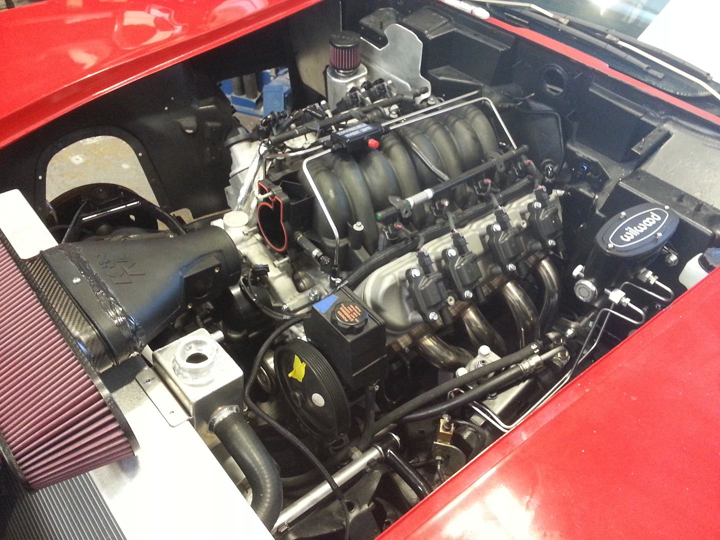

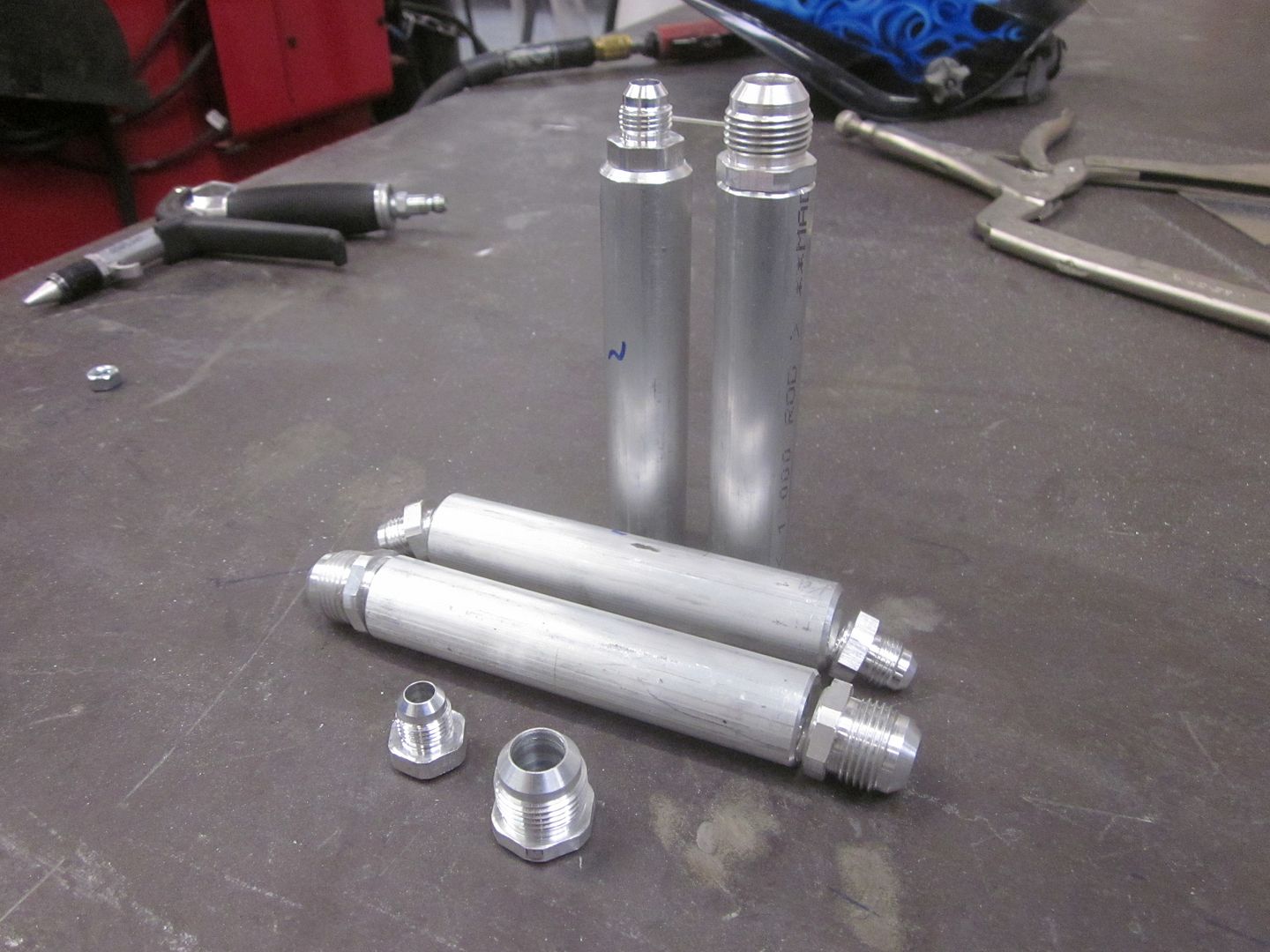

The LS Conversion has begun! We already built the gas for the car.. Went ahead & changed the location by dropping it to get the center of gravity lower.. New thing we are doing in our gas tanks is Vapor domes.. Next step is to build an Aluminum radiator support using a C6 Corvette radiator to bring the cold air tube out the front of the car..

vstol 05-21-2015 05:57 PM
Very nice, how is the rear spoiler attached/secured? Keep the posts coming. Thanks
https://lateral-g.net/forums/showthread.php4?t=44704
WSSix 05-21-2015 06:10 PM
Looks great, Cris. What's the purpose of the vapor dome?

I'm also curious of the vapor domes purpose?
Cris@JCG 09-07-2015 08:32 PM
The purpose is so that once the tank is full of liquid (no higher than the filler neck) there is a space above the liquid line for venting. Having this.space helps prevent the liquid from being sucked, or pushed, into the vent line.

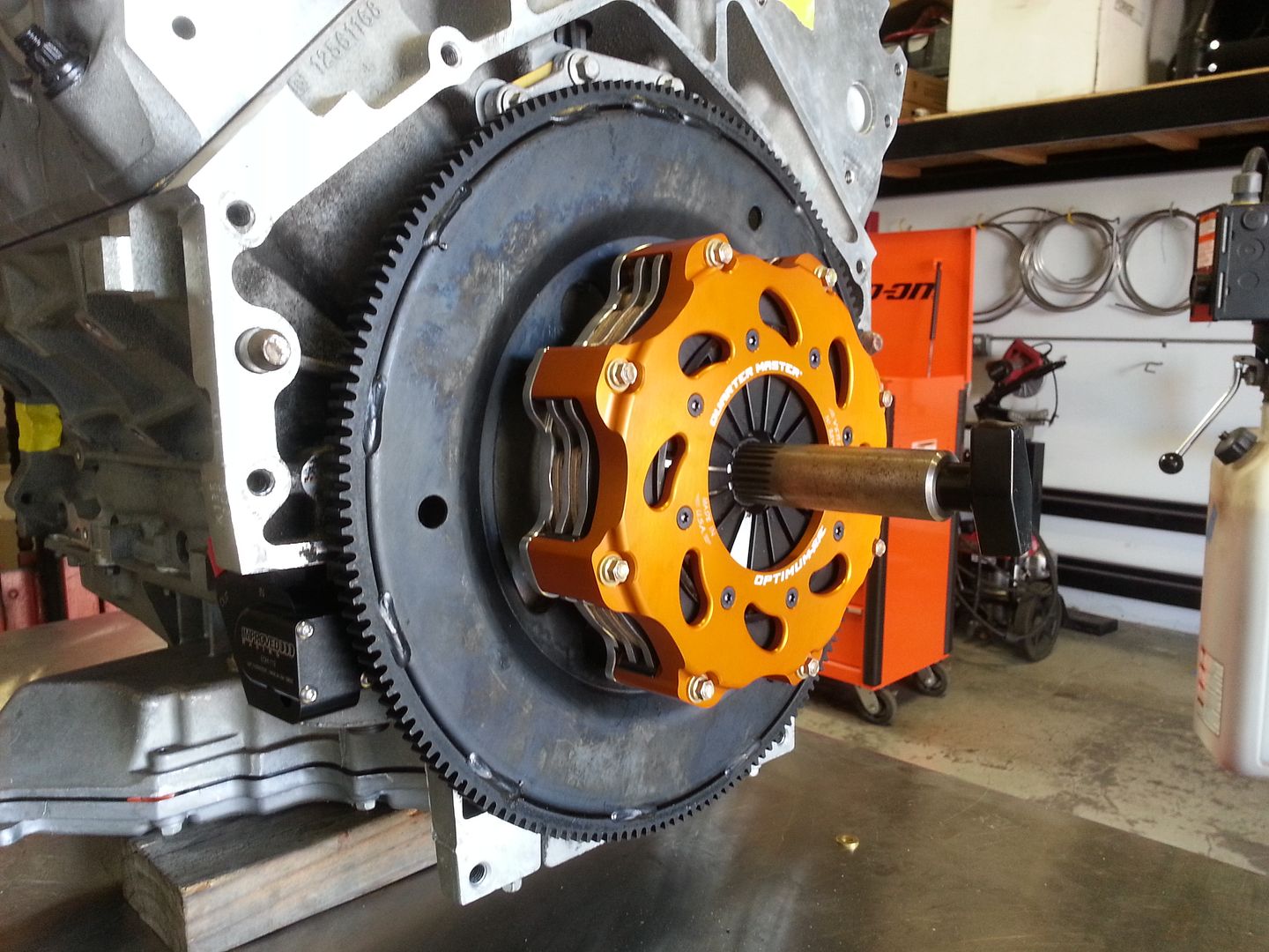

Cris@JCG 10-16-2015 03:49 PM

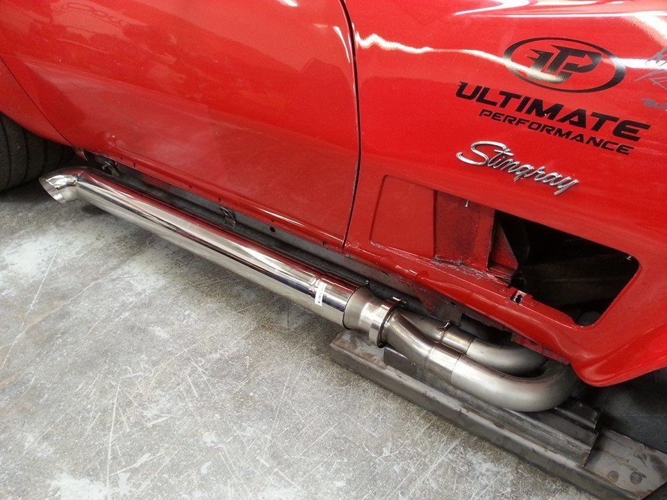

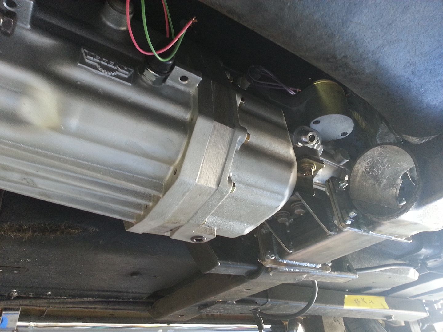

Here are some pictures of the LS6 conversion with Legend Gear & Transmission.. Quartermaster clutch, JCG/Wilwood hydralics, JCG Tri-y headers with mufflers, C6 Corvette radiator, Custom tanks with plumbing..

Vince@Meanstreets 10-17-2015 09:34 PM
engine and exhaust makes it look like it belongs in an airplane.
pretty cool stuff chris
Neil B 10-18-2015 08:36 AM
Love the headers!
