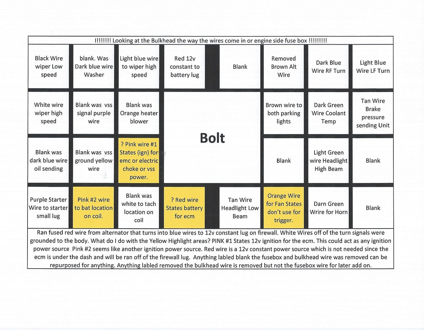

randy 11-16-2015 05:43 PM
yes i didn't solder anything either. Everything on the gmpp unit is plug and play. i had to change the vss connector for the t56 magnum but that was it. Now the american autowire kit is a diff story. I didn't solder anything there either though
there will be a lot of wires that you will not use if you are using the gmpp kit. I made this and helped a lot
http://i30.photobucket.com/albums/c3...ld19/Scan.jpeg
