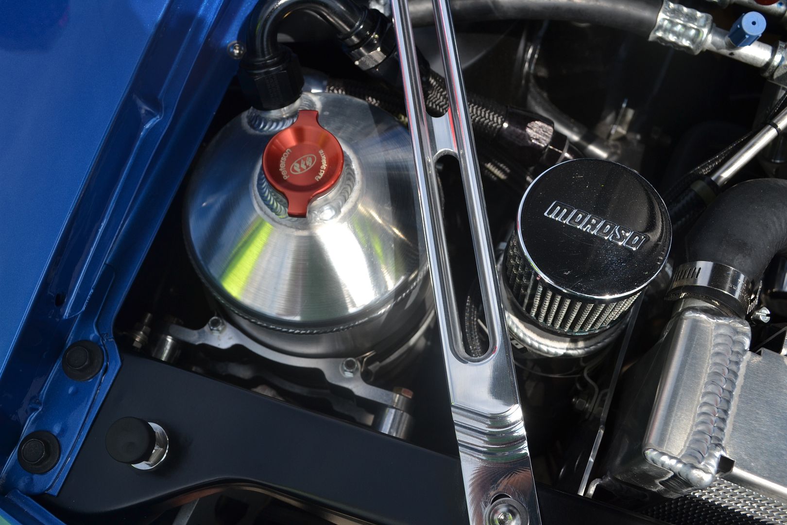

clill 07-25-2015 07:28 AM
1 Attachment(s)
JON Q 07-25-2015 08:22 AM
Thank you sir for posting the picture.

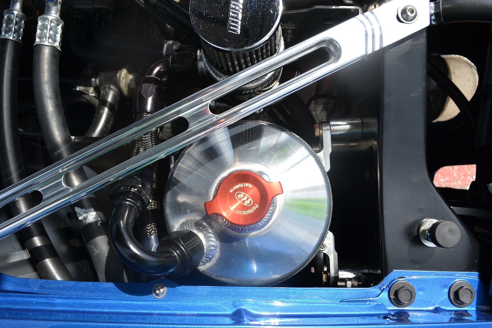

clill 07-25-2015 07:17 PM
1 Attachment(s)
Jackass part 1 had the tank up front on the left. Mark moved it to the cowl on version 2 to get weight back but 99.9% of us would not know the difference.
