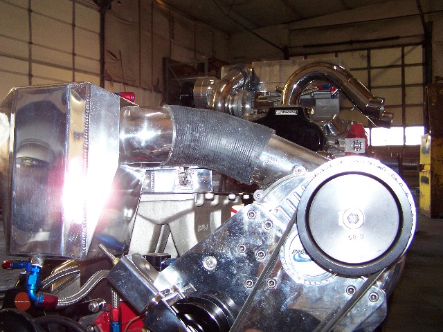

O well im new here and to each thier own thats what makes this world great, And just learing I guess we all are, If I did it correctly I inclosed a pic of one of my engines just off the dyno and the one in the back ground is going on in a few days, They each have those rings TSI TR9190 they are 4.505 5 over and untill I have problems with them Ill keep using them, Thanks
camcojb 09-11-2006 05:05 PM
I agree, if they work for you then keep using them. :thumbsup: I've tried 4 times without success, and read many engine builders saying the same, so when I see a post about those rings I "jump in"! :D
3kidsnotime 09-11-2006 05:10 PM
here's a couple of pics:
