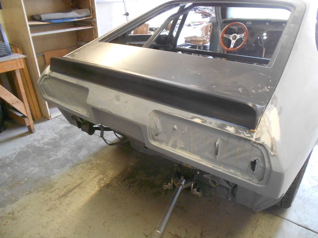

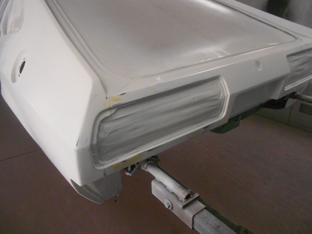

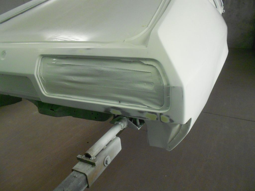

I wanted a cleaner looking taillight panel so the Ford holes were welded and ground down
http://img.photobucket.com/albums/v3...psa346e7d2.jpg
The bodywork is finished on the taillight panel
http://img.photobucket.com/albums/v3...ps12f2f5d2.jpg
Scottrods rear bumper fits great. The original bumper brackets were cut off and two holes were drilled in the trunk for a test fit. Add a few more bolts inside the trunk and a couple on each quarter and your done.
http://img.photobucket.com/albums/v3...psc13cc7bc.jpg

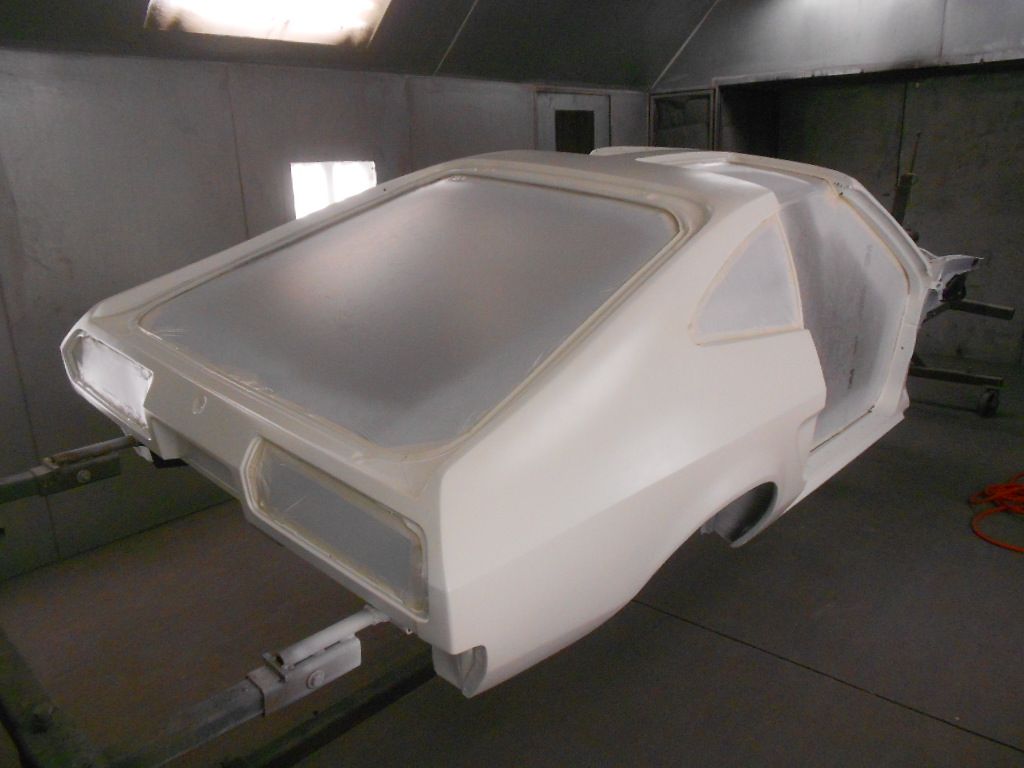

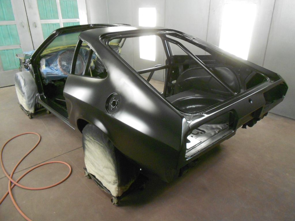

The major bodywork is finished
http://img.photobucket.com/albums/v3...pshnemds2r.jpg
Two coats of SPI epoxy
http://img.photobucket.com/albums/v3...pso116qlrc.jpg

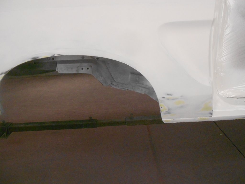

Block sanded and a little more bodywork
http://img.photobucket.com/albums/v3...pscbcvfh9p.jpg
More epoxy
http://img.photobucket.com/albums/v3...ps6bgax5en.jpg
http://img.photobucket.com/albums/v3...psth8b9yvj.jpg
http://img.photobucket.com/albums/v3...pskkujl1e8.jpg
I block sanded again and sprayed white epoxy. I have decided on a color SPI Orange. It is a little darker in person
http://img.photobucket.com/albums/v3...psbez77si9.jpg
http://img.photobucket.com/albums/v3...pscmpymy3m.jpg
http://img.photobucket.com/albums/v3...psszevse4i.jpg

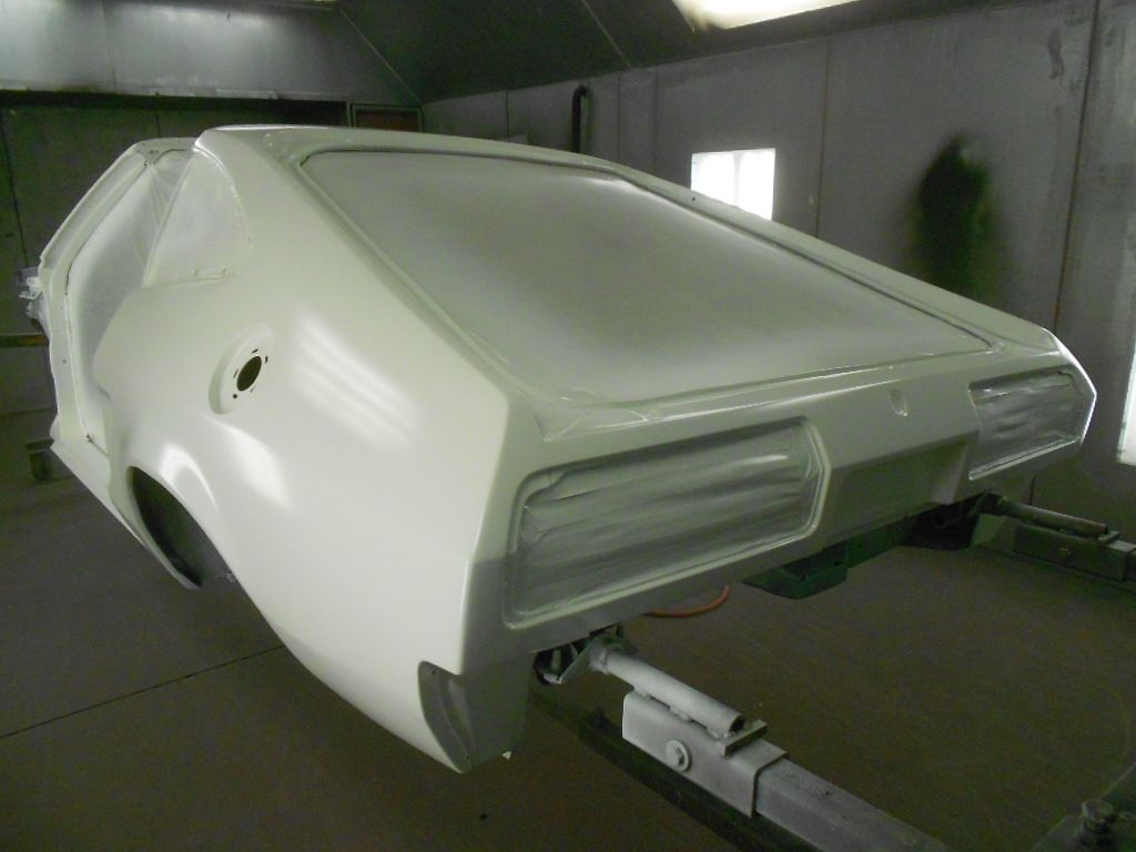

I sprayed two coats of SPI epoxy primer on the body and roll bar
http://img.photobucket.com/albums/v3...ps3vjcqe2l.jpg
I finished the bodywork and sprayed a coat of epoxy to seal it before spraying urethane primer
http://img.photobucket.com/albums/v3...ps7kicilmu.jpg
http://img.photobucket.com/albums/v3...psgwu0gvc9.jpg
http://img.photobucket.com/albums/v3...psj9ifkqap.jpg
http://img.photobucket.com/albums/v3...pseupasqqj.jpg
Two coats of SPI Turbo primer
http://img.photobucket.com/albums/v3...pslropjfx2.jpg
http://img.photobucket.com/albums/v3...psw0gv7nzi.jpg
The body has been block sanded and I sprayed a couple more coats of SPI Turbo urethane primer.
http://img.photobucket.com/albums/v3...pswsxacakv.jpg
http://img.photobucket.com/albums/v3...pse52iyzec.jpg
http://img.photobucket.com/albums/v3...psyxkq9j1r.jpg
http://img.photobucket.com/albums/v3...pshv19jmqi.jpg

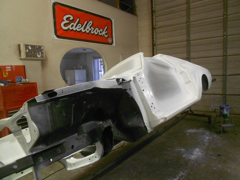

I decided it was time to upgrade the engine compartment
http://img.photobucket.com/albums/v3...ps88fmyrxv.jpg
http://img.photobucket.com/albums/v3...pskle3pcpr.jpg
Two coats of SPI black epoxy
http://img.photobucket.com/albums/v3...psjamlf9kg.jpg

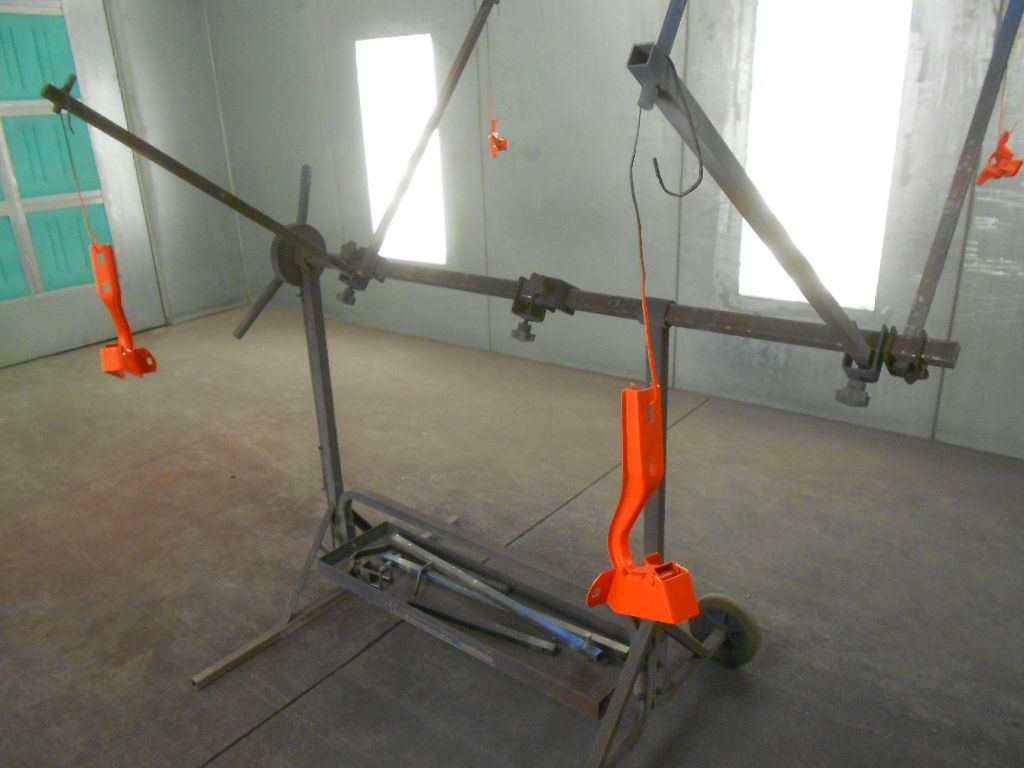

I painted a few more parts
http://img.photobucket.com/albums/v3...psp1yrhw65.jpg
http://img.photobucket.com/albums/v3...psjgtueiek.jpg
http://img.photobucket.com/albums/v3...pspdyrz2ji.jpg

I finished the bodywork in the engine compartment and sprayed a couple coats of SPI black epoxy. Next day I sprayed SPI Turbo urethane primer.
http://img.photobucket.com/albums/v3...psvbukwczd.jpg
http://img.photobucket.com/albums/v3...psynjyxleg.jpg
http://img.photobucket.com/albums/v3...psxprqkq7d.jpg
http://img.photobucket.com/albums/v3...psz8ol78kz.jpg
http://img.photobucket.com/albums/v3...psgqowloih.jpg

GPR 04-10-2016 10:37 AM
I had not planned on putting the Mustang II on a rotisserie but the more I thought about it I could not just leave the undercarriage looking like this. Brian and I (mostly Brian) fit it on the rotisserie yesterday.
http://img.photobucket.com/albums/v3...ps6egxsw0l.jpg
http://img.photobucket.com/albums/v3...pspooh1nj2.jpg

GPR 07-17-2016 08:46 AM
After I block sanded the body I found a few areas that needed a little more work.
http://img.photobucket.com/albums/v3...ps0kylx3b1.jpg
http://img.photobucket.com/albums/v3...psbhyve907.jpg
http://img.photobucket.com/albums/v3...pswod1f9bw.jpg
I had forgotten how hard it is to see any imperfections in white primer. I should have sprayed gray and the white just before spraying orange.
Two more coats of epoxy
http://img.photobucket.com/albums/v3...psqk3meyrk.jpg
GPR 08-18-2016 05:11 AM
I wet sanded the body with 400 getting it ready for paint
http://img.photobucket.com/albums/v3...ps8do2rcft.jpg
http://img.photobucket.com/albums/v3...pstquqez3z.jpg

GPR 08-26-2016 04:37 AM
Yesterday before Brian went home he got the body ready for paint. Finished taping, moved it in the booth and wiped it down with SPI wax and grease remover.
http://img.photobucket.com/albums/v3...ps9b3mywf3.jpg
http://img.photobucket.com/albums/v3...psmkrvftq0.jpg
I got up early and was at the shop at 5:30 and mixed up a cup of reduced SPI white epoxy and sprayed a sealer coat. Around 9 I will start spraying orange.
http://img.photobucket.com/albums/v3...psalowl1w2.jpg
