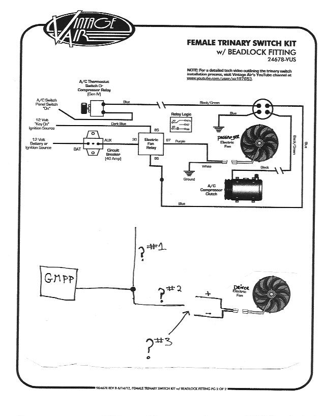

gmpp ls3 controller help
Well i just installed my harness today. Everything seems pretty simple. Now i have a few questions i hope you can all help me with. Attached is the instructions
http://paceperformance.com/attachment/117731-.pdf
1. It looks like the ecu controls the fan. How do i connect the two fans to the ecu? are relays already built in for this?
2. the harness connects to the engine coolant temp and oil pressure sensors. The vss connected into the t56 magnum also so how do i get the speedometer and rpm gauges to work? How do i hook them up to my gauges now? Gauges are autometer.
Any advice would be great.

Oil pressure - Run a wire from the oil pressure gauge to the tan/white strip wire in the bulkhead connector which is position H. Run the ground from the gauge to the M bulkhead connector. I could actually just run one wire from the M bulkhead connector and use that for all of my grounds for my gauges correct?
tach - Run a wire from the gauge to the white wire on the bulkhead which is position C. would i need a ground for this?
Speedometer - Run a wire from the gauge to the brown wire on the bulkhead which is position D. Would i also need a ground for this?
Fuel pump - Looks like theres a wire coming from the fuse box labeled fuel pump according to the instructions. I will check tomorrow. If that is the case then all i have to do is extend that wire to the fuel pump.
Fan power - Looks like the same place the fuel pump line is theres another wire that says cooling fan and is also fused/ relayed. If thats the case running one wire to the front of the car won't be that bad. Maybe ill run that wire into the american autowire fuse panel so i can route it under the fender on the drivers side. What else would be needed to make the fans run?
Now what about coolant temp? Doesn't make sense that the harness is connected to the coolant temp sensor in the side of the block yet theres no where in the bulkhead connector to run a wire to for the gauges.

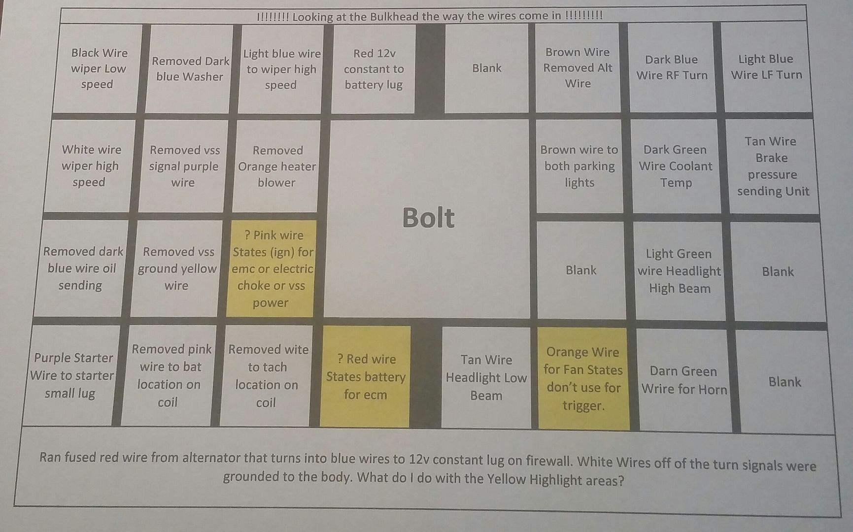

Updated notes
Hook the vss output wire ( brown ) from the ecm bulkhead to the speedometer signal wire
- Hook the tach ( white ) from the ecm bulkhead to the gauge tach signal wire
- Hook the Oil pressure ( Tan/white ) from the ecm bulkhead to the gauges signal wire
- For the water temperature, there is a port located on the right side (passenger side) of the engine, in the cylinder head, past the last exhaust port (closest to the firewall / flywheel). There is a plug threaded in this location, that can be removed. This threaded in plug will either require an 8mm Allen Wrench, or a T52 Torx bit. There will be no noticeable difference in temperature reading when using the shorter sender. The 2277 adapter requires a 3/4" wrench, and the 2259 sender requires a 12mm wrench. Be careful to only tighten the adapter into the head until the crush washer is flattened. Do not over tighten.
- for the voltmeter just hook up the ignition wire from the gauge harness to the gauge
- Samoco reverse lockout solenoid is order. http://www.wirebarn.com/T56--TR6060-...ule_p_470.html
- The dse wiper is going to run into the harness also. Thats why i removed the factory wiper wires. I already have the dse wiper motor.
-Maybe I'm just overthinking it? Does this sound right or I'm i screwing something up?
So far i removed the lt blue wiper wire ( wiper high speed ) dk blue wiper wire ( washer pump ), black ground wire ( wiper low speed ), white wire ( washer and high speed wiper ), purple wire ( vss signal ), Yellow ( vss ground ), orange wire ( Heater blower ), dk blue ( oil pressure ), White wire ( tach ), wires from the engine bulkhead connector
That leaves me with 5 wires :
- starter Red wire - Goes to the Battery lead on the starter solenoid. Runs from the bulkhead connector to brown connector. Seems like i can just ignore the brown wire and connect it directly the red wire. Run the same color red wire from the back of the alternator to the starter which goes on the same stud as the red bulkhead connector wire. This same spot that i run this wire the battery also connects on here. Battery gives the system 12v but once the car starts the alternator then feeds all of this
- ecm Red wire - Didn't use this wire in the engine harness but still in the bulkhead since the power source and ecm are inside the car. This is the battery feed wire. I can prob run it off of the studs on the gmpp pole or to the firewall bulkhead connector. Is this the feed wire for the ecm power or a 12v input from the ecu output to feed the cars 12v constant source? sounds like its the feed wire for the ecm but if I'm connecting the gmpp fuse box directly to the battery bulkhead this wire shouldn't be needed right?
- Starter pink wire - This wire would get routed to the ballast resistor which the other end of the ballast resistor would connect to a distributor ( which i don't have ) and then the R side of the starter solenoid. Would i just run this wire to the starter solenoid? Is this then my ignition output for my entire car?
- ecm Pink wire - didn't use this wire in the engine harness but still in the bulkhead since the ecm and power feed are inside the car. Is this the ignition feed in for the ecu or ignition feed out from the ecu for the cars ignition system?
- Purple wire - ran to the S part on the starter solenoid. This is prob the output from the ignition to complete the starter circuit to engage the starter solenoid to start the car.
Extra info.
My battery bulkhead is on the passenger floor board
To supply my ecm with battery power I'm going to run my power wire from my bulkhead connector to the ecm which is beside each other.

cjsgarage 10-31-2015 04:26 PM
Randy.. that's a ton of info.. and it's correct.. but you should just be able to hook the white wire up and set your tach to 4 cylinder mode. If you can't set it to 4 cylinder mode, we can work out a way to make it work.
The remaining 5 wires need to be hooked up as follows:
2 reds to battery constant voltage.
2 pinks wires are FROM ignition switch KEY ON power TO the ends of the pink wires
Purple is indeed the start wire. It goes from the small lug on the starter to the START function of the ignition switch. FROM ignition switch START to the end of the purple wire..

NOW This is where I'm at. I will update the front light harness in alittle. Headlights, turn signals, and horn wires are all good
http://i30.photobucket.com/albums/c3...5_005921-1.jpg
Anyone?
1. Red Wires states battery for ecm - Should be a constant so since I'm running the gmpp kit which ill connect directly to the lug coming from the battery this isn't needed correct?
2. Pink wire for ecm - Instead of running this to the outside bulkhead connector should i just unplug it from the female version of the bulkhead connector and run this line inside the car to the gmpp kit? What is everyone else doing for the ignition source of the gmpp kit?
3. Pink wire for bat location on the coil - What should i do with this? remove it from the engine harness of the AAW kit? Possible use this in the future for a accessory ignition source?
4. reverse light wires from the AAW kit - I think its a ignition ( pink ) and LT Green wire. Just run these wires to the right side of the t56 switch? How did you route this wire? Just make a hole in the tunnel?
Vega$69 11-22-2015 08:56 AM
Originally Posted by randy (Post 622306)
Anyone?
1. Red Wires states battery for ecm - Should be a constant so since I'm running the gmpp kit which ill connect directly to the lug coming from the battery this isn't needed correct? Correct
2. Pink wire for ecm - Instead of running this to the outside bulkhead connector should i just unplug it from the female version of the bulkhead connector and run this line inside the car to the gmpp kit? What is everyone else doing for the ignition source of the gmpp kit? Any switched 12V works. I would pick it up inside the car if that's where your ECU is
3. Pink wire for bat location on the coil - What should i do with this? remove it from the engine harness of the AAW kit? Possible use this in the future for a accessory ignition source? Yes and Yes
4. reverse light wires from the AAW kit - I think its a ignition ( pink ) and LT Green wire. Just run these wires to the right side of the t56 switch? How did you route this wire? Just make a hole in the tunnel?That works
Here you go
randy 11-22-2015 10:35 AM
thank you. Things are chugging along.
Headlights, front turns, rear tails all work
How do i know which the vss ground and vss signal wire is coming from the GMPP kit? They just state vss high and vss low. I need to know this to hook up my samco reverse lock out wiring.
4 wires come from the samco unit and 2 wires to the reverse lights so ill most likely just run a 4 wire connector to the to the transmission and route it thru the gas pedal mount hole which i still need a cover for.
updated bulkhead connector. BTW putting the DSE wiper motor in the bulkhead was very easy.
Install the wires in the dse motor bulkhead. Route them to the AAW bulkhead. Cut all the wires. Put the correct ends on the dse bulkhead wire ends and plug into the engine bulkhead connector. Route the same color wires in the inside of the fuse box except the yellow wire. Remove the white wire from the fuse box from the fuse side and the engine side and replace that with the yellow wire. Now take the dse fuse out and install it in the wiper fuse location of the AAW kit. Pretty simple
Current bulkhead layout.

randy 12-13-2015 05:15 PM
gmpp/ vintage air fan wiring
The line coming from the GMPP harness is it a ground or 12v feed?
#1 where does the feed from the GMPP harness go to so it ties into the passenger fan? Im guessing #86 since i think its a ground
#2 Sorta the same question as above. Is the gmpp line a ground or 12v feed? If a ground Then i would need to supply the fan with a 12v feed. If its a 12v feed then run that wire directly to the positive on the fan and ground the fan.
#3 Do i need a relay between the GMPP kit signal wire to the drivers side fan since the line is already fused and relayed according to the instructions?
http://i30.photobucket.com/albums/c3.../Scan%201.jpeg

randy 12-14-2015 08:19 PM
yes but i want my gmpp controller to turn on both fans when the temp gets to the correct level but have the vintage air unit only turn on the secondary fan.
Short version
gmpp controls driver and passenger fan
Vintage air controls passanger fan only
How do i combine the gmpp signal as another signal activation in the vintage air wiring?
Vince@Meanstreets 12-14-2015 09:40 PM
Short version
The PCM uses a grounding circuit....which goes to the relay not directly to the fan.
edit, according to your diagram it would be pin 86
just use switched ground from va trinary to gmpp fan relay to trigger fans
or:
check out pcmofnc.com, they have a 2 speed dual fan kit for the gmpp controller and an a/c fan bump circuit. Requires adding relays and pins to the gmpp load center and a patch for the pcm. The a/c circuit requires trigger 12v so can work with va binary. They provide everything (including instructions and diagrams) to get it done. Good stuff.
http://pcmofnc.com/index.php/lshotrod
btw: you can add a pin to one of the gmpp pcm connectors to activate rlo to work like factory
Oh, the big grey wire is the power feed for fans, you need this wire
randy 12-15-2015 06:31 PM
thats exactly that i was thinking since pin 86 is where you would also install a manual override switch. Instead of having a toggle switch as a manual I'm really just replacing it with a ecu switch . Thank you and this makes it very easy.
Do i just split the ecu wire and one going to the fan and the other to pin 86 of the other fan or do i need to split it and run the split into two relays?

Vince@Meanstreets 12-15-2015 10:31 PM
you have two wires right? do you have two fans? if so you run one relay per fan.

Vince@Meanstreets 12-16-2015 12:03 PM
I would run two relays and split the wire to trigger both replays @ 86, tee the Vintage air into one 86 so the 1 fan comes on when the trinary trips to cool the condenser.
randy 12-16-2015 02:39 PM
My thoughts also.

randy 12-16-2015 08:31 PM
If the GMPP kit trigger wire goes to 86 and is split and i hook the trinary trigger one to one of the 86 relays wouldn't it actually supply both of the 86 relays? Its almost like i need a relay to that accepts two triggers
randy 12-17-2015 07:03 PM
which one is correct? I need the AC override to be a 12v signal which my GMPP signal is.
Feed coming from the 30 post on the Vintage air relay?
http://i30.photobucket.com/albums/c3.../Scan%202.jpeg
Or feed coming from the 87 post on the vintage air relay?http://i30.photobucket.com/albums/c3...19/Scan_3.jpeg
