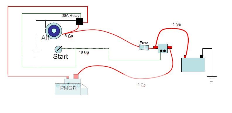

Heres one way.
You don't have to use the relay on the starter curcuit,some just use a jumper at the starter.
[IMG]http://i884.photobucket.com/albums/a...pse954689d.jpg[/IMG]
