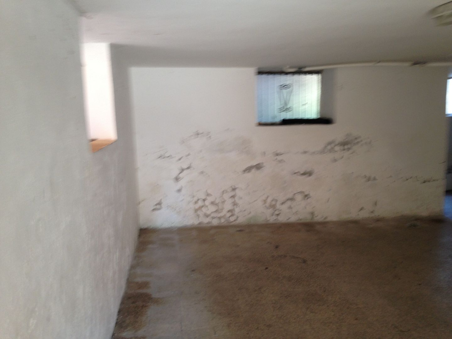

Here's the house we're renting; garage is the basement level.
http://i102.photobucket.com/albums/m...pscpfetgdv.jpg
Garage is decent size - fits my tools with room for the Alfa and one of our daily drivers.
From garage door looking towards back wall. This is before it was painted and before my tools arrived.
http://i102.photobucket.com/albums/m...pshjfkwfek.jpg

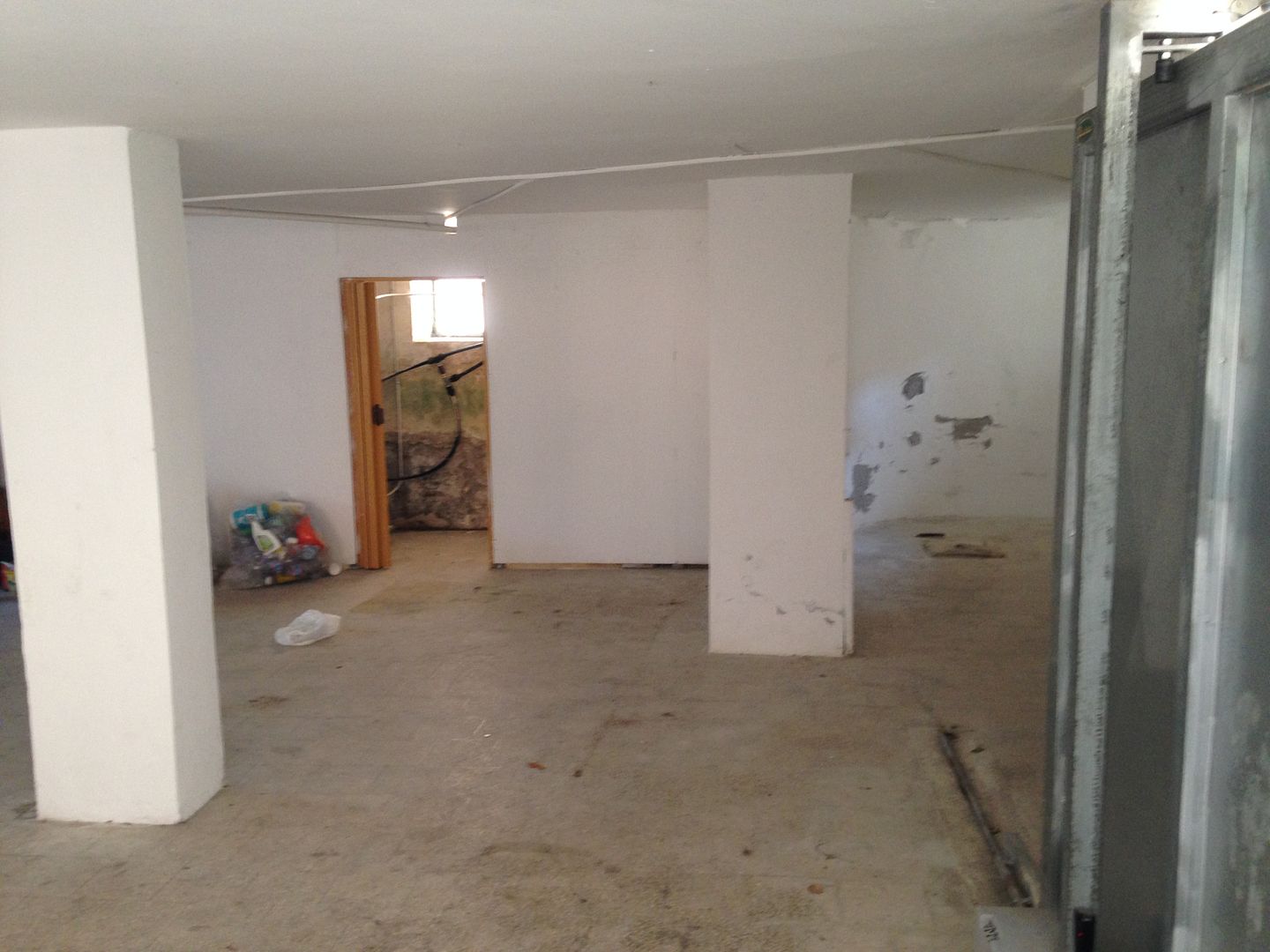

Same spot, looking towards the far corner.
http://i102.photobucket.com/albums/m...pspucjaewg.jpg

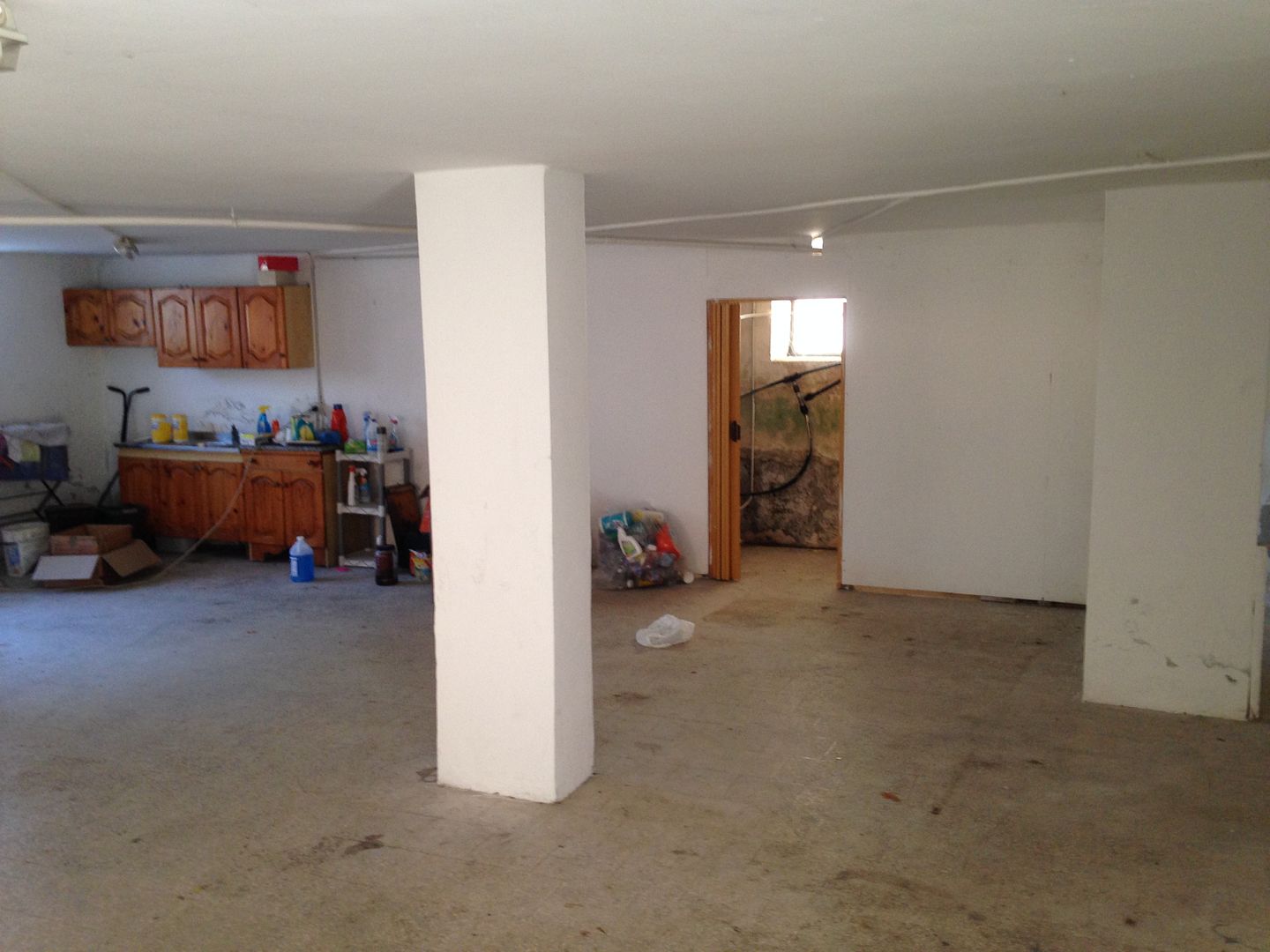

And looking to the right.
http://i102.photobucket.com/albums/m...psfnatp0iu.jpg
It's still a bit of a mess now, but I'm getting there. This gives you an idea of the dimensions and setup. Guess I need to figure out how to resize this picture...

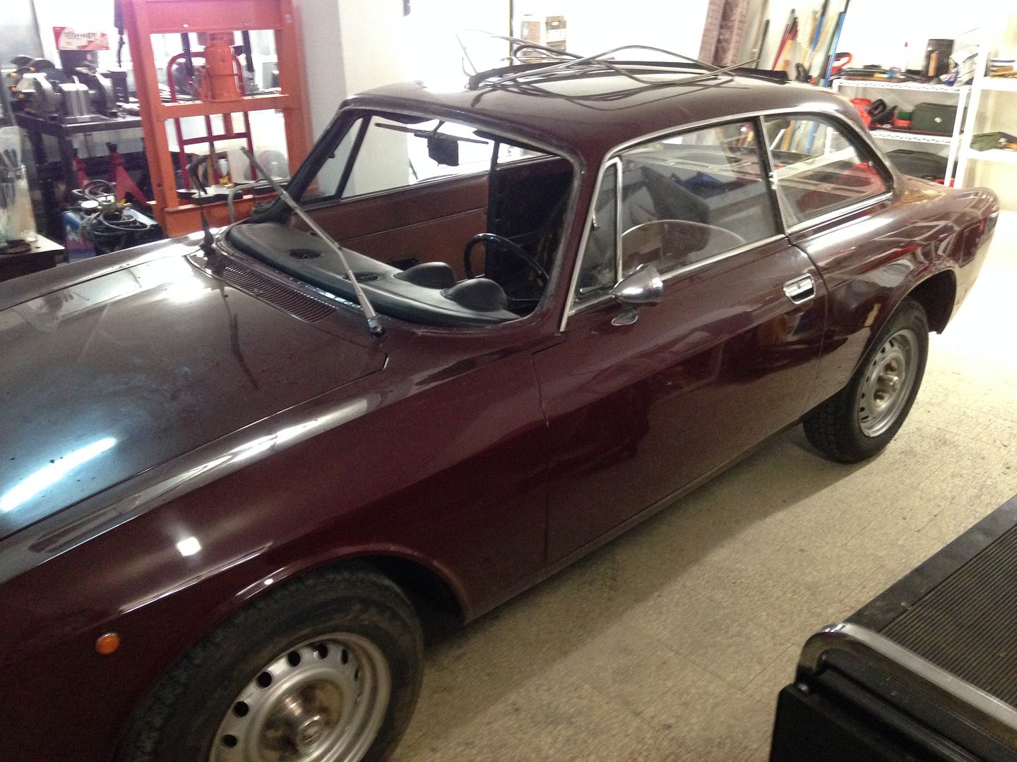

A few more car pictures.
Interior was all original and in decent shape.
http://i102.photobucket.com/albums/m...pssvz3jekt.jpg

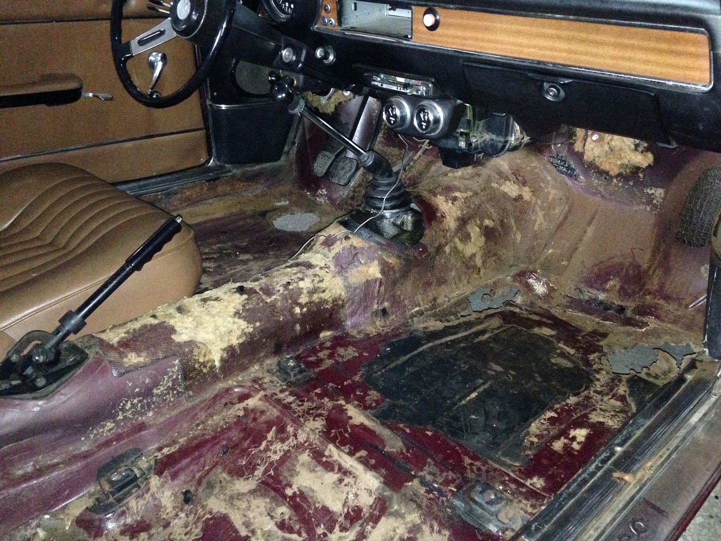

Interior is all out, of course. Front floor pans will need some patching.
http://i102.photobucket.com/albums/m...pskooj3e1b.jpg
