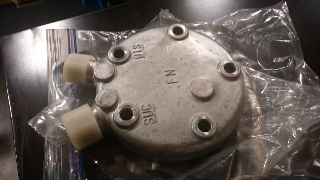

SSLance 12-06-2015 10:30 AM
So I found this this morning on a shelf in my shop.
http://img.photobucket.com/albums/v3...psbmsbdcgn.jpg
It's a different back to my compressor which is clockable so it lets the lines connect in just about any direction I need them to. It also lets me find the hose fittings I need for at least those ends of the hoses.
