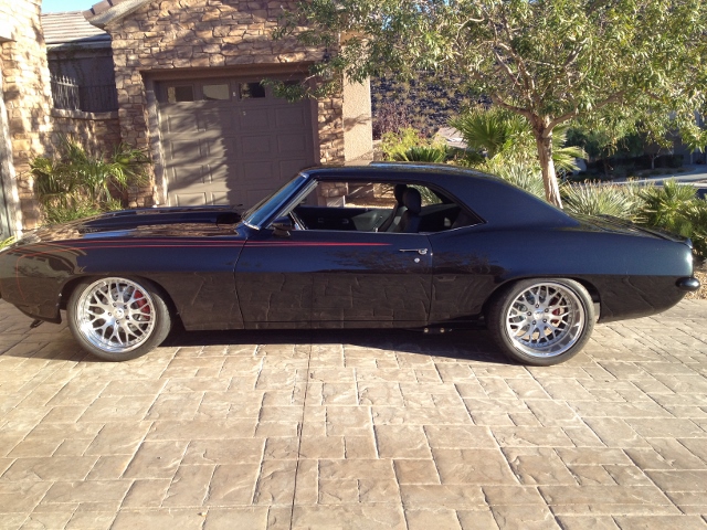

Vega$69 01-22-2016 06:28 PM
1 Attachment(s)
2nd Gen mirrors with remote drivers side on my 69.
Attachment 57163
