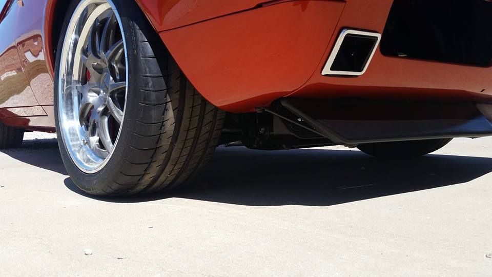

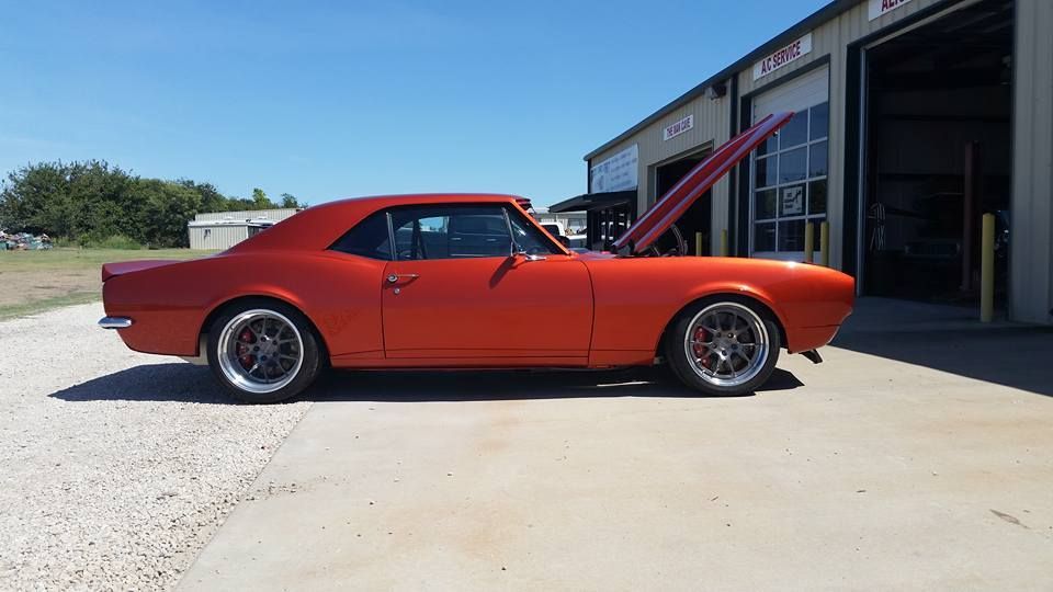

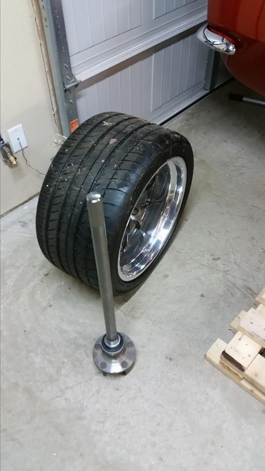

Im running 315/30 on the rear so the tire to rim angle matches perfect. Ive done a ton of research on this. I didn't want to have tire bulge or suck in on the rims at all. Hope that makes sense. I wanted them to match perfectly.
This is ride height. Tire is slightly tucked
http://i30.photobucket.com/albums/c3...21221361_n.jpg
Here you can see how the tire sits on the rim
http://i30.photobucket.com/albums/c3...27648773_n.jpg
Heres how the rear sits on the rim
http://i30.photobucket.com/albums/c3...81331521_n.jpg
