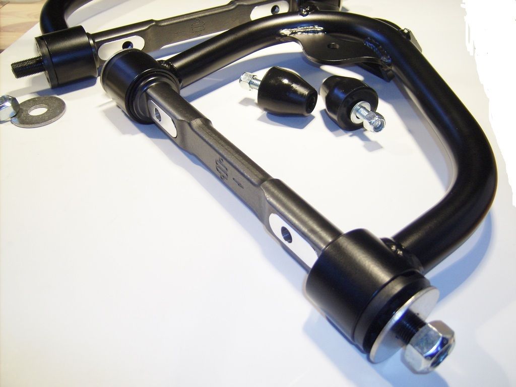

paulk68 03-28-2016 08:31 AM
does anyone have pictures of the two different style A-Arms I would like to make sure I have the new style as I really do not want to run into any more issues.
Stovebolter 03-28-2016 03:27 PM
Paul, when did you purchase yours? I believe they made a change in late 2013 that corrected the issue I'm having. And not everyone with the first production run is having the issue I'm having. May be a difference in cars as odd as that sounds.
Does your upper cross shaft have the adjustable aluminum slugs in it for caster angle adjustment? If so, you have the latest design and should be okay.
Rod P 03-28-2016 03:52 PM
new style
http://i752.photobucket.com/albums/x...psbnedtbop.jpg
paulk68 03-28-2016 04:07 PM
Originally Posted by Rod P (Post 633652)
Thanks guys, yes I have the newer version with the slugs.

Stovebolter 03-28-2016 05:33 PM
We were just helping him determine what production run he had. As far as I know the 2nd production run included their newer uppers with the adjustable caster slugs.
