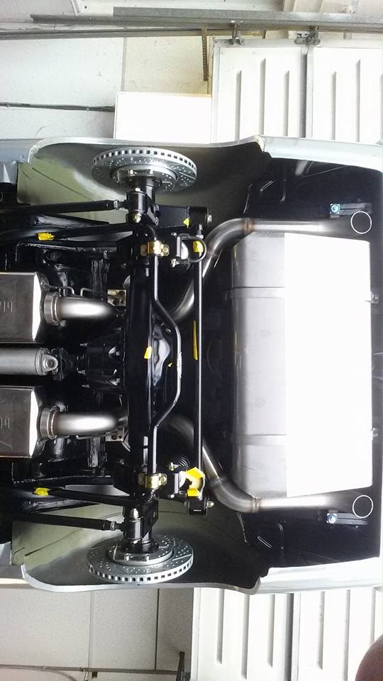

gnx7 05-11-2016 11:44 PM
1 Attachment(s)
I do like Magnaflow but they can be pretty loud. My dual 3" into a single 3.5" is LOUD. It even has dual 3" cats on it (hi flow) and still went 138mph in the 1/4 all motor.
Dynomax makes an UltraFlo which is one of the quieter mufflers I have run.
http://www.dynomax.com/mufflers/ultr...elded-mufflers
Here was my Laguna Seca 92db exhaust.... single 3.5" into dual 3" UltraFlo mufflers. It was stupid quiet and still ran 1:33 there not fully pushing it. 2470lbs wet.... 12:1 compression 438ci with stock LS3 heads/intake, GSR dog box, 18x12's all corners only 530rwhp/510rwtq but torque everywhere.

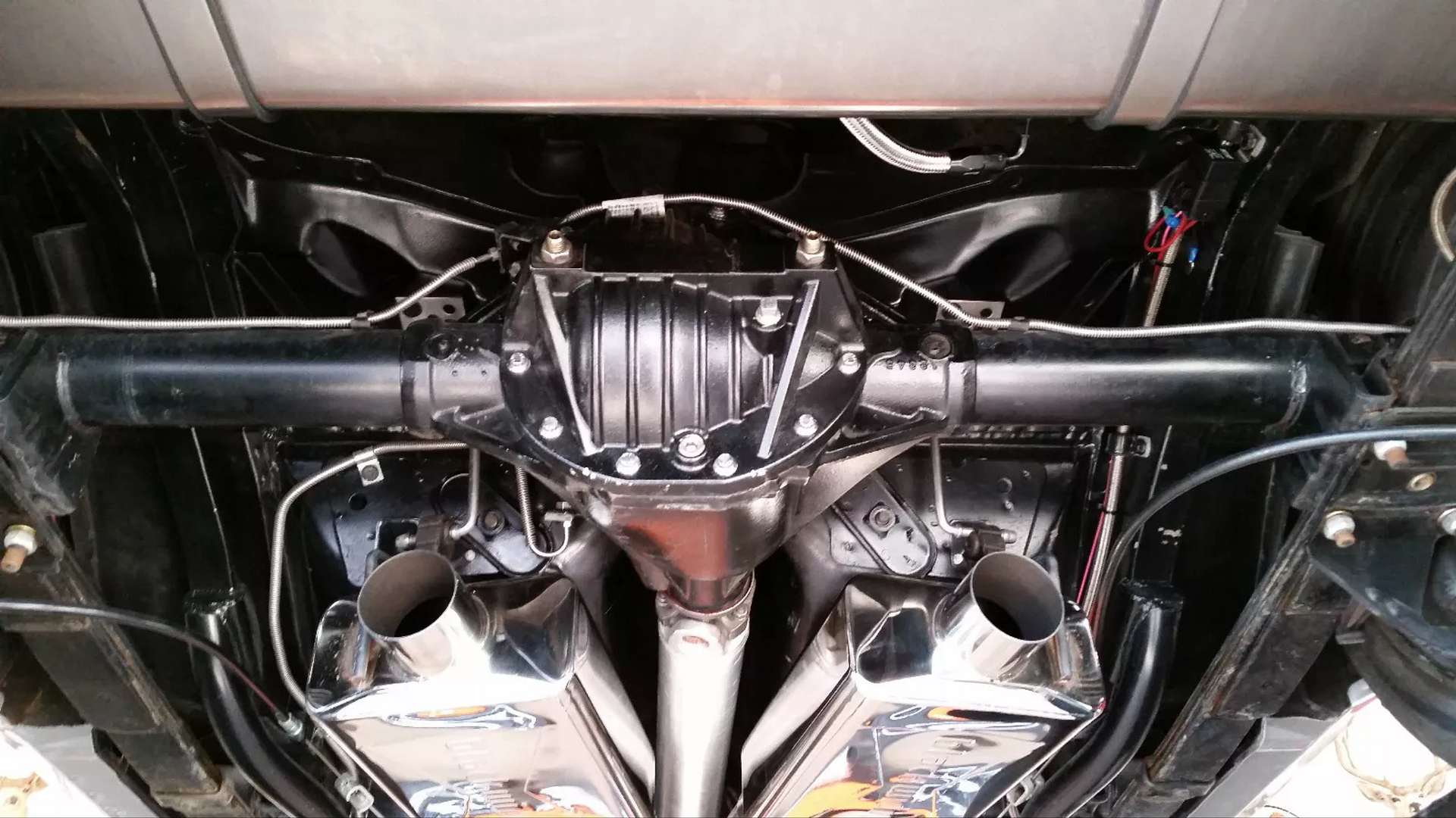

l2azorback 08-19-2016 06:05 AM
I am running the Black Widow Pro Venoms, and really like them. I'm one of the few running a big block in my car (Shafiroff 540 Ultra Street) and recently converted the car over to a complete DSE set-up and had the opportunity to have the exhaust redone.....I did however, keep my Black Widows and incorporated them into the new exhaust system.
Old set-up....
http://i190.photobucket.com/albums/z...psvlkvdm3s.png
New set-up with DSE Q-link and 3-inch exhaust...
http://i190.photobucket.com/albums/z...psdwcmcsfp.jpg
http://i190.photobucket.com/albums/z...psi7dhusxv.jpg
