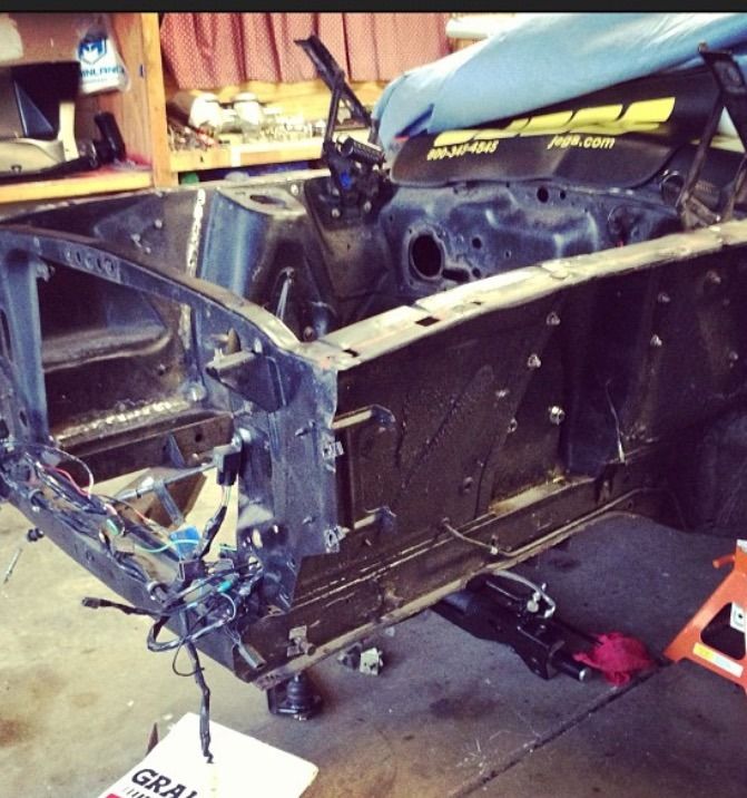

and now basically have the car to the point where it has no fenders, hood , deck lid etc. Been doing lots of little rust repair that I didn't find back when the "foosish" paint job was applied

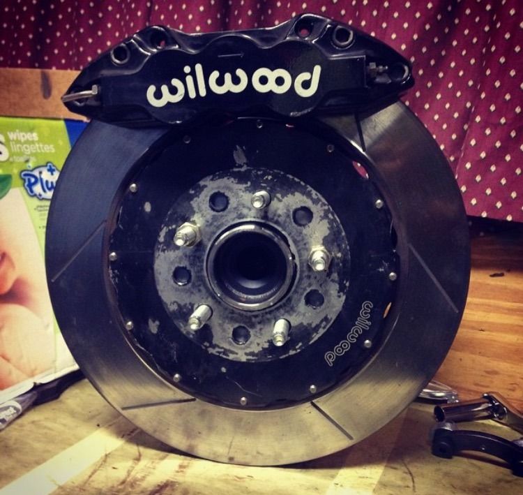

Wilwood F-14.25" W6A 6 piston setup for a corvette that I re-drilled the rotor hat for 5x4.5" bolt pattern. Scored this used setup from Matt A.

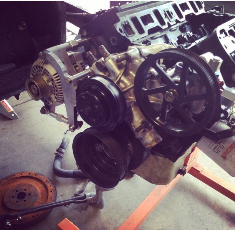

I have also gone ahead and sourced my own serpentine setup, going to use a factory fox body style kit with a KRC pump (valved and flow tested to make sure its meeting DSE spec for the R&P) I found an old article where maximum motor sports was using a KRC pump on foxbodies, but KRC changed mounting on their pumps and maximum motorsports discontinued the kit. A quick call to MM netted them having a bracket left which I re-drilled, and will re shape to fit my KRC pump I now have.
I will be using the mr go fast setup to mount my alternator and will be able to use that as my means of belt tensioning I am using the kit he offers for a mechanical pump http://www.yellowbullet.com/forum/sh...d.php?t=431324

67XR7 05-02-2016 09:44 AM

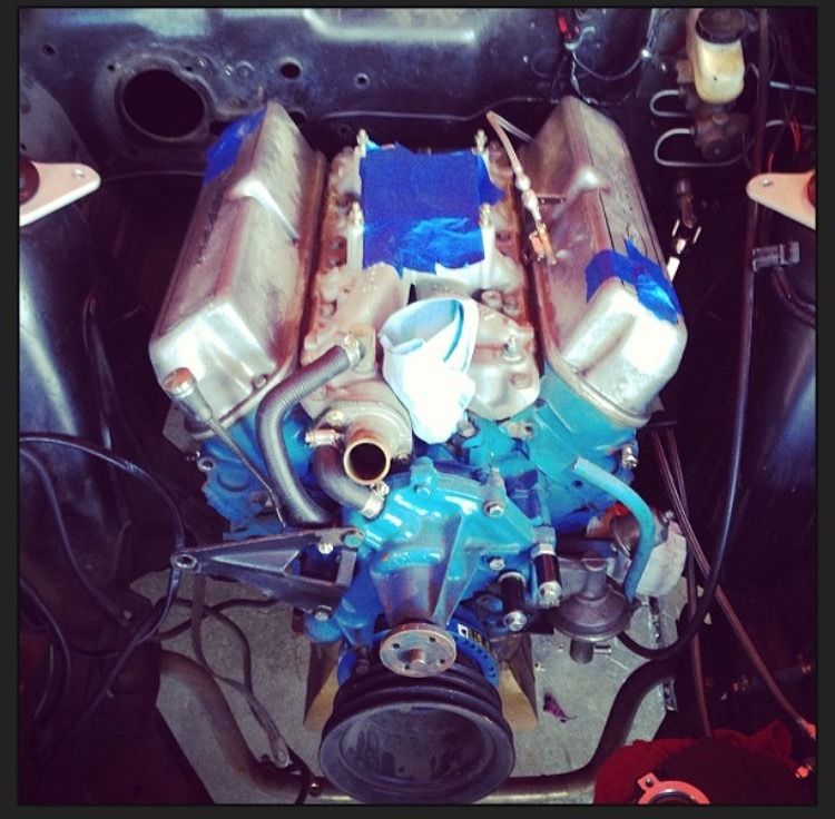

starting with removal of the very first motor I built back in 1999 and basic tear down:
http://i1175.photobucket.com/albums/...s1lszukaz.jpeg
http://i1175.photobucket.com/albums/...sh6roru7v.jpeg
http://i1175.photobucket.com/albums/...subuz9jup.jpeg

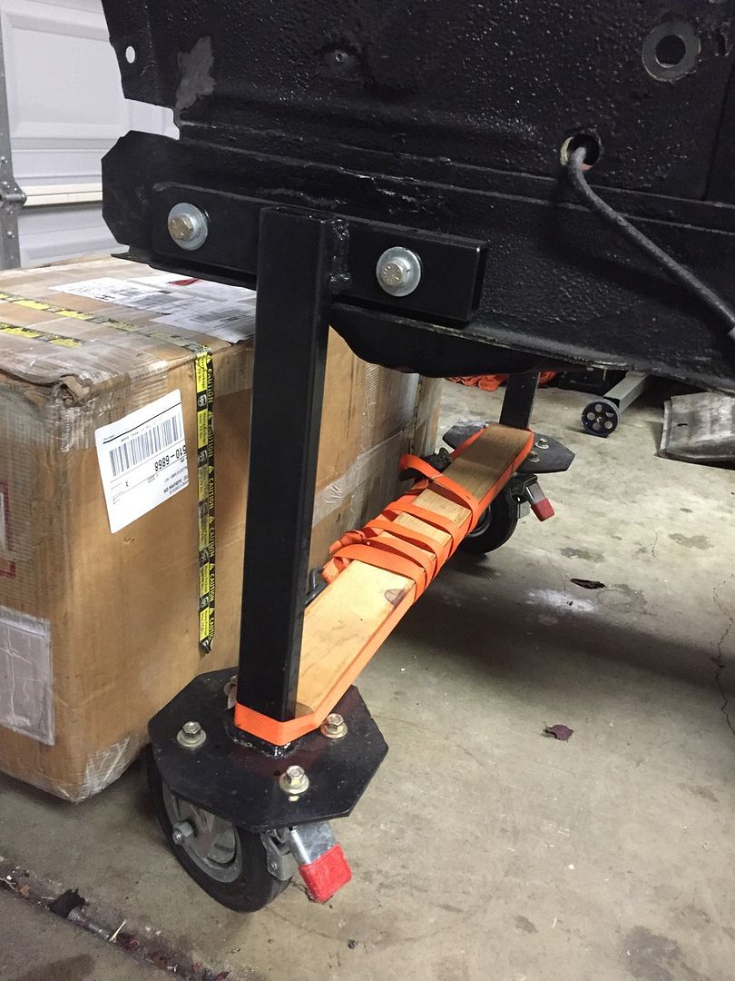

put the rear wheels on car dollies and built these castor legs for up front.
http://i1175.photobucket.com/albums/...psqr8hqalx.jpg

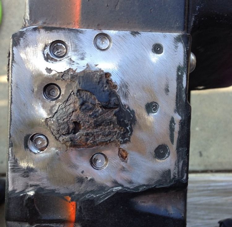

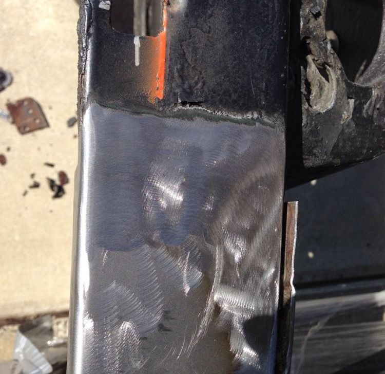

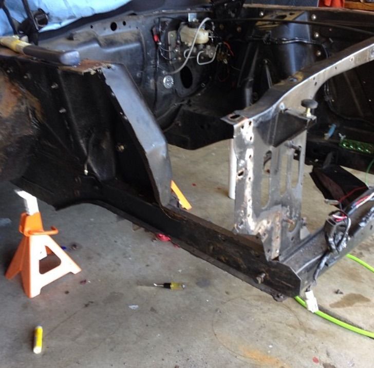

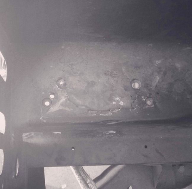

Found some cancer that was never really taken care of when the car was painted originally:
http://i1175.photobucket.com/albums/...sc6jsp7ng.jpeg
http://i1175.photobucket.com/albums/...smr5xxpbe.jpeg
http://i1175.photobucket.com/albums/...sluu0wjqa.jpeg
http://i1175.photobucket.com/albums/...srt3tk58x.jpeg
http://i1175.photobucket.com/albums/...slxucwkr0.jpeg

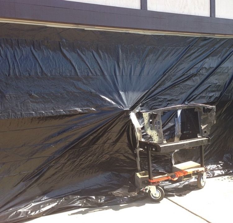

also tried my hand at soda blasting, it didn't work out too well, maybe the cheap blasting equipment or my 60 gal 5 hp compressor wasn't up to the task. Sometimes you have to give something a shot, I was at least able to clean what I really needed to and do touch ups with a spot blast gun.
http://i1175.photobucket.com/albums/...szkla90p3.jpeg

used my cousins 331 from a foxbody he had to do my front accessory mock up
http://i1175.photobucket.com/albums/...swsgpjedx.jpeg

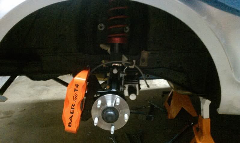

used 6 piston w6A kit re-drilled and now fits my spindle/hub setup
http://i1175.photobucket.com/albums/...s8lsw8zfi.jpeg

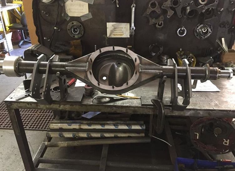

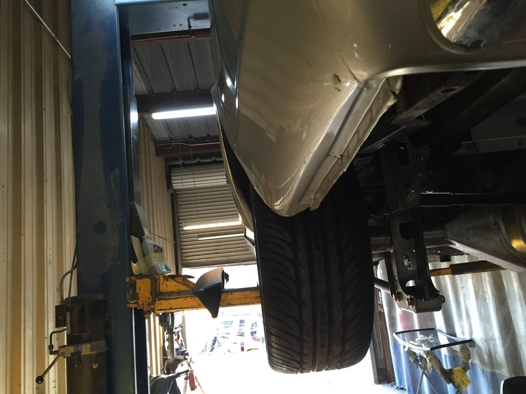

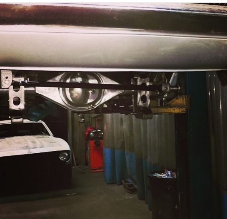

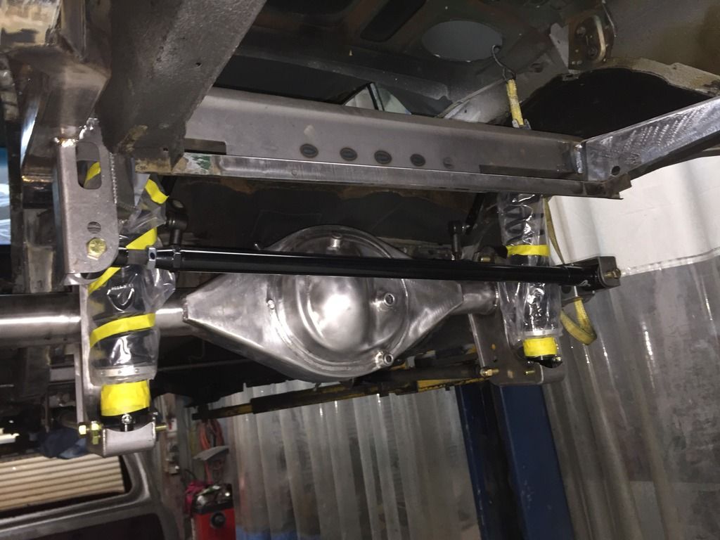

Used a Mustang Quadralink that had to be modified to accommodate the extra wheel base length of the cougar.
Went with a modlite floater from speedway, I actually was in the area heading to disneyland and Ken gave me a tour where I got to see my rearend housing being done.
http://i1175.photobucket.com/albums/...s6gt7fsm1.jpeg
A friend of mine who has a paint shop performed the install of the quadralink, there are a few little spots where added gussets need to be finished , I will have the task of finishing the tubs and doing the subframe connectors.
http://i1175.photobucket.com/albums/...ps6j7q75gt.jpg
http://i1175.photobucket.com/albums/...psgb2k416h.jpg
http://i1175.photobucket.com/albums/...shjiz415m.jpeg

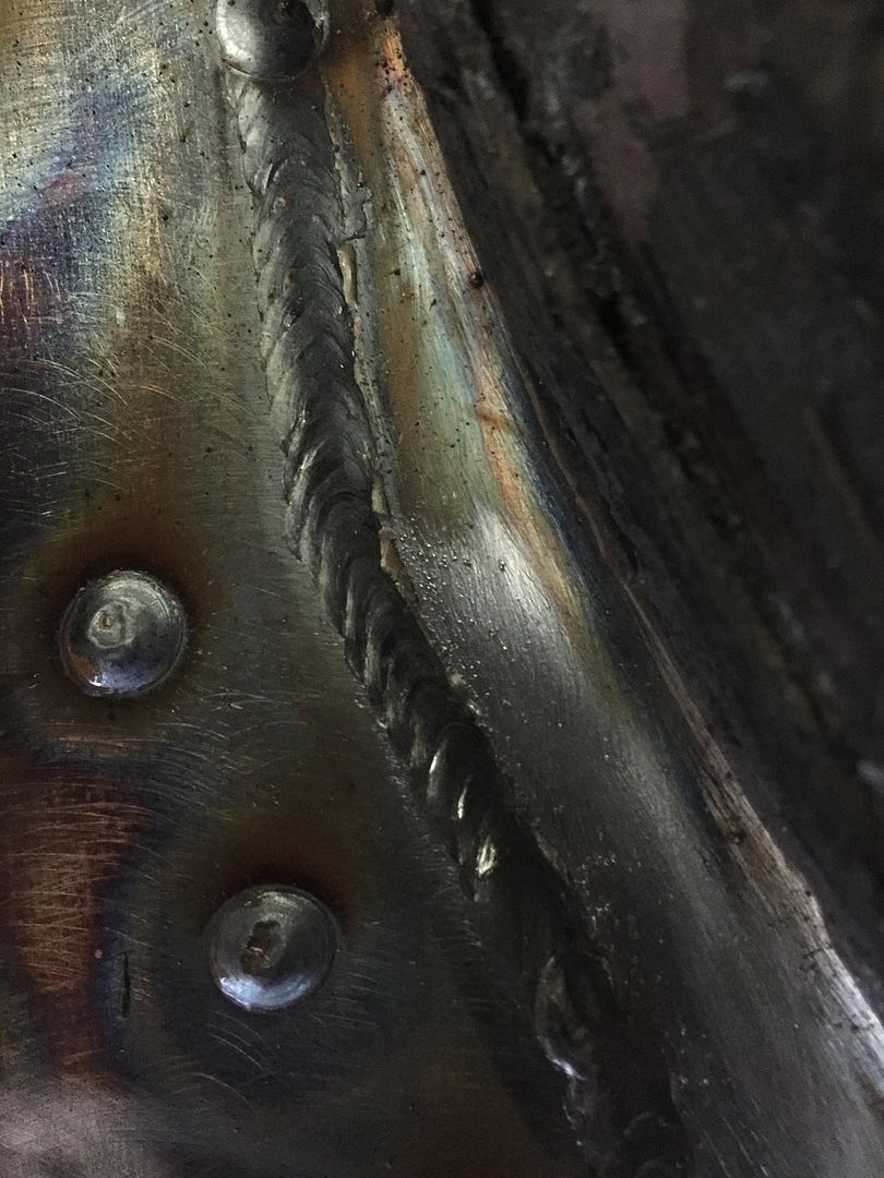

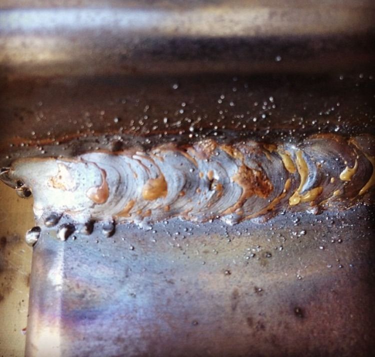

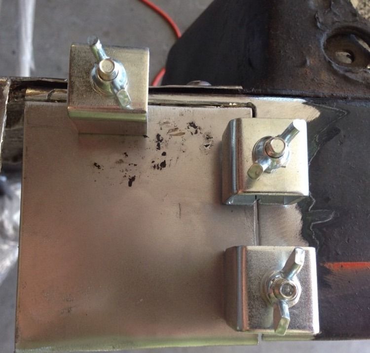

my mig welding has been getting better
http://i1175.photobucket.com/albums/...shfyhnlxz.jpeg

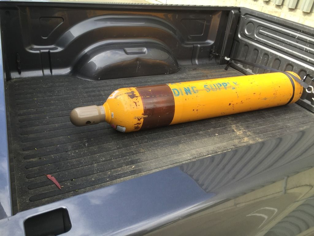

and when your LWS doesnt have the size bottle you want but instead offers you two sizes up for the same price with the first fill up free well................. you end up with a 300 cu.ft. bottle
http://i1175.photobucket.com/albums/...ps9sszozhc.jpg

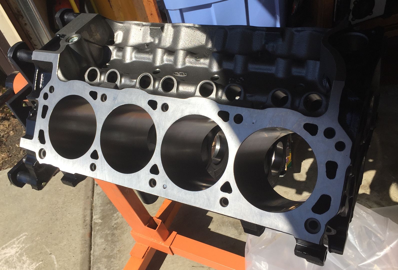

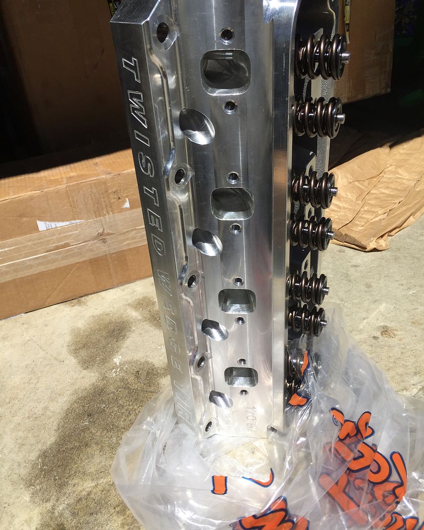

Quick little update. While waiting for my top end package to arrive for the 302 from Ed Curtis at FTI, my cousin ran into some issues and needed a motor for his car. So he bought the 302 and this is where I'm at now
TFS 11r 170 CnC heads that Ed setup with pac springs
http://i1175.photobucket.com/albums/...pskqxt4yv6.jpg
And a no frills basic 333 Stroker DIY package from Jim woods at www.fordstrokers.com should make 10:12:1 static. Ed also port matched and ported a Victor Jr carb intake and then spec'd out a fairly stout custom ground billet HR camshaft
http://i1175.photobucket.com/albums/...psyfxhv3ni.jpg
http://i1175.photobucket.com/albums/...pslcijbve7.jpg
