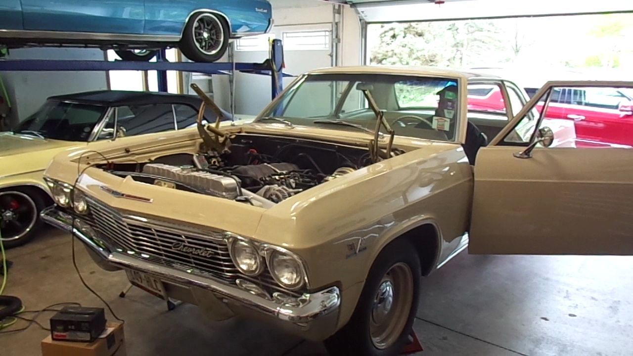

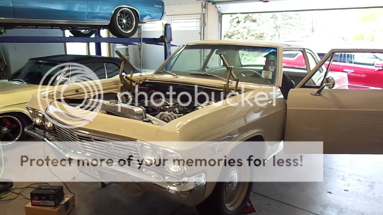

kwhizz 05-14-2016 12:11 PM
Two weeks working on it just a couple of hours a day.........Will it start ????
http://i13.photobucket.com/albums/a2...h_MAH02518.mp4
kwhizz 05-14-2016 12:52 PM
http://vid13.photobucket.com/albums/...y/MAH02518.mp4
TomM 05-14-2016 01:11 PM
Oh the sweet sound of success.......
