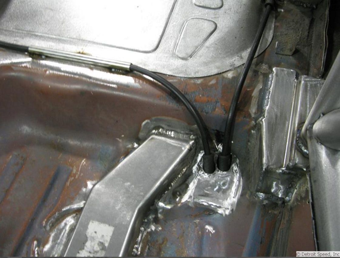

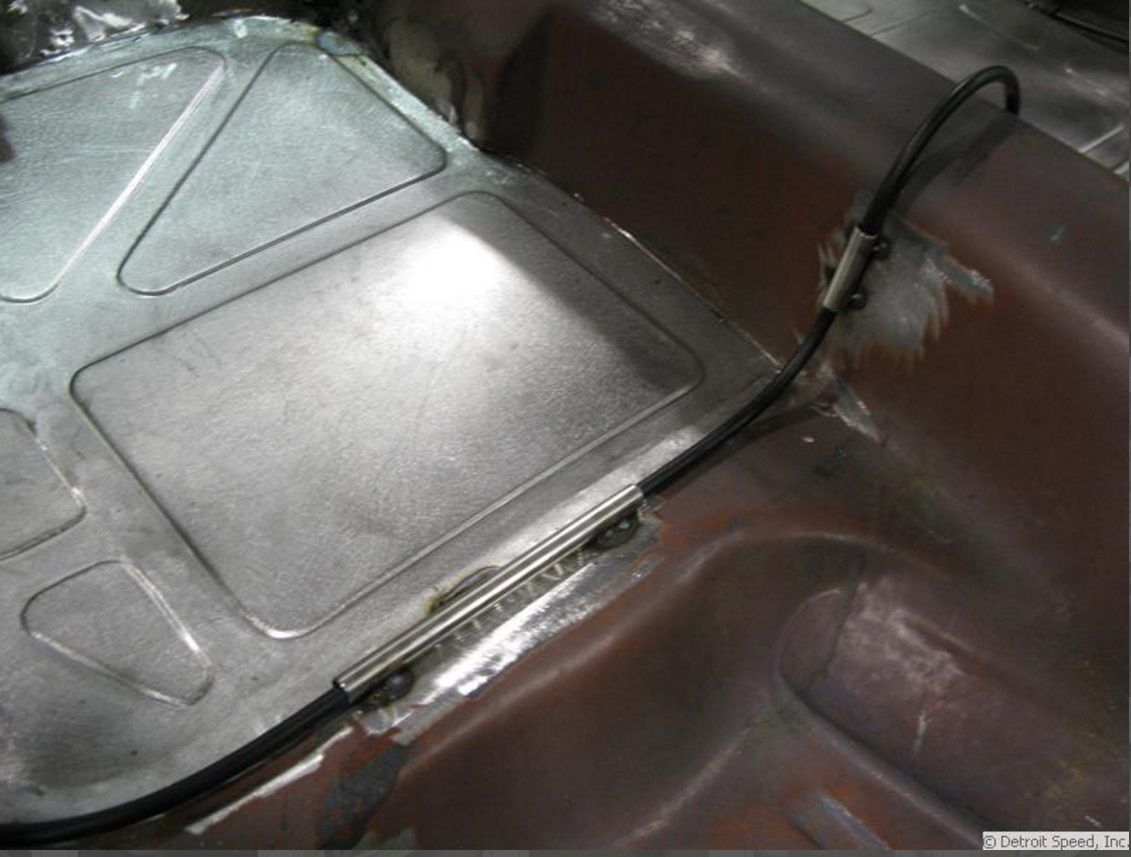

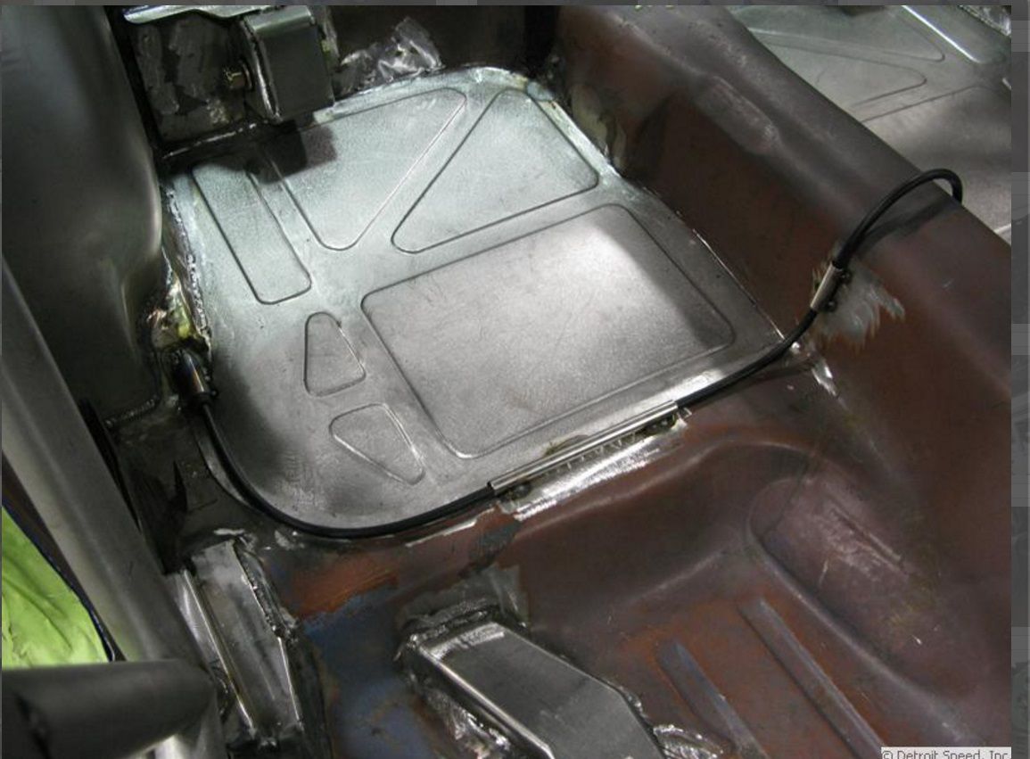

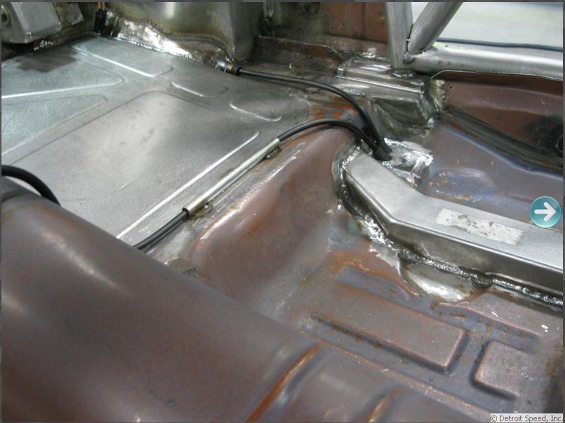

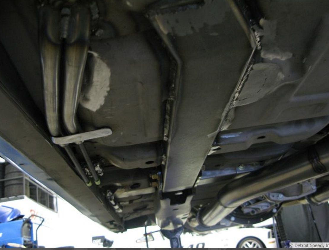

Sandro's 1969 502 Camaro 03-19-2017 09:34 PM
I used the Lokar cables as well. I got the idea off the DSE site. Mine are routed through the inside of the car and out the back to the brake calipers.
cpd004 03-20-2017 05:27 AM
I'll take a look at DSE's site. I've only seen one where they were run inside the car. I didn't like how they exited the interior next to the bottom of the wheel tubs on either side. The guy just drilled about a 1/2" hole and passed them through.

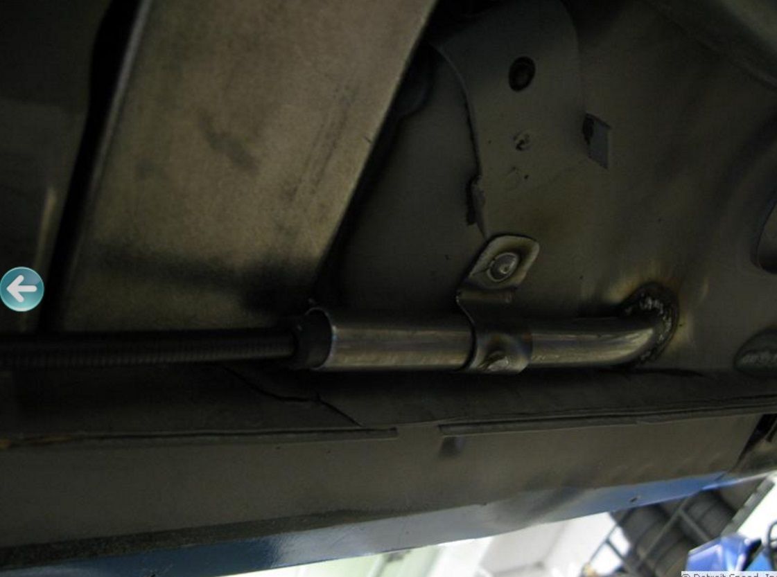

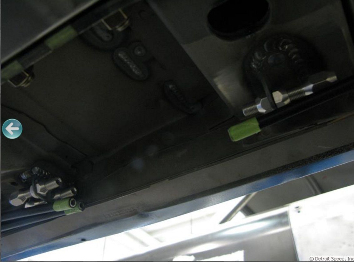

Doug1 04-21-2017 11:02 AM
I saved these from the DSE site for my own info.
http://i213.photobucket.com/albums/c...pskcpp2jbv.jpg
http://i213.photobucket.com/albums/c...pshgtqihjn.jpg
http://i213.photobucket.com/albums/c...pstddylavs.jpg
http://i213.photobucket.com/albums/c...pscz6aslib.jpg
http://i213.photobucket.com/albums/c...pskdes6fi5.jpg
http://i213.photobucket.com/albums/c...psherc8vj4.jpg
http://i213.photobucket.com/albums/c...psngd1inv6.jpg
