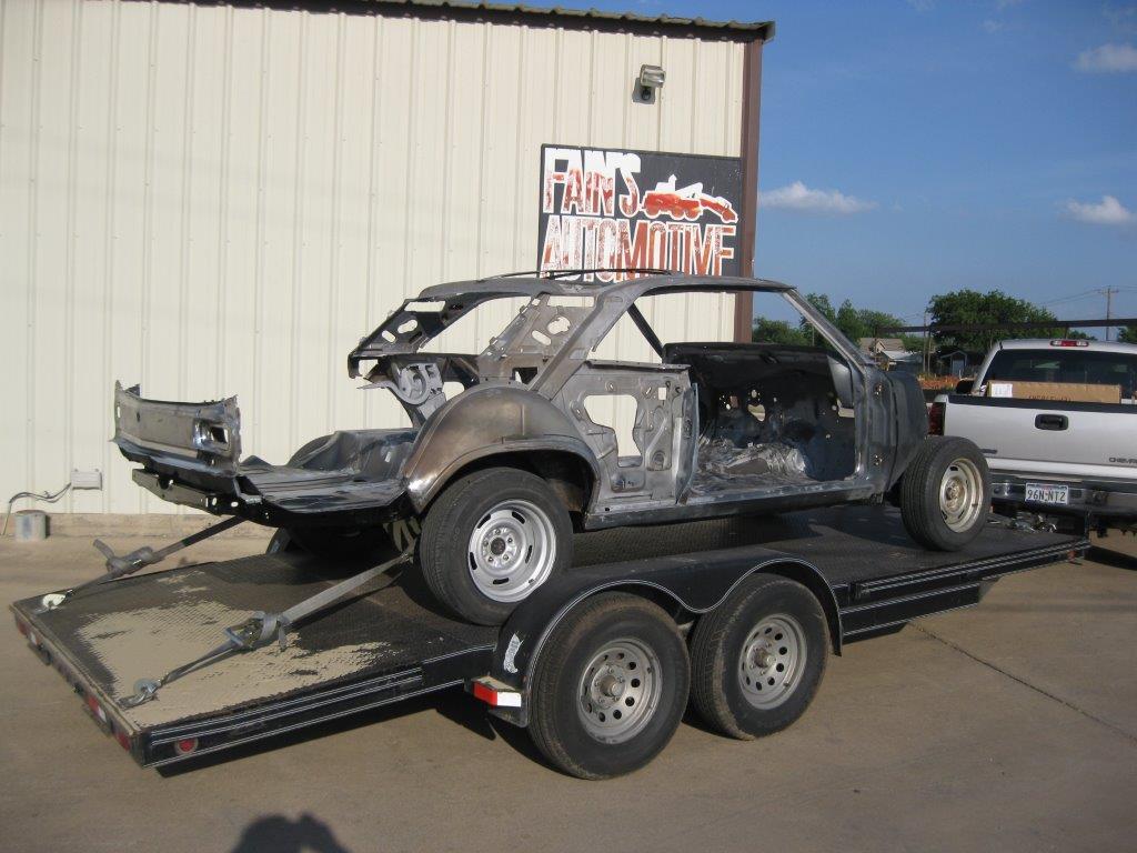

That's not really that bad, as long as that is all of it. I bought my 66 from a body shop owner that had his guys working on it during dead time (for years). It was in primer and looked pretty straight, although I could see evidence of patches on the back sides of panels. By the time I got through removing stuff I didn't like, this is what it looked like. LOL Now it has nice, new, straight AMD panels over a blasted and epoxy painted skeleton. Looks better, but it was a lot of work. Good luck with your project.
Pappy
Attachment 58948
