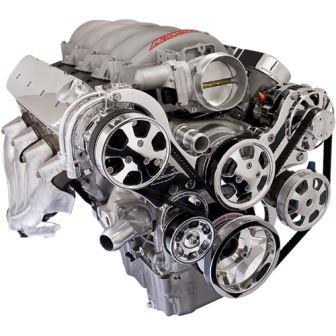

BForgedWheels 12-20-2017 01:17 PM
Billet Specialties Tru-Trac
1 Attachment(s)
Take a look at the Billet Specialties Tru Trac Serpentine System
Attachment 63967
Visit Billet Specialties for more info: http://bit.ly/2vTGP38
