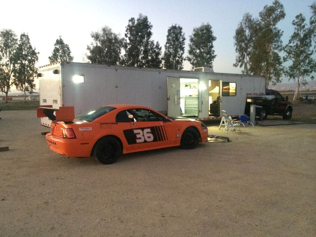

Working backwards from the last track day out.
Here is nothing special but a race car none the less and one I ended up rebuilding.
Out of the trailer

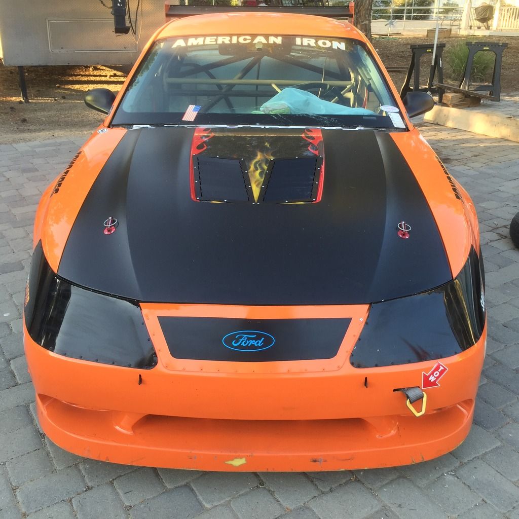

It's a 99-04 Wedge but the platform is pretty much the same, and the formula for a cheap track car is also.
My car has always been a track car. Back in the day it was a Bonduraunt car then it was updated to compete back east in SCCA and then in Texas as an AI car.
I bought it with a worn out motor and the basic suspension set up and then ended up doing a but load of work bringing it up to it's current spec.
It is nothing fancy but it works well as a track mule and is class legal for NASA AI so I can race it in the series.
Any early Mustang can use the same simple formula to be a competent track car.
Bolt on Maximum Motorsports crossmember, lower control arms with camber caster plates on the front. Coilover strut conversion on all four corners. Plain yellow Bilstien HD struts and shocks. Mine has an old Bonduraunt torque arm in the rear but a Maximum Motorsports torque arm would be the choice. and of course a Panhard bar.
The brakes on it now are 13" Stoptechs up front and stock GT brakes out back. Hawk DT70s front and rear but if you didn't have Aero in the rear then runs 60s out back.

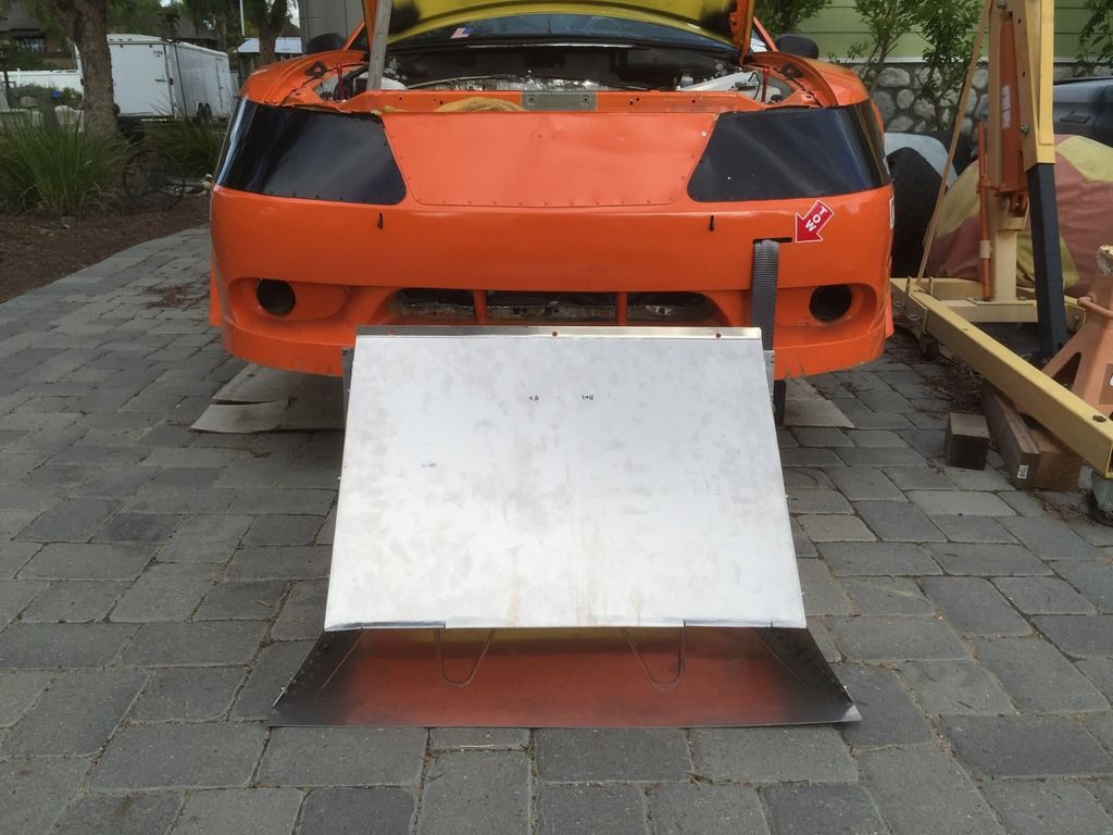

The Aero is some no name wing out back with some big end plates I added, a home made splitter up front with blocked off radiator opening breathing just from the lower opening and some track spec hood vents.
The class limits you to an 18x9.5" wheel and a 275 35 18 Toyo tire so that is what I run. High dollar CL Enkei RA1s on all four corners.
For power in the class you can run any Ford in any Ford or any Chevy in any Chevy ect... Mine is based on a 4.6 2v. I fragged the block and then found a Ford Motorsports boss block with 94mm bores so mine is now a 2v 5.0 mod motor. The class limit is 9.25lb of car per hp (if you have antilock brakes) so my motor is built to get me to a legal 340hp. Heads are ported, headers and intake and better throttle body cams and a tune on the PCM.
I would buy one with a Windsor based motor if I did it again. Cheaper and lighter.
The transmission is a stock T45 with a Findanzia AL flywheel and a Excedy puck style clutch. Out back I have a 3.50 torsion diff 8.8. I wish it was a 3.70 but that's what it had.
The car weighs about 3300lbs with me in it.
You saw it run at Sonoma. I had never been on that track before but the car works well enough to run some decent lap times. It is pretty fun to wrestle around a track.
I would say it is a great platform to get you out on track. It works well enough yet it isn't perfect so it makes you drive and it has a pretty good fun factor for the $$.

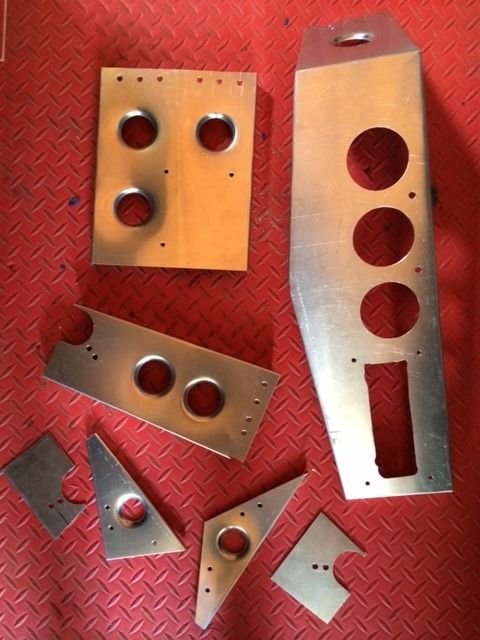

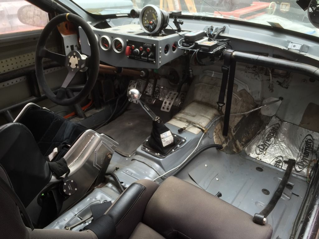

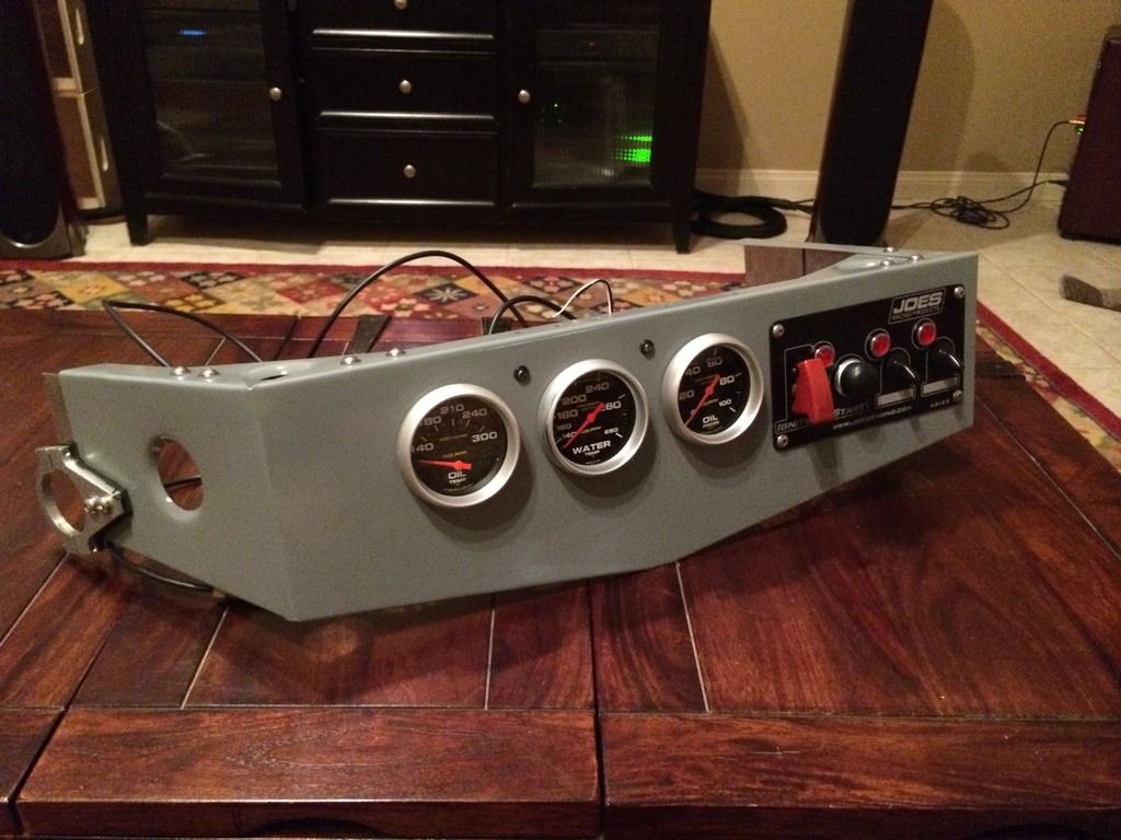

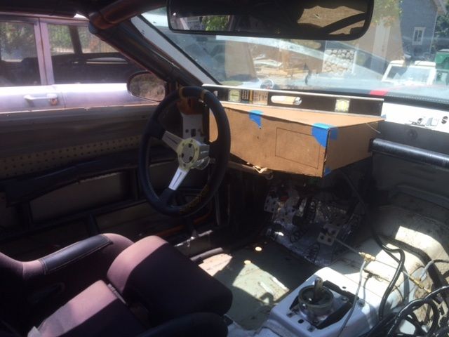

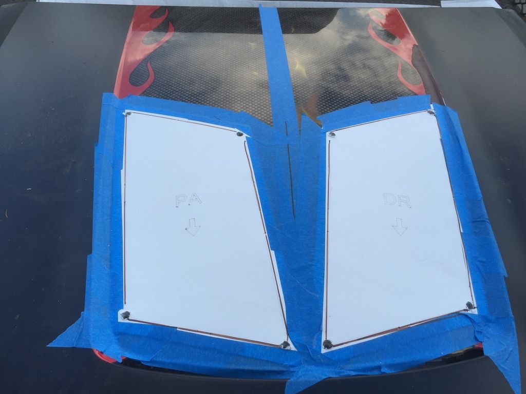

When I got the car there were a lot of things that needed attention. One was the butchered stock dash rattling around while on the track.
It was dubbed the 200hr dash by someone on this site. It didn't take that long but it did take me longer than it should have.
Some cardboard to mock it up.
http://i291.photobucket.com/albums/l...pskmyhptjq.jpg
Some work on the sheer and brake
http://i291.photobucket.com/albums/l...psdhvmawhb.jpg
A little paint and Bingo
http://i291.photobucket.com/albums/l...psnyfgr6sl.jpg
Of course Weld reminded me today I didn't need to build this for the car to be trackable.
http://i291.photobucket.com/albums/l...psznafk9uq.jpg
DBasher 12-18-2016 11:02 PM
Dash looks good, Rob.
You mention some class rules and if it were just a track car you'd run a 10.5" wheel all around. Are you racing door to door in AI or some other class?
:cheers:

Then you have to get to the track and back. For me that is a Diesel pulling a 40ft gooseneck with a sleeper section (I probably should post some info on that at some point) up front at 8mpg. So for a 100 mile trip to the track add another $60-75.
http://i291.photobucket.com/albums/l...ps66zostqc.jpg
So a weekend away staying in my trailer is about $1k give or take.

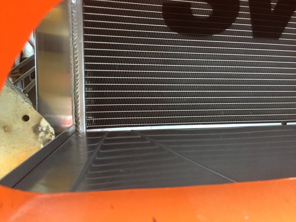

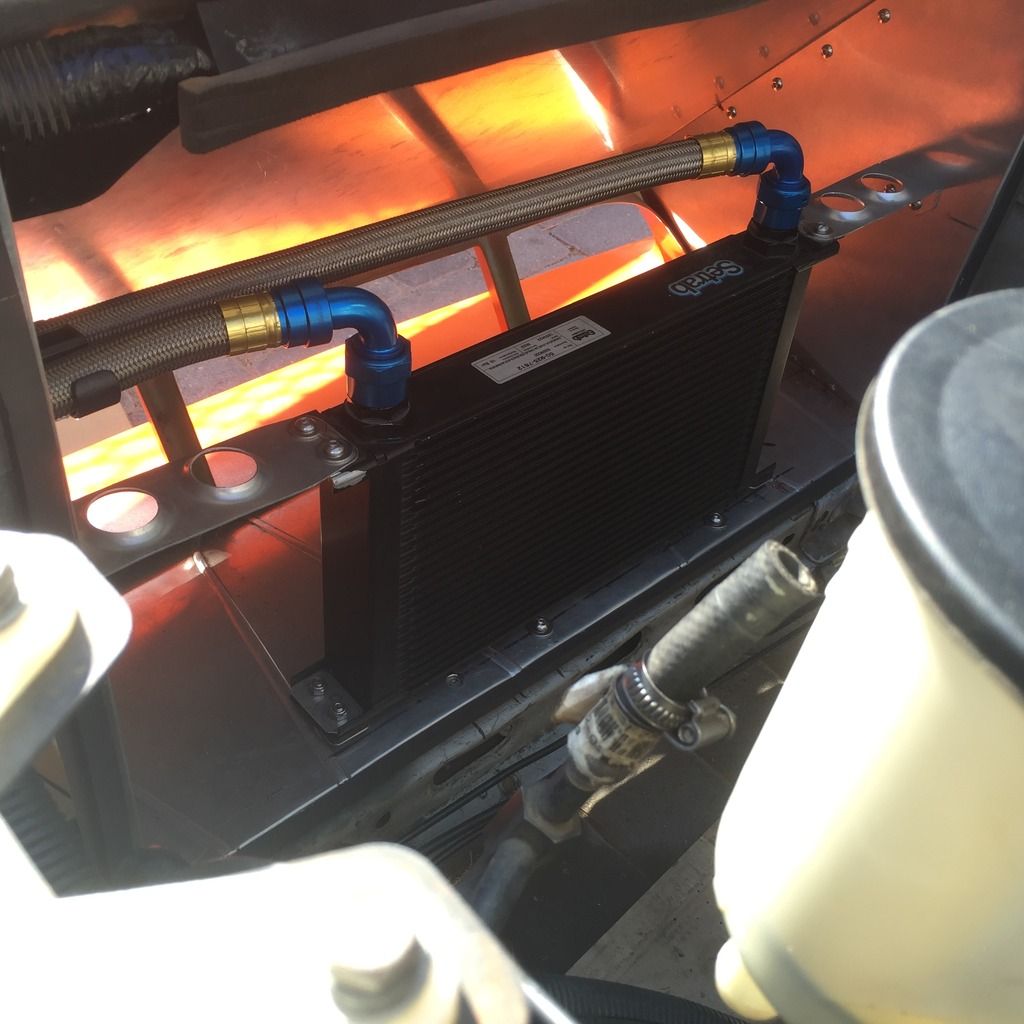

Also remember that you can't leave anything alone. Maybe you can but I can't. If the car runs a little hot then you have to cut to cure.
http://i291.photobucket.com/albums/l...psnftj86am.jpg
http://i291.photobucket.com/albums/l...psjca7jtxp.jpg
Track Spec make a great product and my engine temps really dropped when I added these and my radiator duct project.

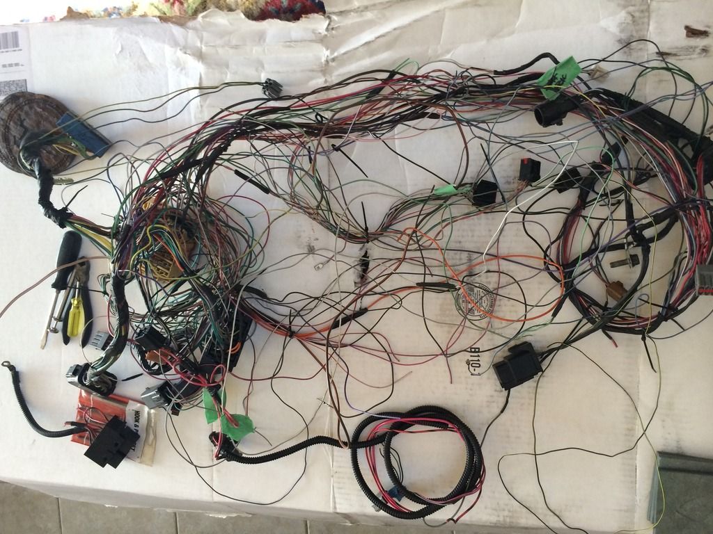

These threads are soo much easier when you already know the ending.:relax:

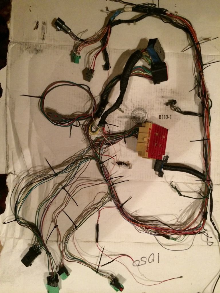

In these later model cars there is so much wiring. You may get the idea to un-loom the wiring harness of your race car and eliminate all the unneeded wires. Windows, radio, door locks, signals, anti theft system, GEM box that makes the door ding sounds and alarms.
On one hand I don't recommend it. :bang:
http://i291.photobucket.com/albums/l...psicmlqog9.jpg
http://i291.photobucket.com/albums/l...ps2upxoutq.jpg
On the other hand it did eliminate over 26 lbs of extra crap that I didn't need and I now know what wire goes to what in the car:cheers:

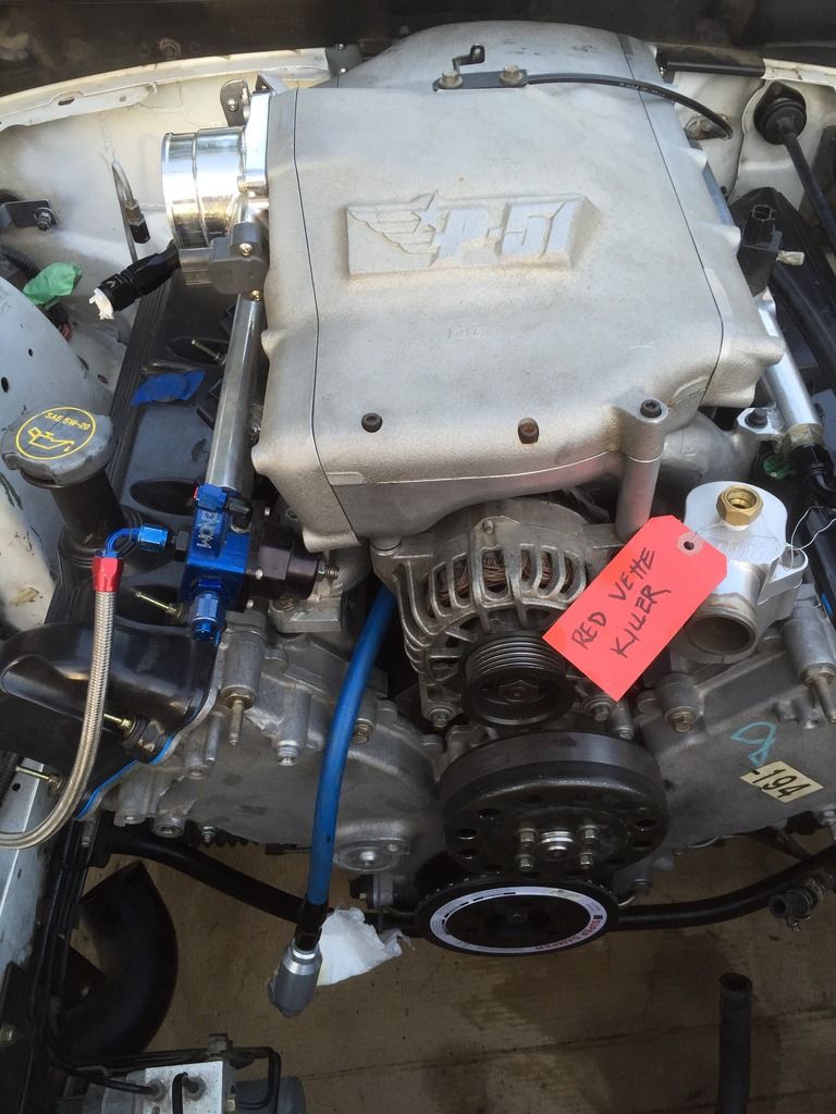

When I bought the car it was cheap. It was cheap because the motor was advertised as tired. It turned out to be even more tired than expected. It lasted a day at Streets of Willow and an evening session at Adams.
That led to a complete rebuild that then blew up after a day at Streets of Willow a trip to Buttonwillow and then back to Streets of Willow to last all of 5 laps.
I had the engine built and the builder stood behind the build even though it was probably the tune and a marginal cooling system that killed it.

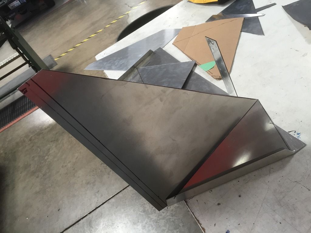

So as I pulled the motor out for round three I took a few other precautions.
One of those projects was better cooling.
I bought a new radiator with a larger core.
I bought a big Setrab Oil cooler.
Johns at Tracspec hooked me up with some hood vents.
I built a sealed radiator duct from the grille to the radiator.

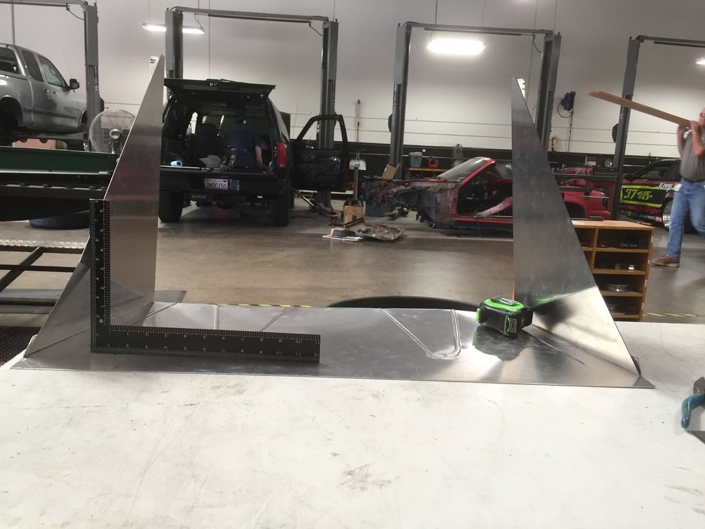

Start with the basics.
http://i291.photobucket.com/albums/l...psjfdiiocq.jpg
Some mock up.
http://i291.photobucket.com/albums/l...psaoqhgvyc.jpg

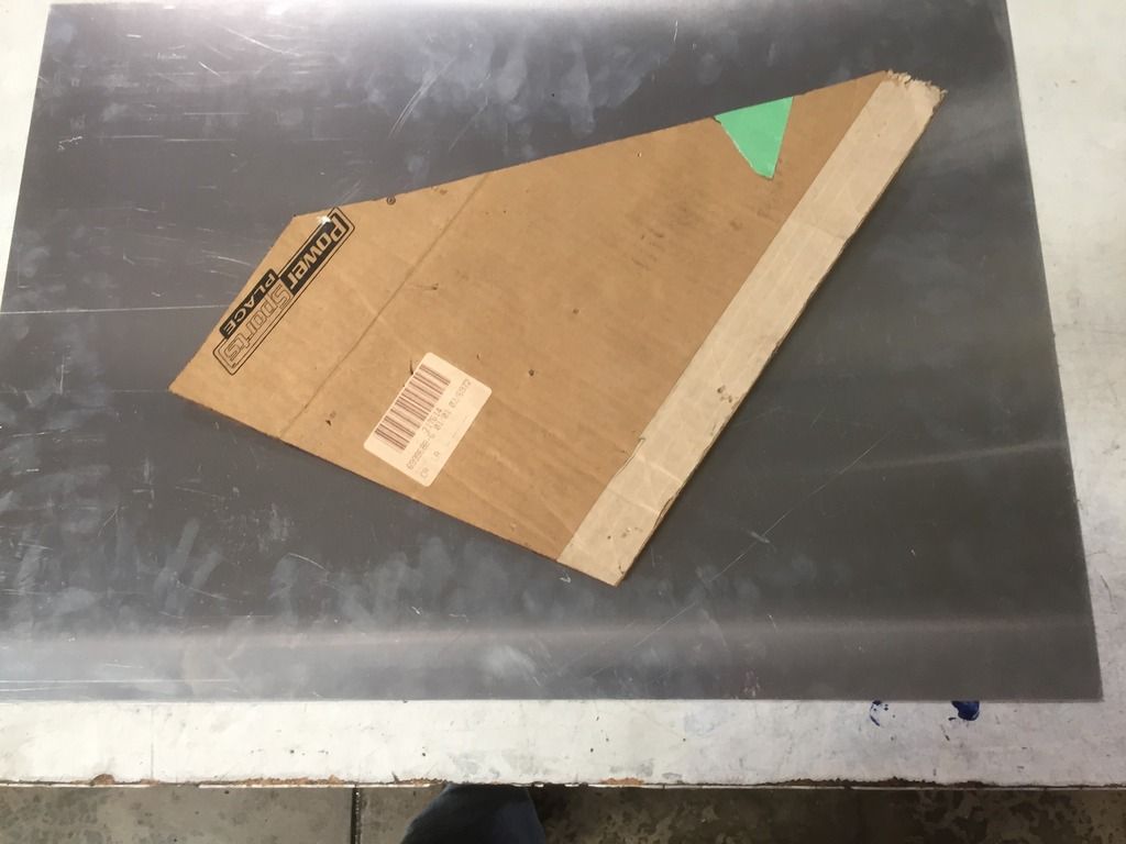

A couple weekends with a shear, brake and bead roller.
http://i291.photobucket.com/albums/l...psxqi4vwnb.jpg
http://i291.photobucket.com/albums/l...ps04hizxag.jpg
http://i291.photobucket.com/albums/l...psxhacbjf0.jpg
http://i291.photobucket.com/albums/l...psfhzevwnf.jpg
http://i291.photobucket.com/albums/l...psyzygup5t.jpg
That solves the problem of getting air in.

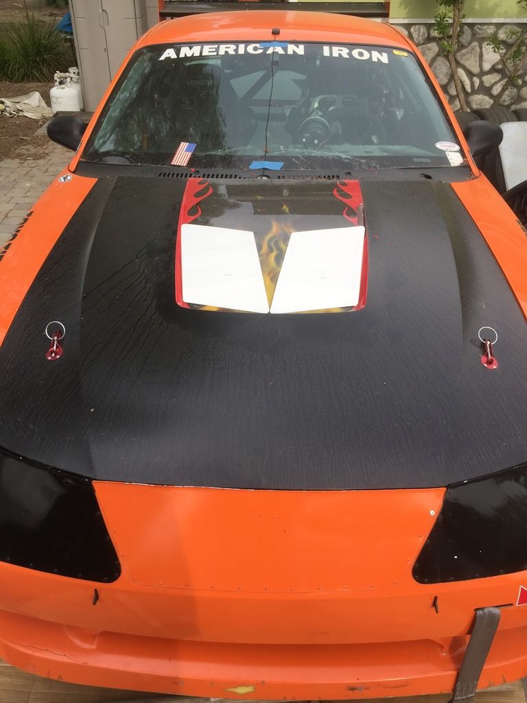

FETorino 01-15-2017 06:23 PM

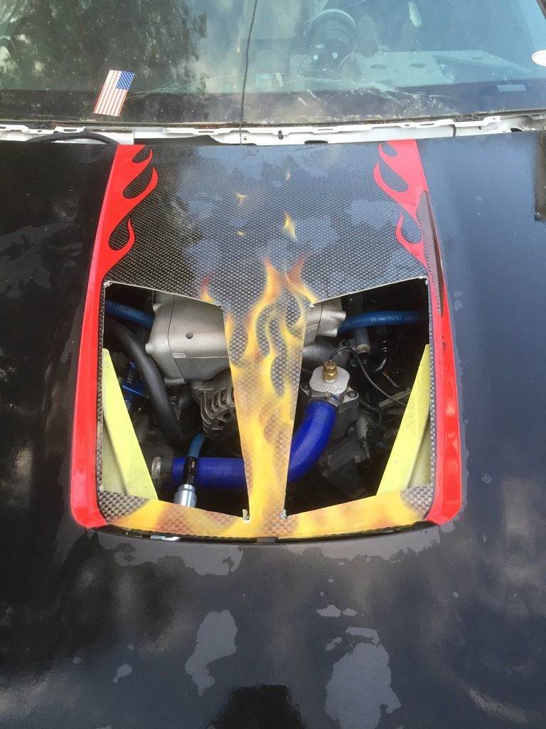

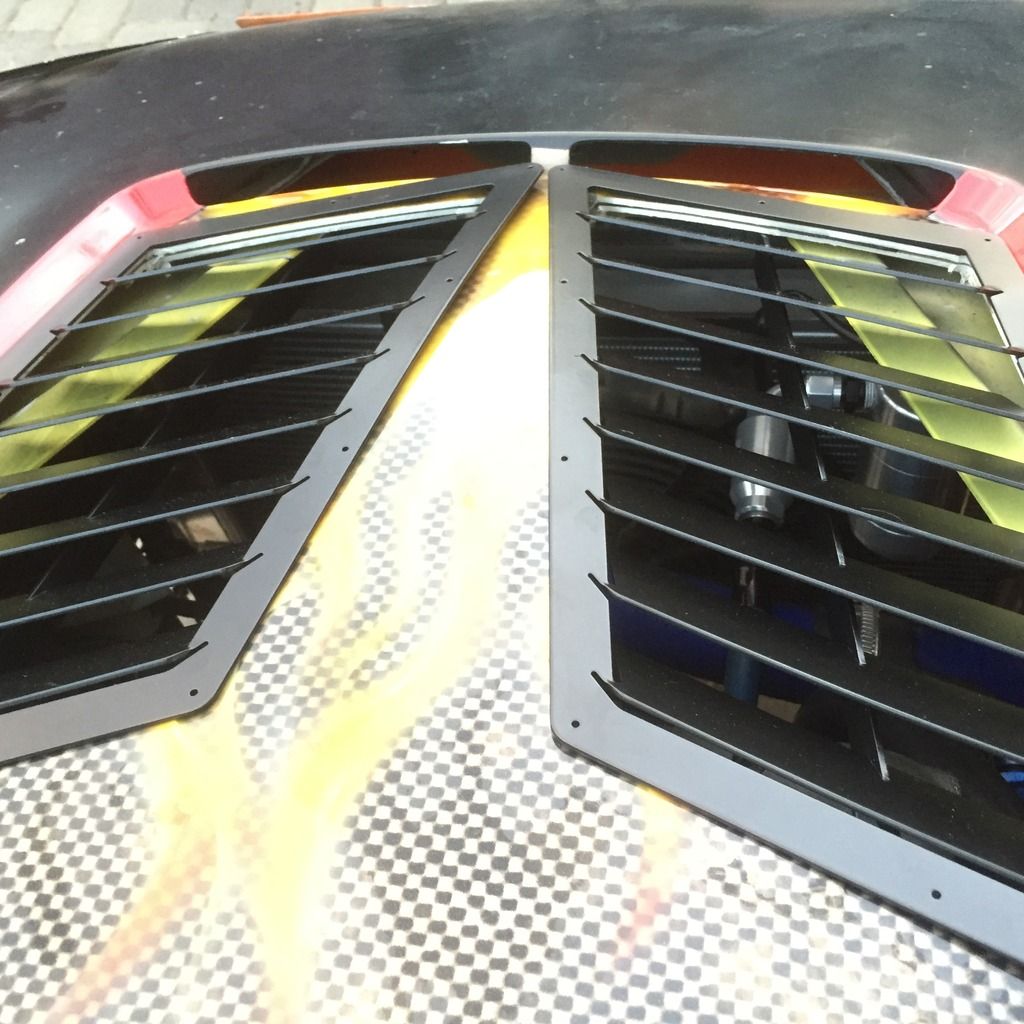

there is grip to be had with some aero. There is nothing sophisticated about the aero on AO bit it does have a splitter and a wing that I added some substantial end plates to.
When building the duct for the radiator I wanted to reduce the pressure behind the radiato to get the maximum airflow and cooling.
I also wanted to get the air coming in the grille out from under the hood to reduce front end lift and enhance what front downforce I have.
John at Trackspec helped me with some patterns to check fit of his vents. Like Weld most people vote for the Vette so there are vents for C5s & C6s but none for a lowly New Edge 2000 Mustang.
John had a set I felt would work well.
http://i291.photobucket.com/albums/l...ps6axtzvhi.jpg
Cut to cure is what they say.
http://i291.photobucket.com/albums/l...psodjpfxzs.jpg
The test fit before final triming confirmed they gave the radiator airflow a good exit path.
http://i291.photobucket.com/albums/l...pskfxeqhmj.jpg
On track the operating temps were way down and the car seems to have better front end bite.
At least enough to duck under any Orange 69 Camaros I need to pass at Buttonwillow.
